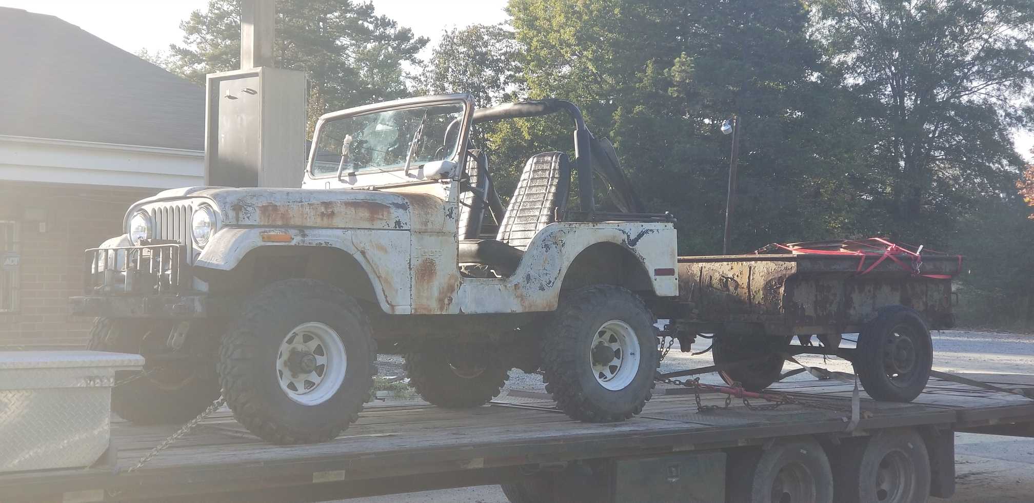

I've recently acquired a stock '74 CJ5 project jeep, and have the opportunity to pick up a stock '77 CJ5 for parts. The '74 will be kept relatively stock for farm use as well as the occasional trip to town.
