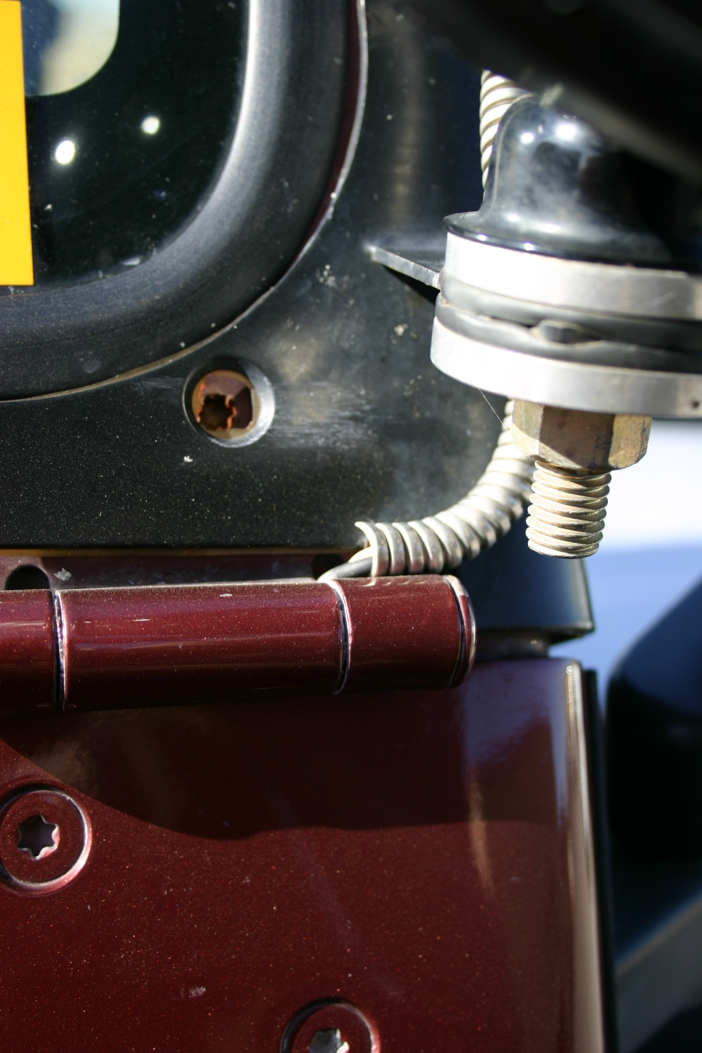

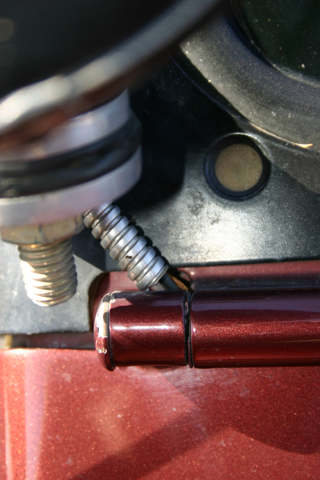

No need to drill! I did a good write up on the ones I mounted, but it's long gone. However, I have some pictures of the finished product if you want. You can flip your windshield down and snake the wires into the cowl from there. I think the only drilling I did was on the inside of the cowl into the engine compartment.
