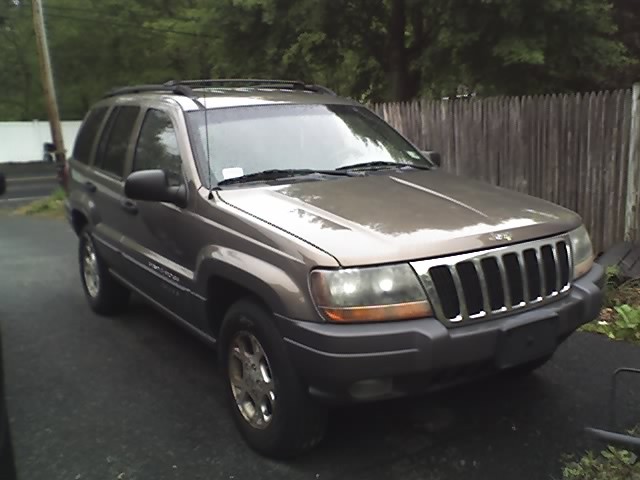

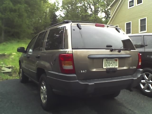

I have some pics she sent me, I'll post em up. I have not even seen it yet, but the price was right.
pics
70K miles, decently optioned, 3 grand... I think it is a good deal. probably another $400 in work to get it perfect; change all fluids(engine, transmission, tcase, diffs), filters (same except the diffs), coolant flush, plugs, wires other random sensors... I have a catalytic converter I took off my YJ, less than 2000 miles on it, so I toss it on this and then probably throw a cat back system at it. Drive it for a little to see if it is a keeper of a flipper then a spacer lift, some 31's, either the rims that are on it or the 17" chrome 5 stars that came on the 02-04 wj's... they look like American Racing torqu thrust rims..

On a 198 RBI(Iron) there's these options from the factory ,3.07, 3.31, 3.55, 3.73, 4.11. On the 226 RBA(aluminum) are 3.55, 3.73 . Is the tag gone from the cover?. BTW, that's a nice looking GC. If i bump in to one of the guys i know here who has a lift on his WJ, i'll take pics of his mods on the suspension.
thanks! The person selling flaked out on me, I was supposed to get it sunday, but she had her nieces sweet 16 party the day before and wasn't in the mood ??? then I left for a business trip sunday night, so I have to go get it on friday. not sure on the rear, I'll check once I see it.
