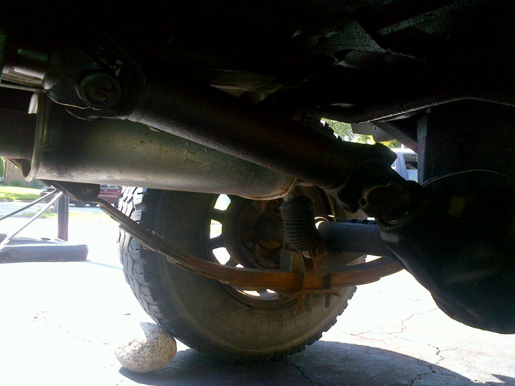

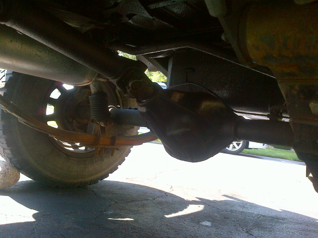

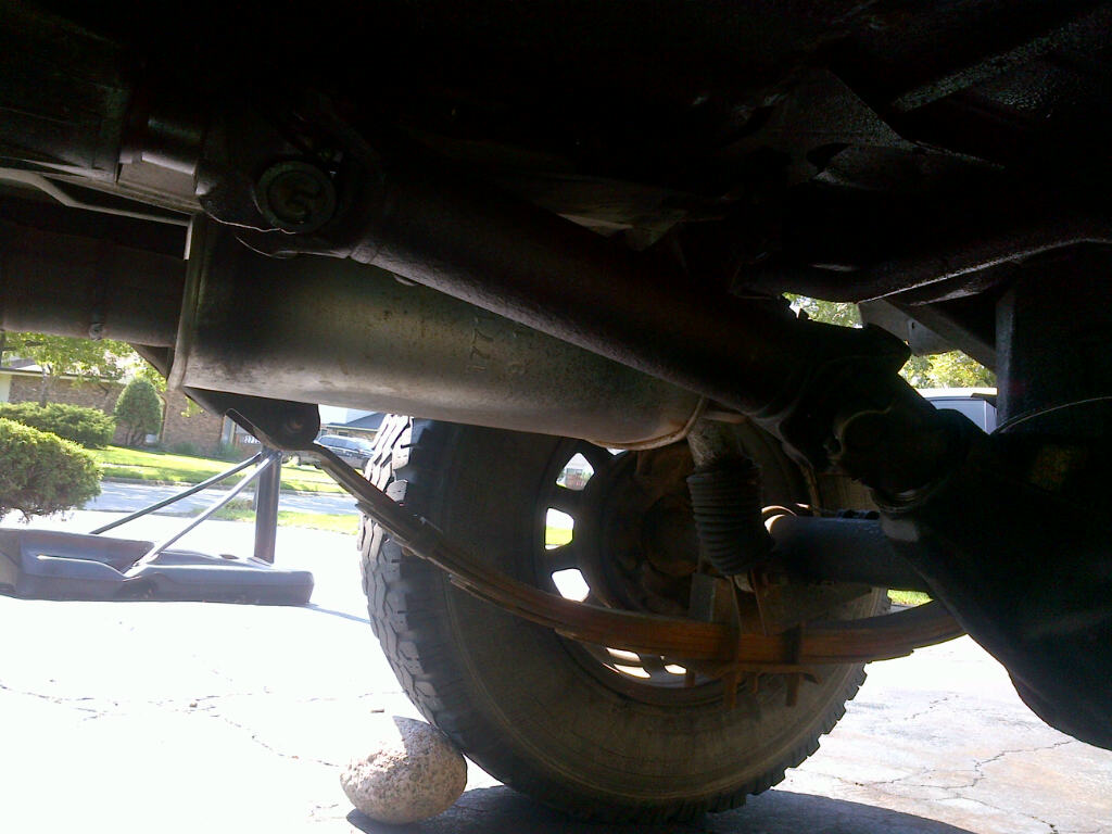

I was looking at it this morning and it seemed that the rear end turned. I don't know how that could have happened but the drive shaft look out of angle and the u joint from the transfer case seems to be sticking out way too far out. How this happened going 60 miles on the high way and not hitting any kind of pot hole I don't know. And what the big bang was I'm not sure either but it caused the jeep to turn off automatically and after that I couldn't get any gear to work. The jeep would just rev up and as i let of the clutch it would shut off. I head back to school later today and sadly I will be going without a jeep so this might take a while to fix seeing as I won't be around a lot to fix it and depending on the damage also.

here are some pics

OK not what I thought it was may actually be an easier fix. Looks like your U bolt on the passenger side broke. I can't zoom into the pic so can you confirm it? With the axle tilted like that it looks to have pulled the front yoke out of the T-case. Let me know when you can
Looks like your axle rolled of the spring perches. Are those wedges between the spring and axle?
what seemed to happen was that the axle did roll from the wedges. the u bolts must not have been tight enough or the weld might have broken. How do we fix this?

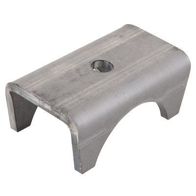

When you installed the lift blocks under the rear axle, did you have to weld them in place? I've never done that type of lift before, and can't really tell you what's right, but I can't see anything broken in the photos, only the fact that the rear axle has rolled backwards. Are the spring perches still on the axle, or did they break off? The spring perch should be welded to the axle, and looks like this:
To get started putting it right, I'd jackup the Jeep supporting it by the frame (you'll need tall jack / jackstands), then with the wheels off the ground, try to roll the axle into place. Most likely either the spring perch or ubolts are broken. Upload some more photos of where your springs meet the axle (can't really see the perches from the angle of the other photos).
The good news is that you may not have really broken anything major.
thats there but there are blocks that were put on there to correct the angle of the shaft i believe a while back. the blocks broke and caused the axle to shift
