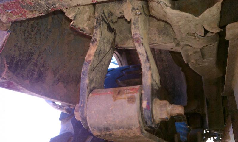

Will the dakota springs give me enough clearance to fit my 33s... Do I just cut the eyelet off the dakota springs and stack them on my main spring and discard all my old ones... I have lift shackles but not sure what size...thanx for the replies
Thats what i did im at 5.5 inches total with my shims etc. I used from a 98 dakota the later model the better it will ride.
