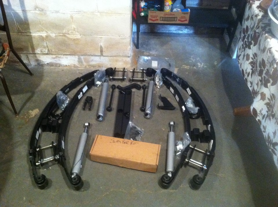

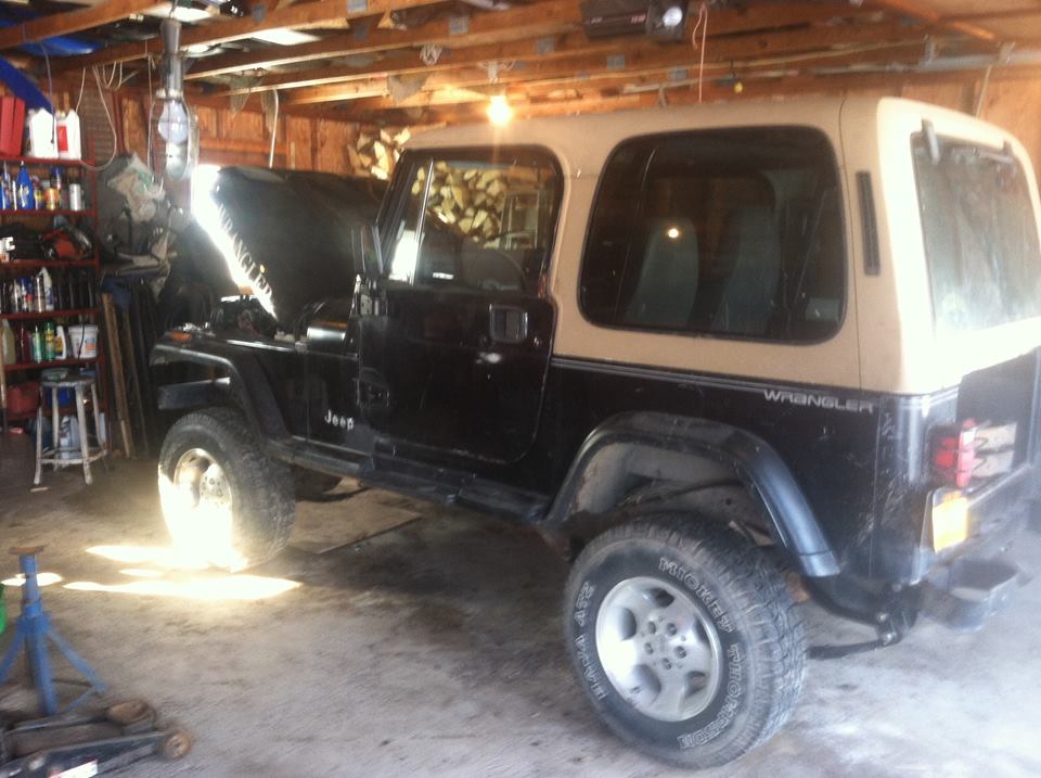

Here's the lift laid out and a before pic for reference. Surprised it worked!

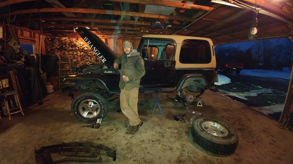

This Is about how high she's going to sit. The back will be an inch or two lower than where it is now!Full weight on the front!

This is all done! Other than fixing the bolts and doing brake lines, I'm quite happy!!!!
