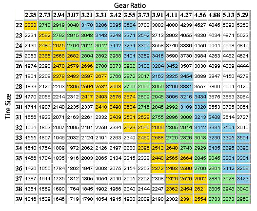

Hope this helps...
Yellow - highway driving, good fuel economy
Green - Daily driver, best overall performance
Blue - Most power and towing, reduced fuel economy.

How does one figure out the gear ratio? I have none of the original paperwork, or owners manual (as if that would do much good).
Very helpful chart iraq vet
There should be a tag bolted to the diff cover on both the front and rear that has the gear ratio stamped into it. If it's not there you can put the jeep on jacks and rotate the tire, counting how many turns the driveshaft makes for one revolution of the tire.

If you have a 4-banger, you are want to look into the last blue number for the correct gear... I have 4.88 and 33's on my 2.5L, and I am kind of wishing I could go to 5.13 or something, but that means 2 new axles (plus lockers!), so it's out of th plan for some time!
I would stick in the blue range on that chart regardless of engine type. It helps to go a little lower than recommended as the chart only takes into account the added tire size and not the weight, it robs more power to get the heavier tires moving.
I would look up the rpm for the stock axle ratio and tire size, then go down to the tire size you would like to run. Move to the right until you find a similar rpm, then move a box or two more to the right for best performance.
