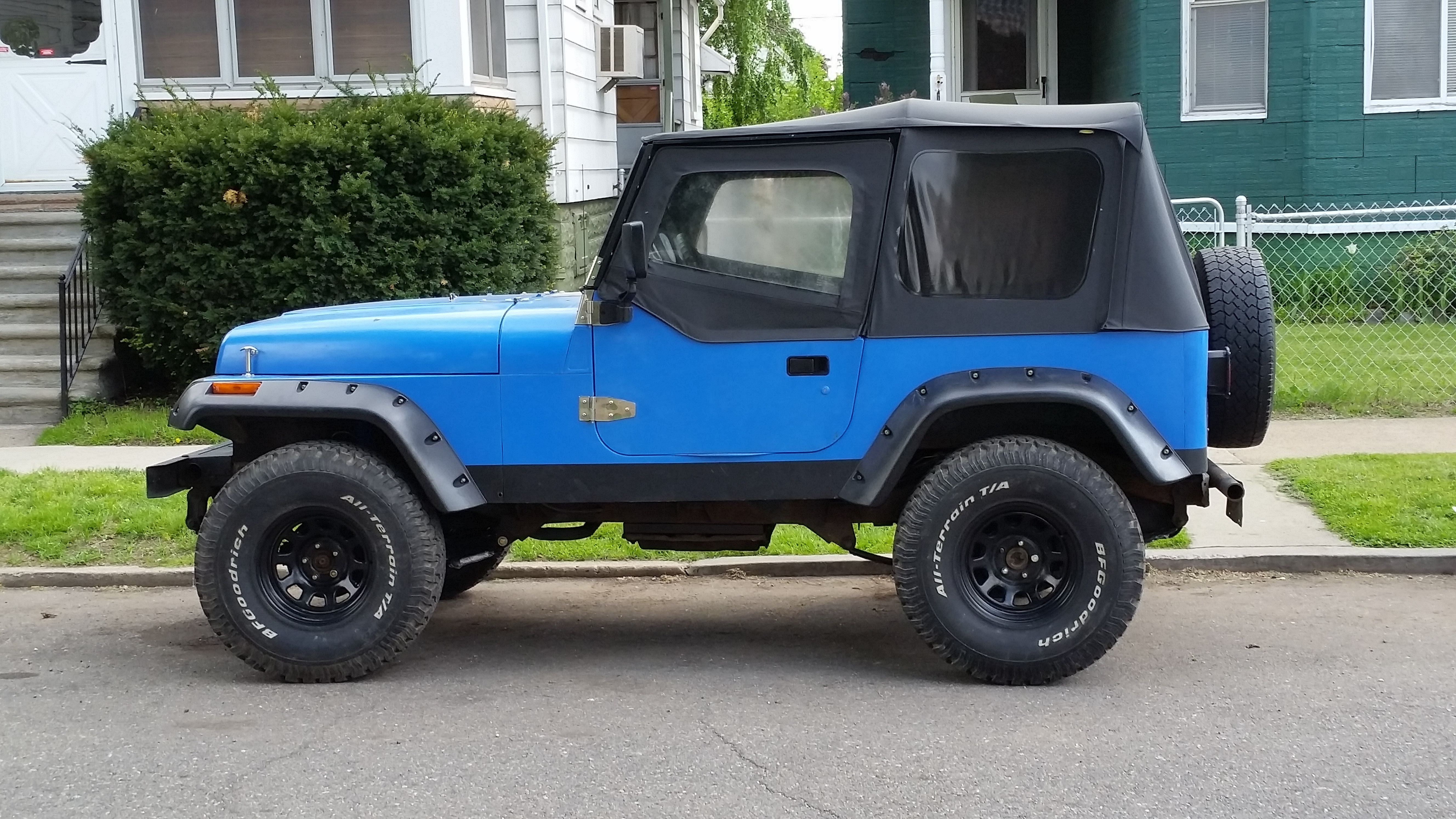

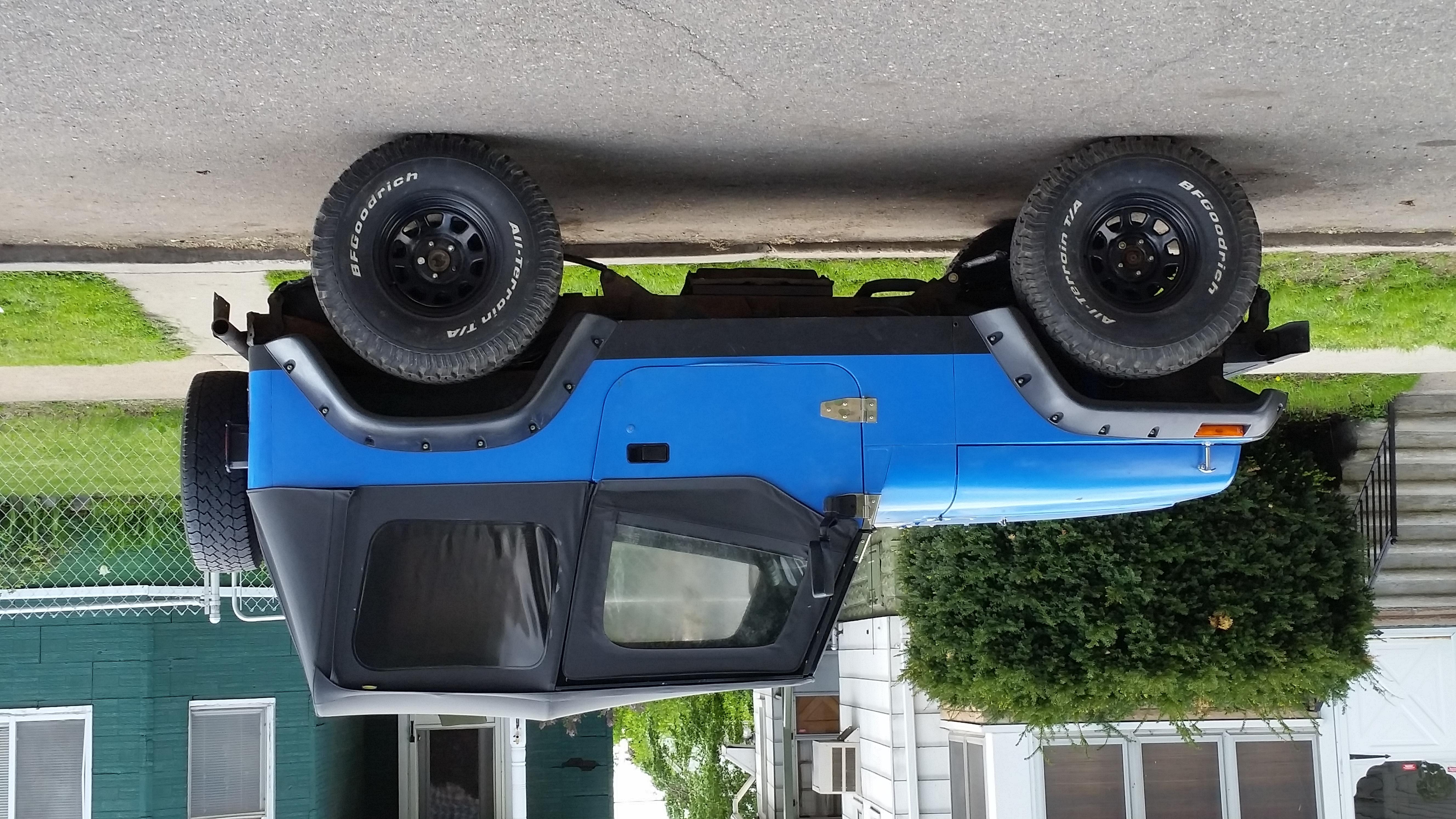

Just for your information, eventually, the front relocation bracket is prone to coming loose, so check it after a few thousand miles. In my YJ, I left the rear track bar off, and got me a JKS telescoping track bar for the front. This one you can disconnect when you go wheeling to allow for more suspension travel. I don't think it is as stiff as the stocker, but to be honest, I have driven quite far on it and don't have any issues...
By the way, judging from the first picture, you jeep either has a ton (or more like 4 tons) of grip, or it generates a LOT of downforce! :p
