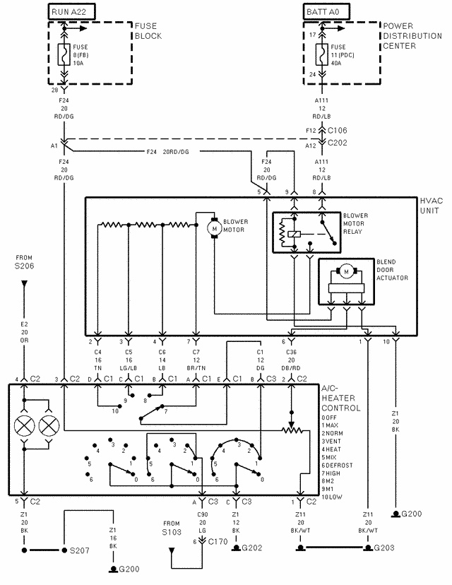

- 1st fuse #1 a 40amp in PDC, OR unplug blower motor.
Jeep blowers are somewhat different they are HOT and the path to ground is thru the (resistor) creating the various speeds..
Likely the blower motor BK/TN wire is grounded OR depending on speed the L M1 M2 H speed is grounded.
diagram should help
  • 04WJ MTC blower.pdf

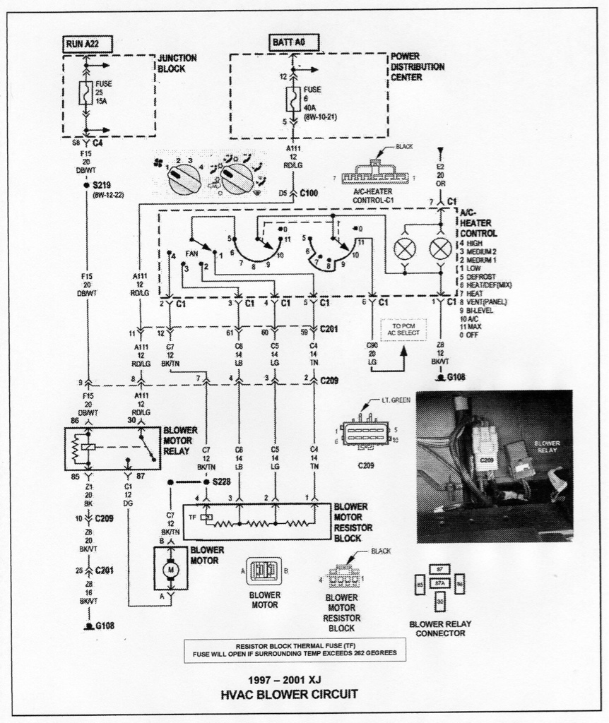

More realistic diagram
