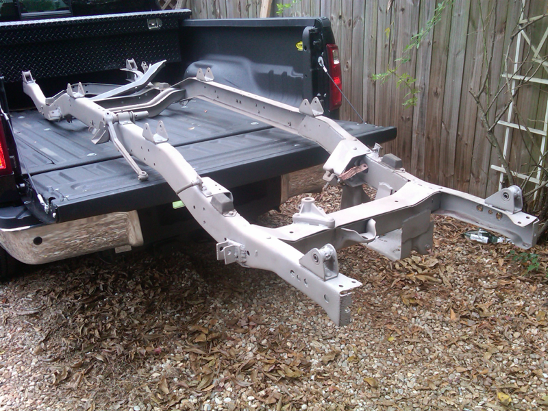

Sounds good John. Thanks for all the tips you've provided thus far. It's my first total restoration so there will be some things I am clueless on. My frame is loaded into my truck and will be dropped off for sand blasting tomorrow. I've got POR-15 waiting in the garage.

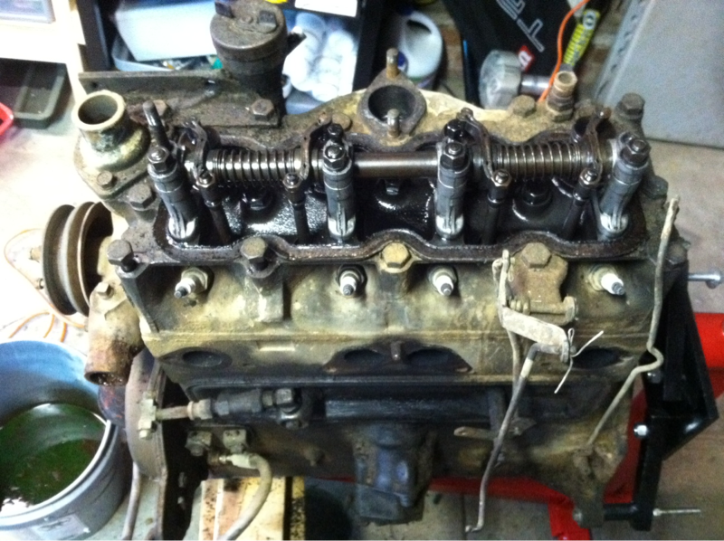

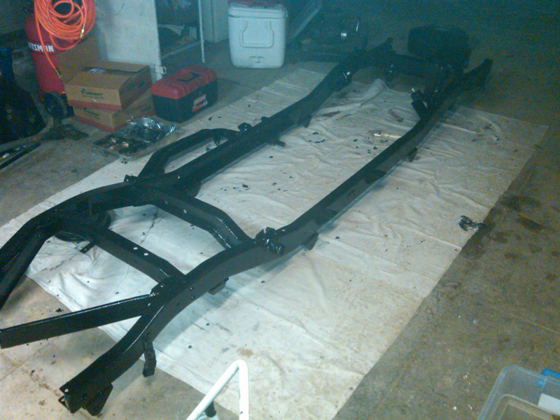

After two weeks at the sand blast shop, I finally got the frame back. It looks really good! I applied two coats of POR-15 (pictures to follow). Once all the rust was removed I uncovered the original serial number from the frame (101295). This tells me the frame is from 1955 if it's a true CJ5 frame. It can be from another early CJ from another year but I don't know how to verify its a true CJ5 frame. I also uncovered the engine serial number while disassembling the engine. It is 800885. That number is a 1958 CJ5. Any ideas on why there is a difference in serial numbers? I've been trying to figure out this jeeps true birth year for over a year.

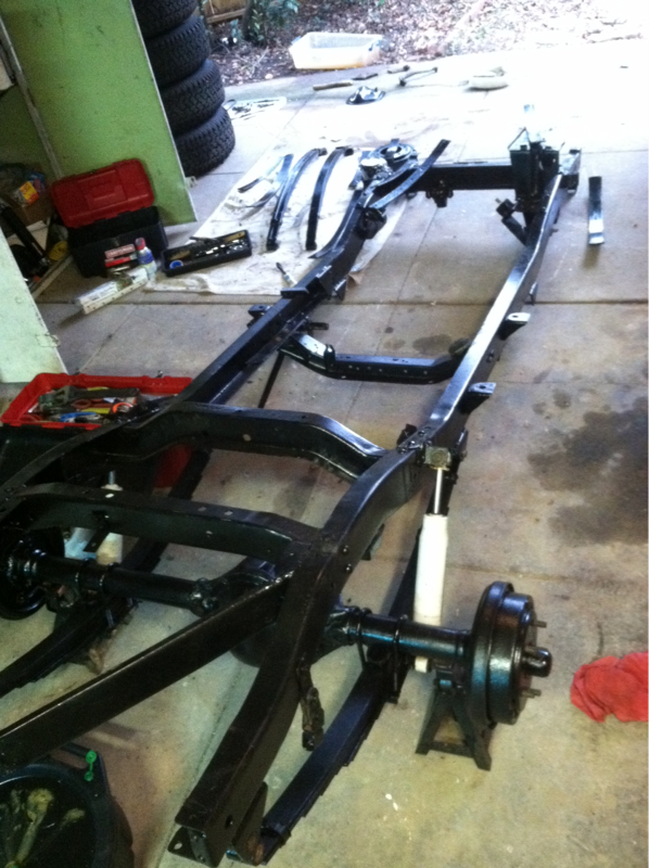

Here is my frame after two coats of POR-15 and two coats of POR-15's Chassis coat black top coat. I am now working on disassembling the Dana 44 rear so I can paint it with the same stuff and replace all the old gaskets and seals.

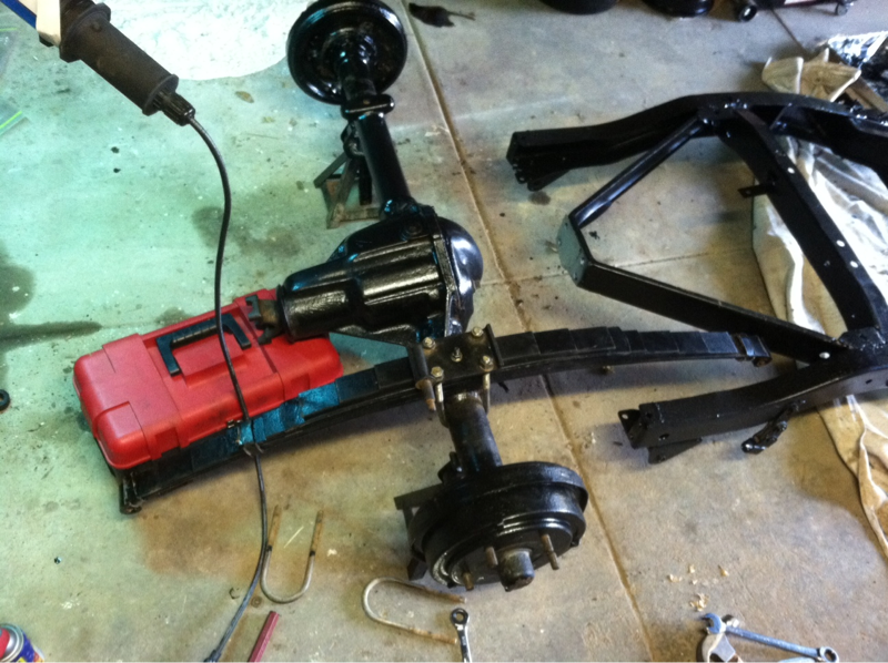

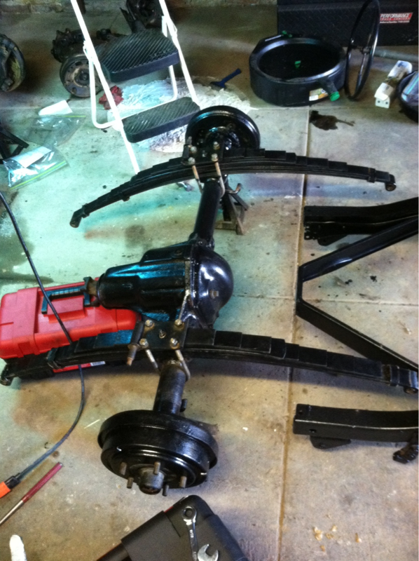

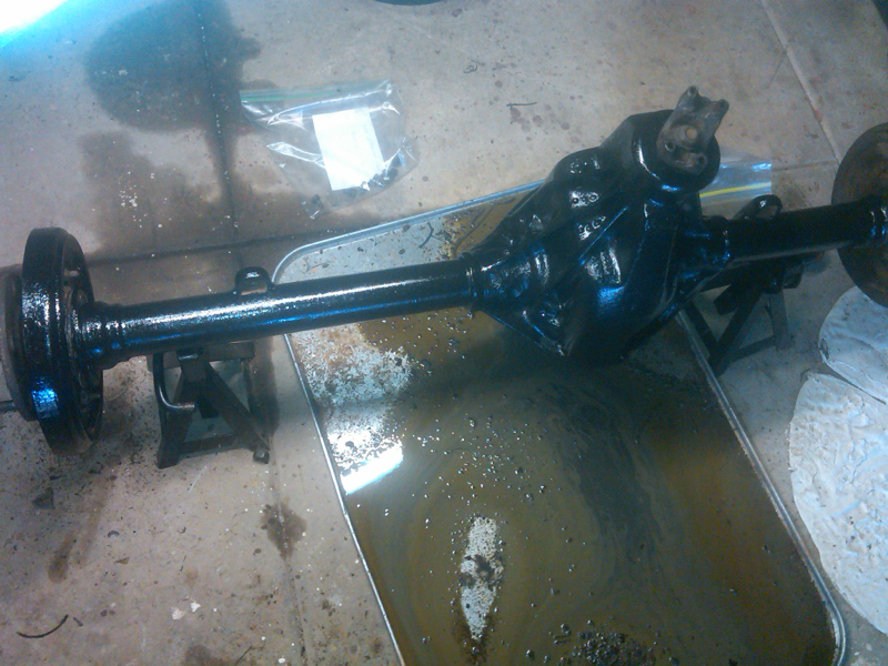

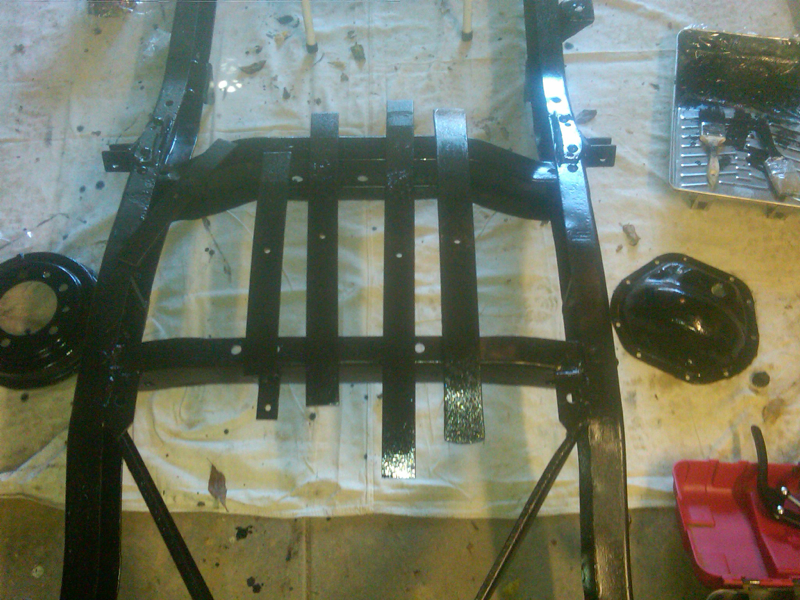

I began disassembling the leaf springs and cleaning them. Once cleaned, I applied the base coat of POR-15. So far I got one set painted. It looks pretty good. Also I applied the base coat onto the Dana 44.

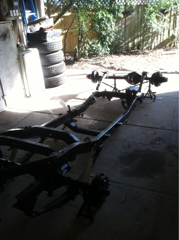

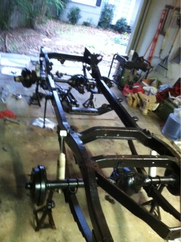

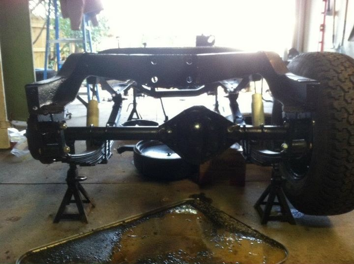

I finished the rear suspension and attached it to the frame and Dana 44. Unfortunately I ordered the wrong shackle so I will install them once the appropriate part arrives. I also began cleaning and disassembling the hurricane 4 for paint and rebuild. The front end is painted and I will install it this week.

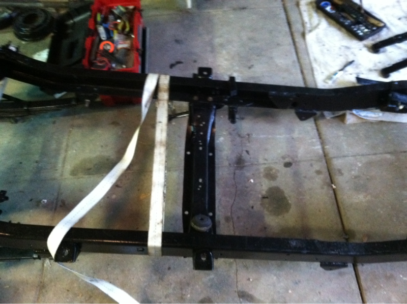

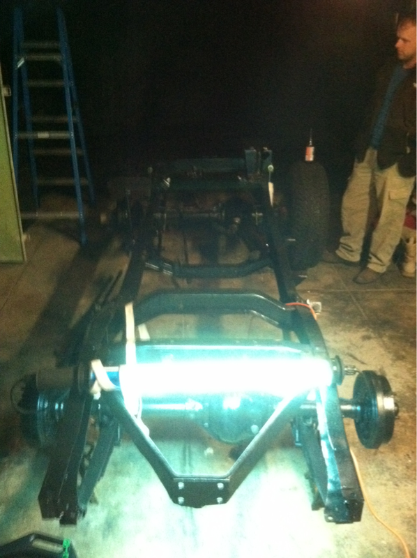

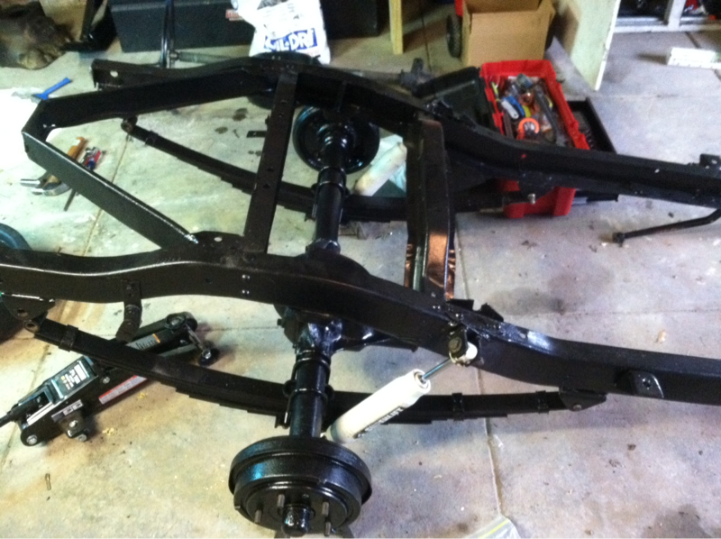

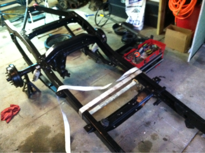

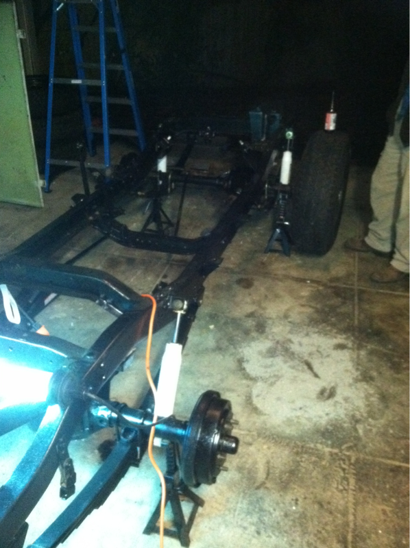

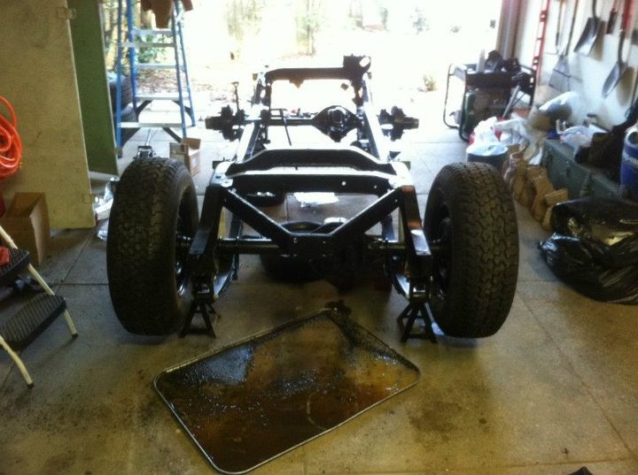

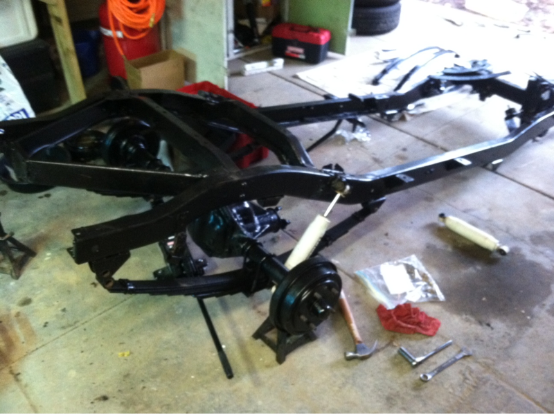

I installed the rear shocks today and am very happy with the outcome thus far. I also installed the transmission support crossmember. Unfortunately the crossmember has been off the frame for so long that the frame widened slightly and therefore the holes for the screws no longer lined up right. I used a 5000 lb ratchet strap to pull the frame back together while I put the bolts in. It worked out surprisingly well. I reassembled the front leaf springs after paint and will attach them to the front axle tomorrow.

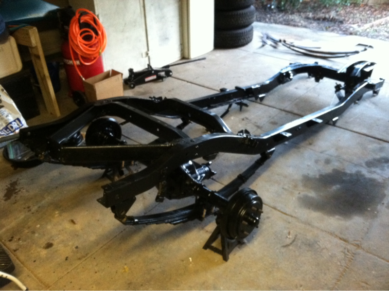

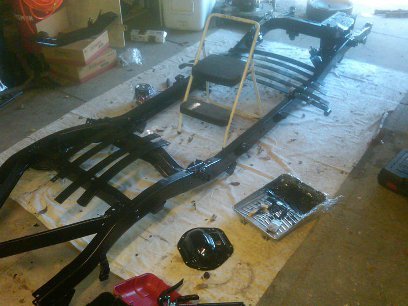

I got the Dana 25 front end assembled with the leaf springs. Painted I t with POr-15 and installed a diff gasket. Neither diff ever had a gasket. Could explain my mystery front diff leak I always had. Anyway, going on vacation today so I will attach the front end to the frame when I return. Next up is brake lines.

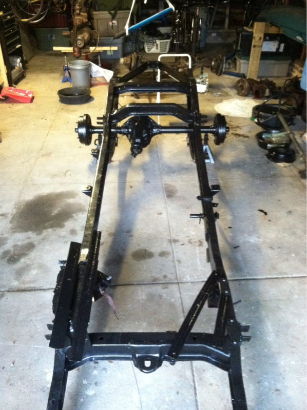

Chassis complete!

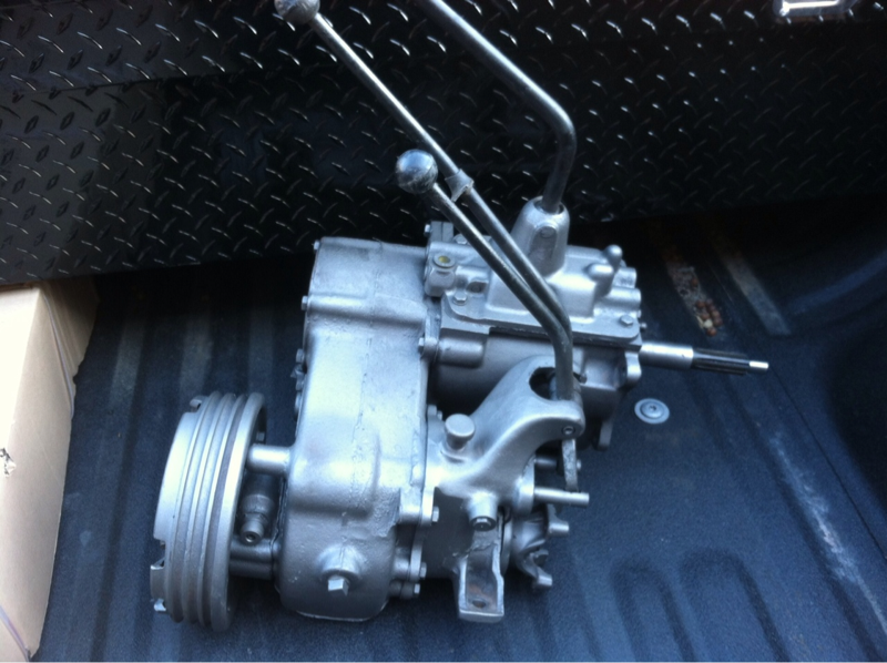

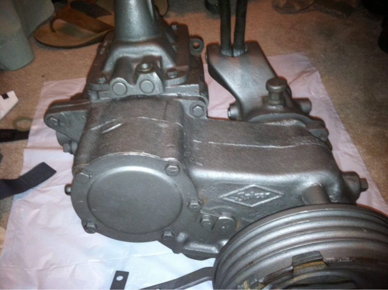

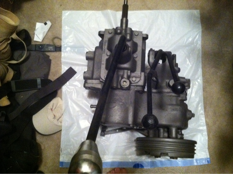

Transmission an d transfer case rebuild complete. I had it done by Georgia Precision Gear in Marietta Georgia. They do very nice work and are reasonably priced. More pictures to follow.

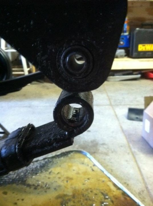

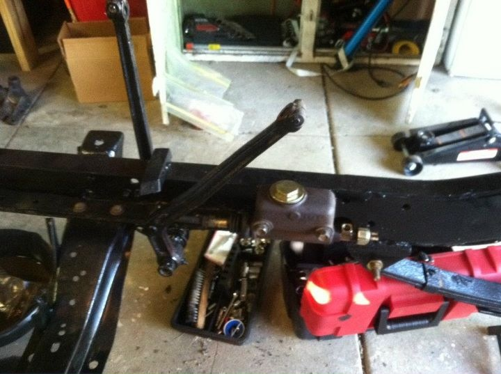

Also, I installed the brake and clutch pedal arms and brake master cylinder. I am in the process of installing the brake lines. Finally got the rear shackles installed. The original metal/rubber fittings in the leaf springs and the mounting brackets were rotted in place, so I had to drill them out in order to install the new shackles. It was about 2 hours of drilling, mostly because my bit dulled after the first hole.

Additional pictures of the T-90.
