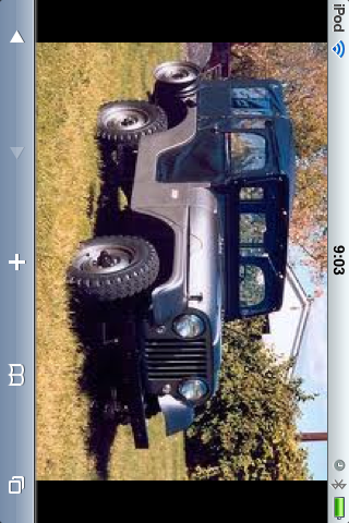

1. Perhaps this was for a deep water fording kit (as we called 'em in the Marines) although the snorkel was on the Driver's side see photo;

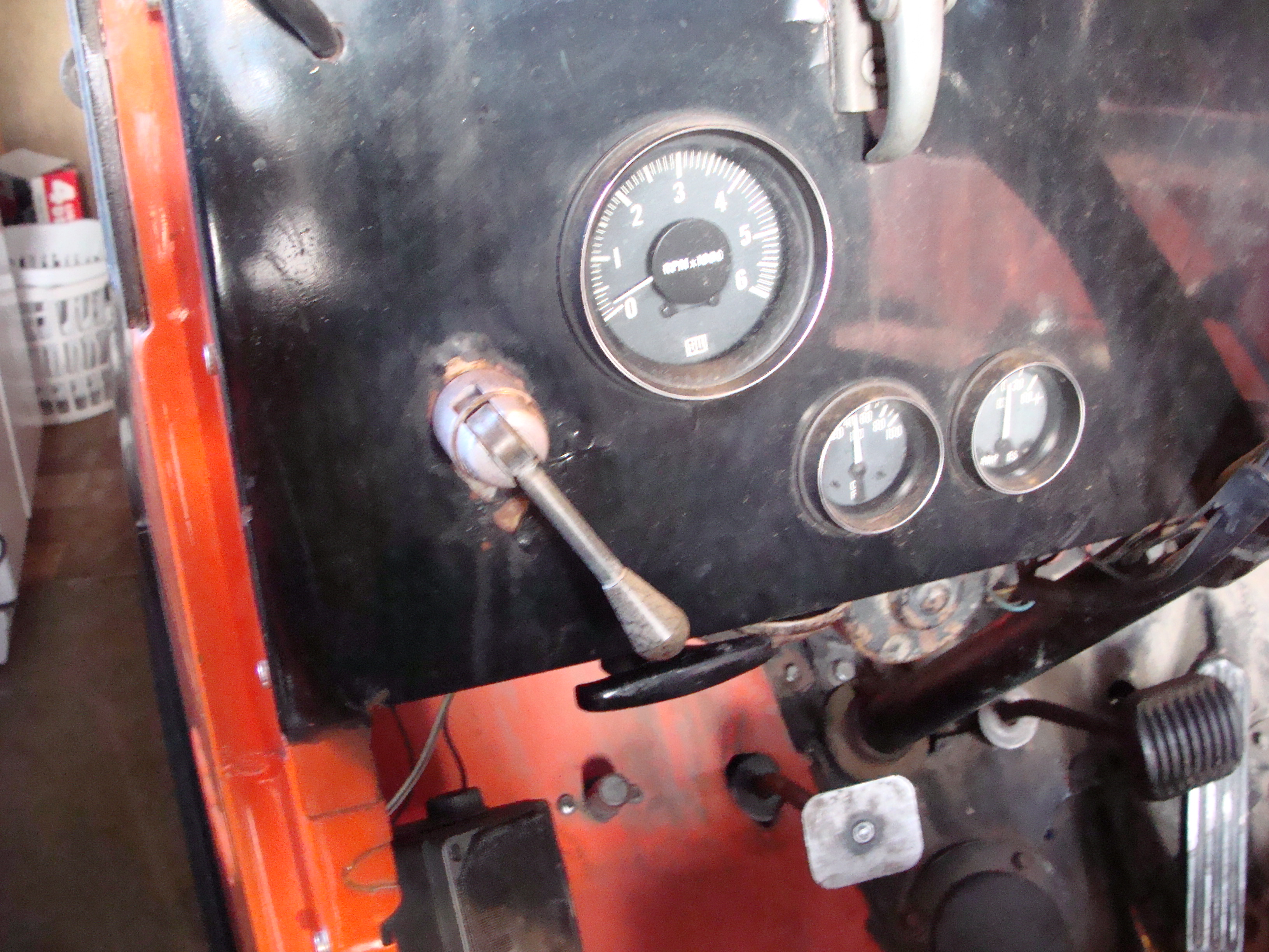

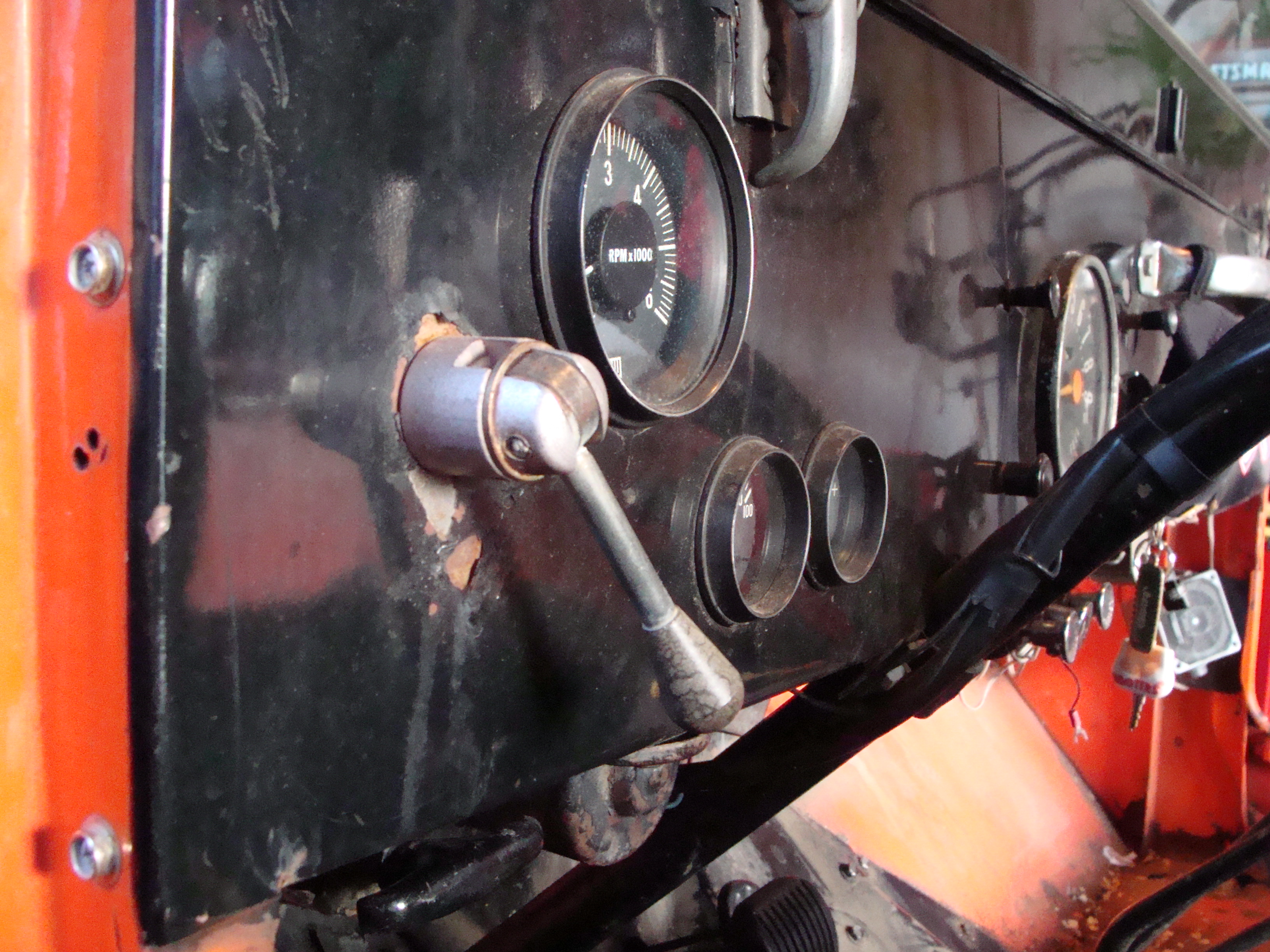

Thank u all for your help w my questions. I have been trying to read as much as i can on Jeeps. But as for my little handle question.....here is a pic. U guys might be right...it may have been installed by one of the previous owners. It had like a bicicle brake cable attatched to the back but it was cut off:???:
That appears to be a non-factory e-brake
