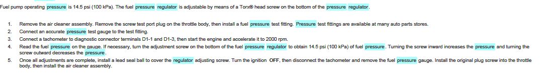

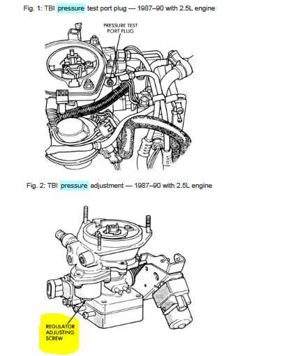

start engine then What is pressure at @2k rpm?
yes I have. but I will try again. I have also checked and tested both of the rollover valves as well as replaced all the rubber tubing that plumbs them.
My bad I missed the TBI in your post -
ignore step 3 use tach in vehicle

Ok so here's the list of what I did last night following your suggestions.
1. at 2k rpm the fuel pressure holds at 51 psi
2. drove with O2 sensor removed. same problem occurs. jeep runs for a few minutes at 15 psi then the pressure drops off until engine dies out.
3. Once pressure started to drop I stopped and removed cap. No difference in pressure no sound of vacuum as cap was removed. (remember I have tested both rollover valves).
4. and lastly I can not adjust the pressure on the fuel pressure regulator per your last suggestion due to the fact that there is no adjustment screw on the bowl of the regulator. besides I have 15psi at start up like I should right?
