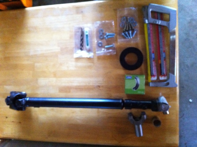

Here's the Iron Rock Off-road Slip Yoke Eliminator and driveshaft. It is the front driveshaft out of a XJ with the AW4 automatic and NP231 TC. New u-joints (3).
What I learned was the 3 bolts holding the cone on the end of the NP231 is NOT symmetrical (not an equilateral triangle - 60*). It only goes on one way so don't be too fast to dismiss it as not drilled properly.

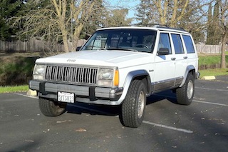

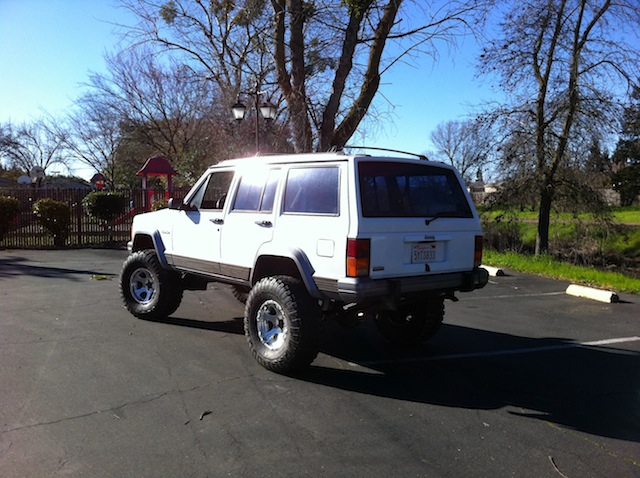

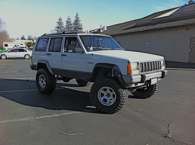

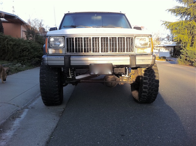

Some before and after shots ...
Looks realy good, what type of wheeling are you planning on doing? there is a cheap method to trimming the fenders and re-using the stock flares. there is a likely hood that you will rub.

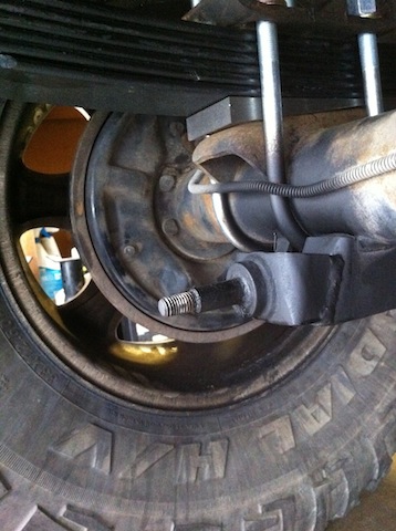

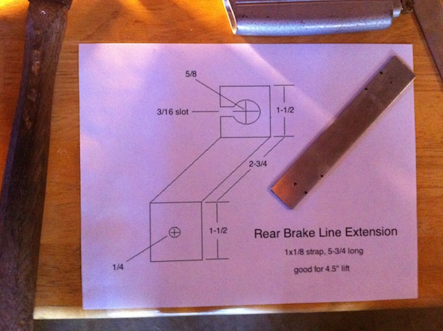

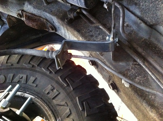

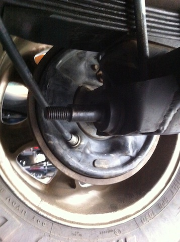

The next thing on the list to do was relocate and secure the front and rear brake lines.
After a fair amount of research, I discovered you do not need to get longer brake lines but relocate the ones that are already in place. GoJeep has a write-up on doing the rear brake line and most of the suspension suppliers have a similar bracket for the front.
After finishing, full flex is still there.

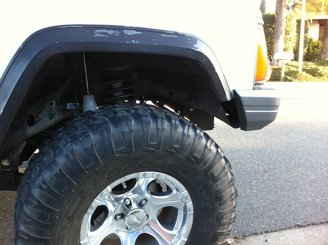

What I did today: 2/14

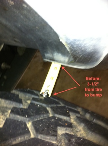

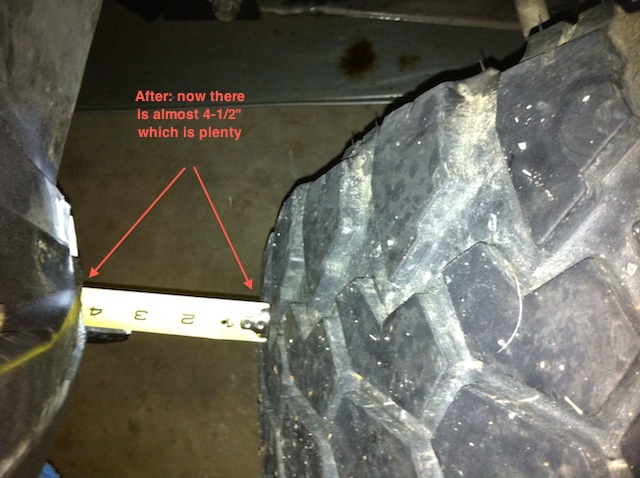

Pulling in and out of my driveway or making a tight turn at speed, the tires would rub on the back side of the front venders.
GoJeep has a great write-up on getting extra space for clearance just for that situation. How much space? Here are the pics.

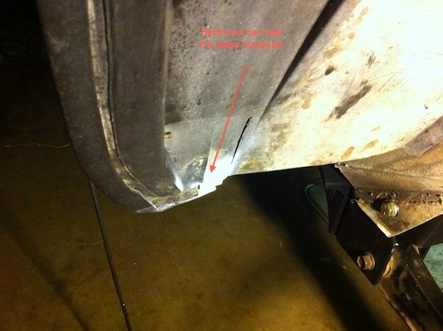

Over the last couple of weeks there has been a whole lot of prepping, waiting and not a lot to show but, at last, there is something of some significance.
1 - Prepped the track bar mount, control arm drop bracket reinforcement and rear shock mount (cut for relocation) for welding.
2 - Did some fender liner and sheet metal trimming. Removed the front valance.

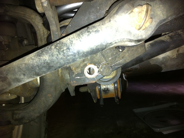

Welded the track bar reinforcement in place. Cleaned up and painted.
Not so much luck welding the CADB reinforcement. Turns out the welder is too small. Cleaned up area and repainted. Needs to have something before going off-road … I have another idea I'll share later after it is designed and installed. Didn't try to weld the shock mount for the same reason.
Fender trimming turned out well. Should take care of things until I decide if off-roading the Cherokee is going to get more serious.

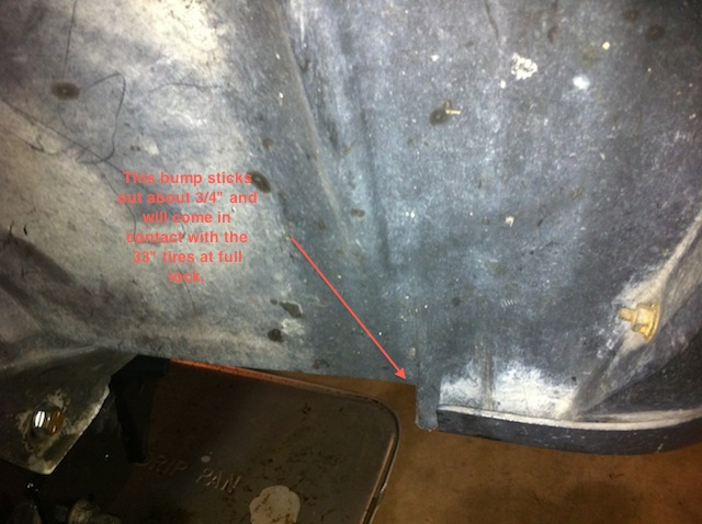

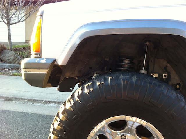

Here are some pics of the completed fender/liner trimming --

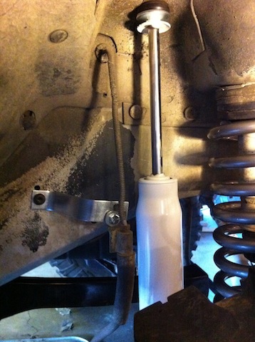

Thought I'd throw in a couple of pics on the finished rear shock mount relocation. This actually raised the shock and increased ground clearance by almost 2-1/2" … and at the same time, corrected for the 5" lift and 6* shim needed to bring the pinion angle back into spec for the double carden driveshaft.
As before, BIG thanks to GoJeep for showing how to make all this happen.
The only thing I did differently from his instructions was when it came time to weld into place. First upper mount was bolted in place then, with vehicle weight on the tires and suspension, swung the shock into place with the lower mount already bolted to the shock. In this way I felt the shock would be in a "neutral" position both upper and lower so, when placed against the axle, it would be in position with no binding top or bottom. When done, the lower mount slid onto the lower mounting pin like it was greased.
