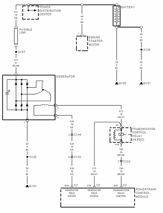

Steelheadz is there anyway you could help pointing me in the right direction to get this for the ECM? I need a wiring diagram for part #0514152aa 1998 Grand Jeep Cherokee. Thank you.
Here is a Schematic diagram for a 5.2V8 98GC. That part number you posted is missing a digit. i was going to decode that part number to see what engine you have but with a missing digit its a no go.. I hope this diagram helps you.

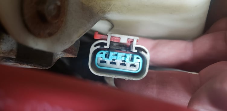

Hi! this thread has been very helpful. I have a 1998 Cherokee XJ that stopped charging. The alternator was rebuilt but had tested ok prior anyway. We went and made sure all the grounds to the battery, frame, and the 4 by the PCM were cleaned up and reattached. I found that we are not getting power to the alternator field.
We have the following connector. The two center wires are green and green with a stripe. These connect to the field on the alternator. When turning the key it shows voltage for a split second and then goes away instantly. I am getting conflicting info on what is feeding this. One place says it is fed by the ASD relay. The relay seems to be working fine and it was swapped with another good relay with no change. One place says it is fed directly by the regulator in the PCM. That is my expectation. Another though stated it would be fed directly by the ignition. I expect that is less likely.
Does anyone have access to the wiring diagram that will show me where this green and green with a stripe go back to? I don't want to buy another PCM to try if there is more of a chance the issue is coming from somewhere else. Thank you for the help!
**Edit** I was able to find the PCM connector diagram. Wiring from B10 and C25 to the field terminals is good with no shorts. The PCM only sends power to the Field Source for that split second and stops though. Is there any where else I can trace this back to? Or is the PCM likely at fault? Everything else powered by the Fused ignition looks good. I get voltage at pin A2 for fused ignition switch and A22 has voltage.
