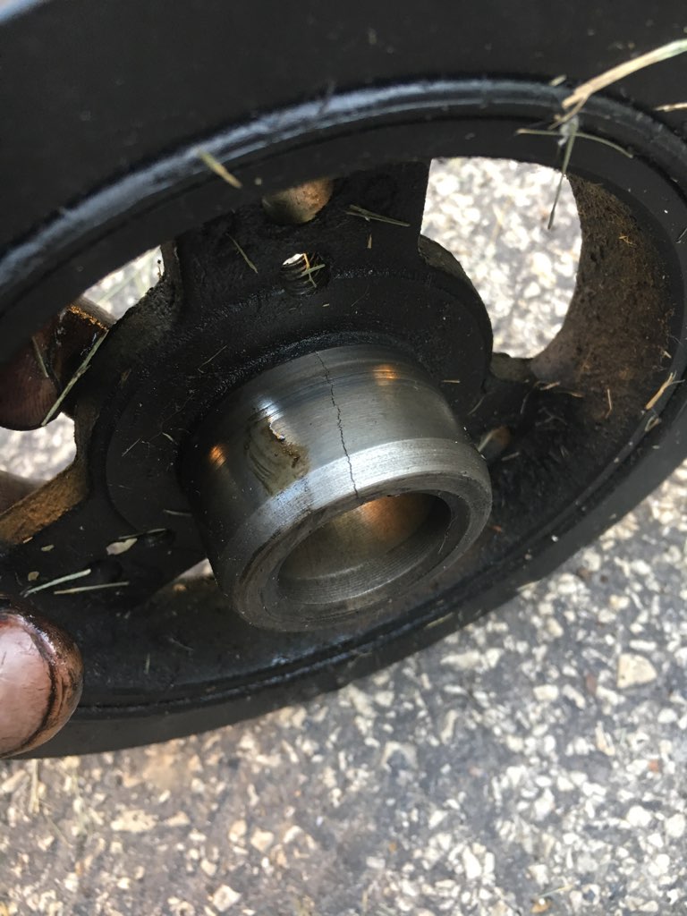

So here i am with the diagnosis, cracked vibration dampener that was silicone (glued) back together along the key-way.

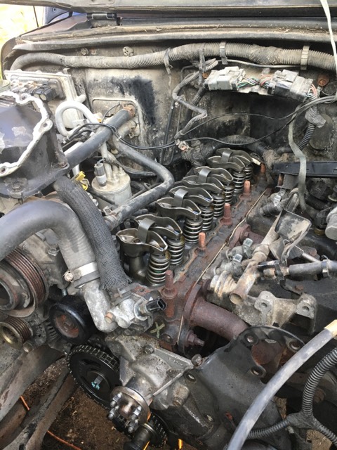

A fractured throttle and spacer plate from the back fire, and melted engine harness.

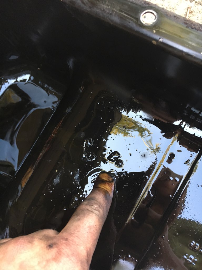

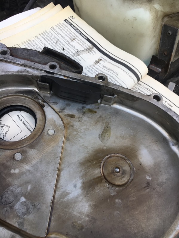

Valve keepers in the oil pan, and massive rough running and timing concerns, (possible jumped teeth, or bad tensioner) according to the scan tool.
