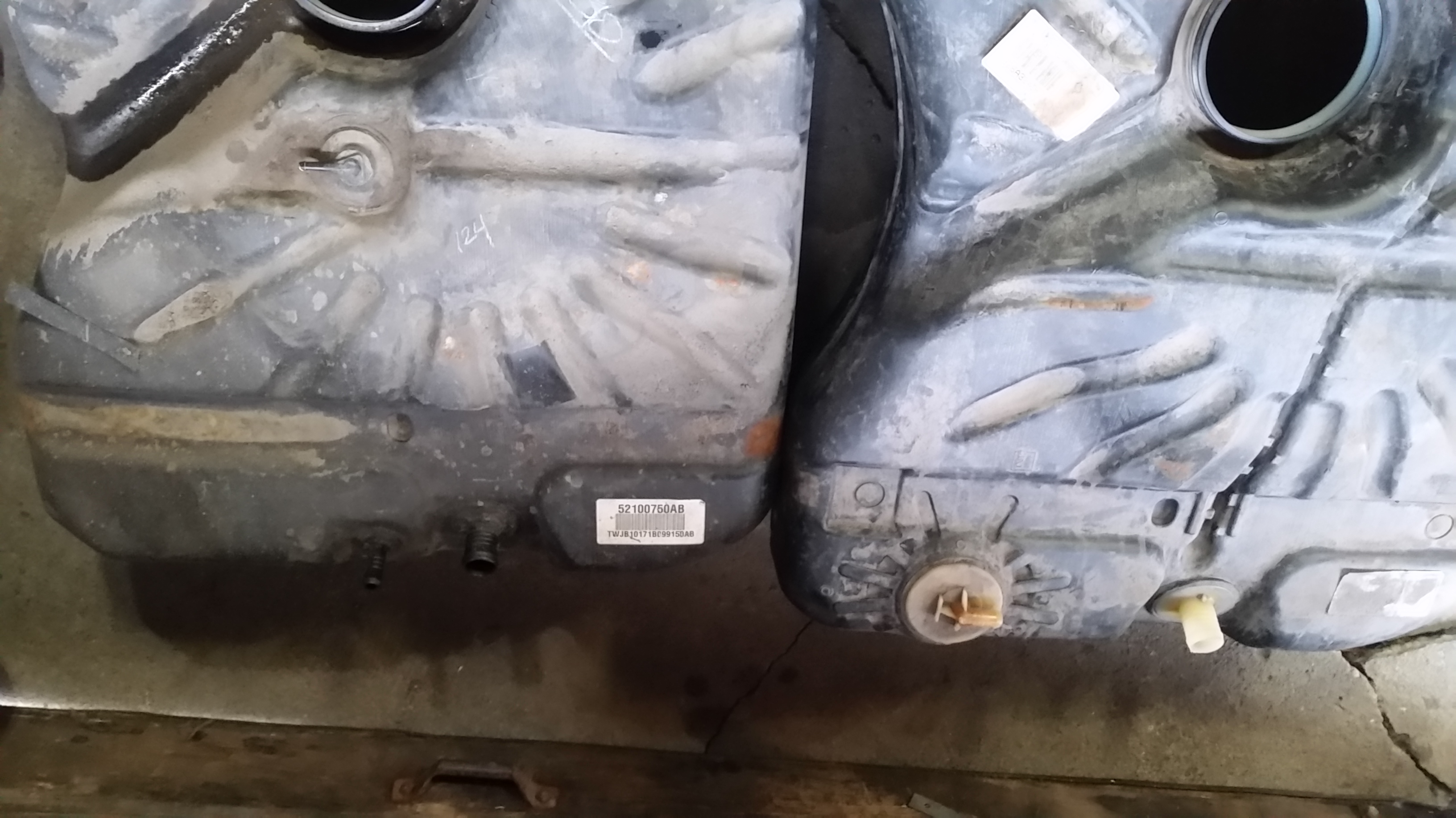

So I got a replacement tank and a skid plate for my WJ. The gas tank has a different angle on the connection next to the gas filler nipple. Is that for overflow on gas when filling? I hope my hose will have enough length to reach the new tank attachment since it is a few inches away. My original tank is on the left and you can see the bottom left hose connection is straight up as opposed to the new tank (right) is at an angle pointing to the right. Any tips would help.
dlm ny country

Are you sure that is the correct tank?
It's not a big deal to replace the filler hose. The old one probably has some bad spots anyway - they get brittle as they age.

I took the skid plate and tank out of another Jeep WJ. Not sure of the year. Most likely, there are small mods done over the generation span (1999-2004 I think) and that is most likely what I am dealing with. Tank size and shape is pratically the same. I am curious to what that 2nd smaller hose running down next to the main filler hose is for. I'm thinking it is for breathing and back flow for filling the tank.
dlm ny country
I don't know for sure but have always assumed the 2nd [small] hose was for air to escape so the tank can be filled easier.
Yeah that is what I'm thinking, plus over flow from the gas filler surround molding. Anyways, I got the tank hooked up. I ran an extension hose so I could reach the small filler hose. I used coolant line and a brass fitting to couple it to the original hose. There is a small gas vent hose near the fuel pump that was also in a different spot than original tank. That was ez enough, I just extended the hose with some gas line (1/4"?) I had in the garage. I supported the tank with some large zip ties, got it in place, added some gas and she is running ok. I got her in the garage and now I will get the skid plate and straps bolted up. Snow storm coming so I might have to wait till next week. Can't wait get this running so I can dump it. :)
