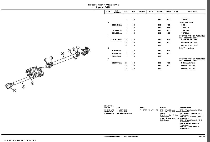

Next question is, I removed the front drive shaft and the rear CV joint is shot, how do I measure for a new one?

What are you measuring?
see attachment part # there. Only 1 size is shown.
OR bring your vin # to dealer for ID'ing part numbers...
You could just replace the CV Joint, you do not have to replace the entire shaft. Is the shaft itself damaged or bent?

Hi- I measured from the screw holes and it matches one of the four sizes I found online. It is only the CV joint, I have never replaced one, the whole unit itself goes for 100 bucks, thanks for the inout, I'll look into doing just the CV
