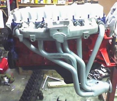

it runs down from the head, around the drivers side motor mount, combines to 2 pipes here, then down under the front of the oilpan just behind the balancer pulley, -still as 2 pipes, pointing perpendicular to the right front wheel it then makes the bend toward the back, as 2 pipes, and is combined to 1 pipe just below the starter or right in front of it.. I forget. Thenit goes straight back to the cat in stock position, then to the THX catback set up i also bought with it, and out the back. Everything fit well, although i did have to cut like 5 inches off the pipe that joins to the cat from the header came with the header, and was too long, dremel did it in a minute. Other than that I just kinda hung everything up there loose and sloppy and rolled around on a creeper tightening and checking for things coming undone as I would torque up one end.. bla bla bla, it fits snug now, and I really noticed an improvement, looks awesome too.

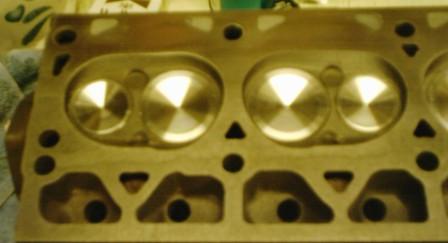

Head has been at the shop getting work done I just got a call it was done toady (wife is going to puck it up for me I'm in bean town for work)
the work done to the head is chevy value's in it with Clifords springs and retaners) the spring seat had to be cut down 168th to get them to work.
going to to cost an arm and leg but should be worth it (at least thats what im telling my self)
The weekend Im installing the head and all. I think in having the the headers creamic coated (just trying to do it right) as my father taught me if your going to do it than do it correct or dont do it at all.

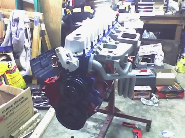

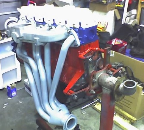

Well I got the motor back together.... :D
here are some pick of the process

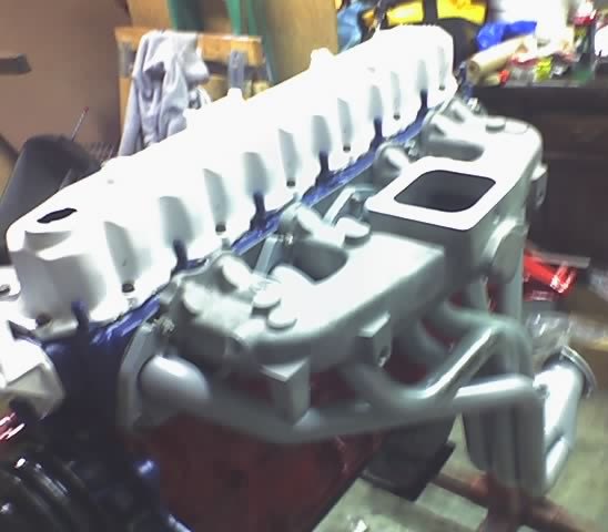

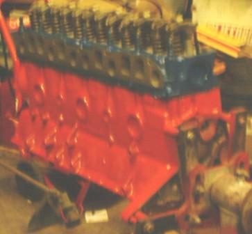

More pics
