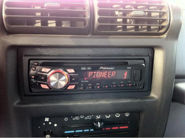

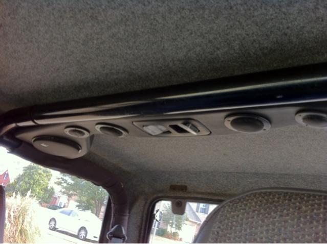

I have a VDP soundbar, it's alright, feels kinda cheap, but I'm happy with it. I like the head unit alot. I'll be putting those speakers in as soon as I get a hold of the tools to make that adapter from earlier in the thread.

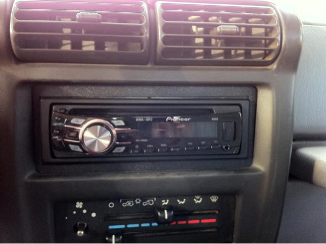

Thanks, I worked pretty hard on it, still have to bend those tabs out in the back to completely secure it lol. Took about 2-3 hours with all the wiring and teardown and such. Getting ready to make those adapters, the theater tech department at my school has a few saws and one of the teachers said he'd help me out. I gotta check voltage from the wires this weekend, lost the right back speaker on the soundbar, it's not playing.

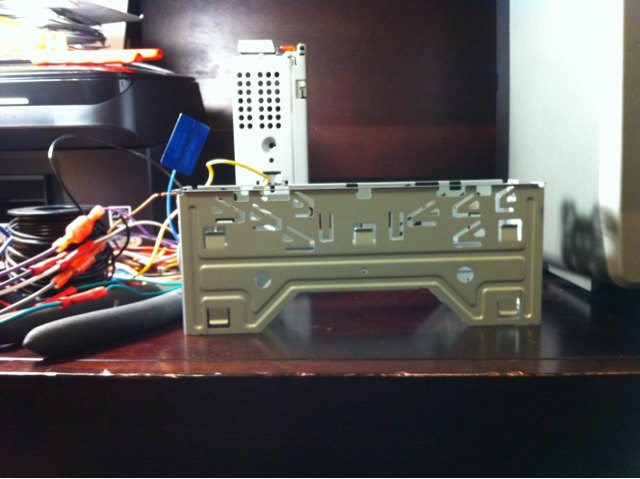

Slide that cage back into the opening on your dash. Bend the little triangle tabs out keep the cage from sliding back out of the opening.Slide the radio back into the cage.
