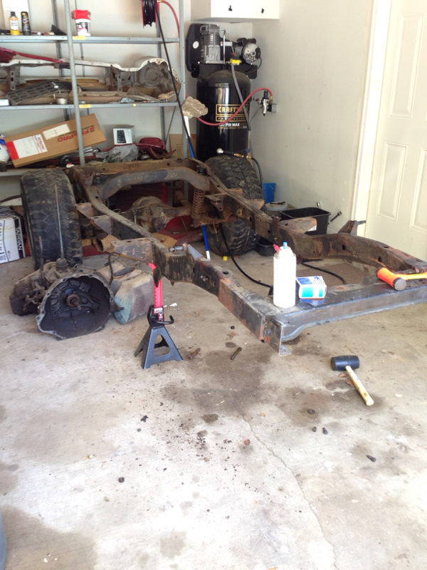

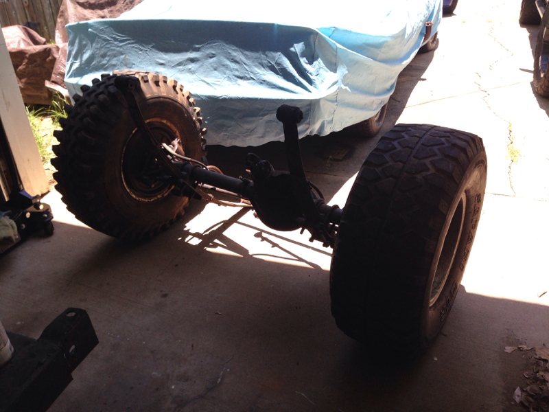

Thanks Jason, I can't wait to run a new cable harness. So when I get back home I will sending my frame to be stripped, ecoated, and powder coated. I have been thinking about my transmission and axle options. Whether I want to look and find a 4 speed or rebuild my 3 speed. Also, as I mentioned in a previous post, I am looking for Dana 44s. But not sure if it's worth it.

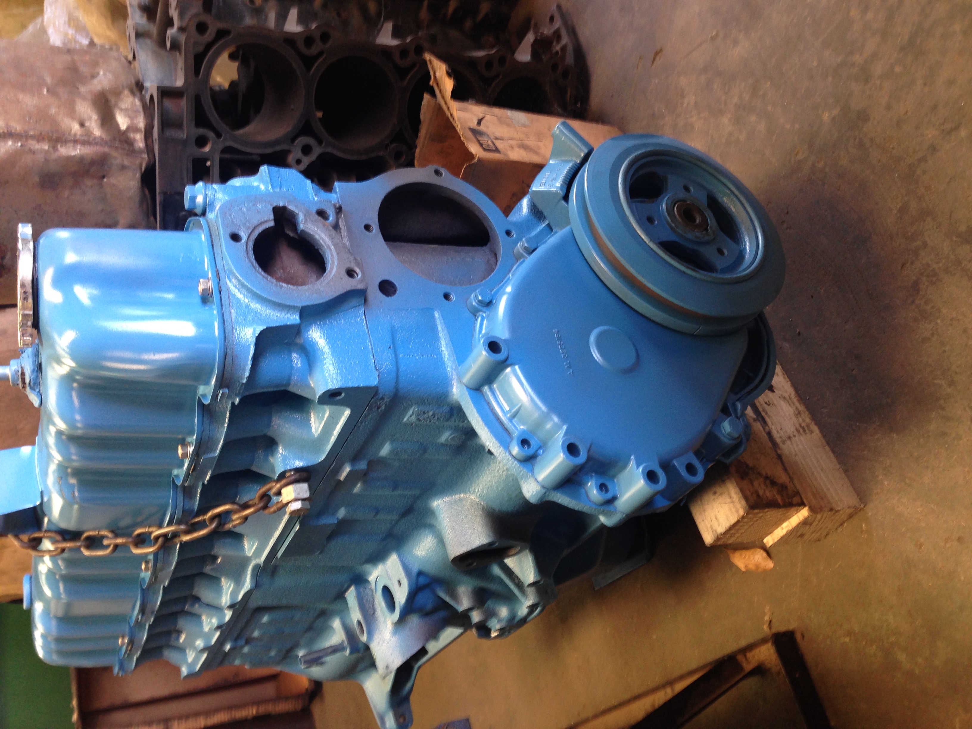

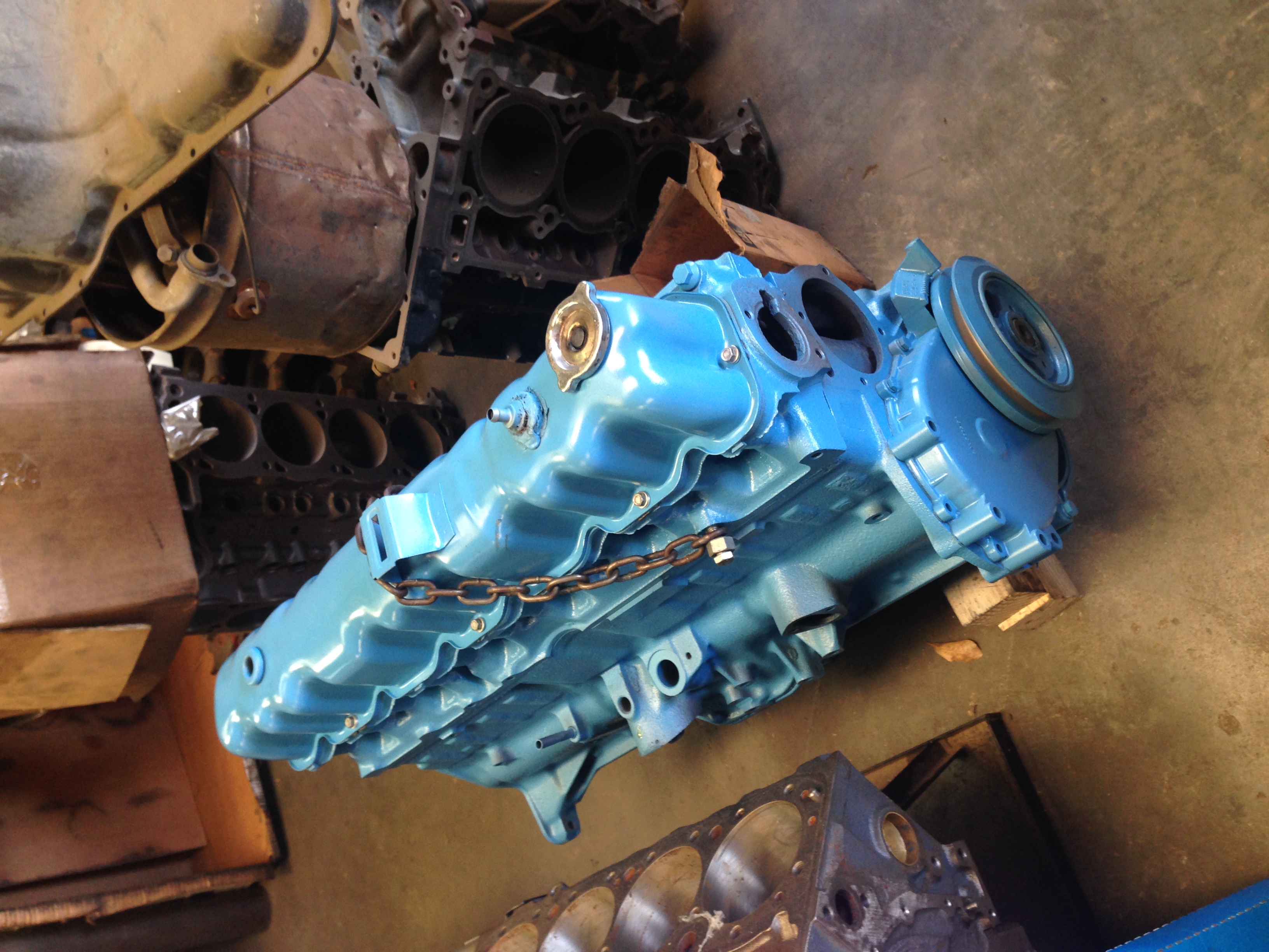

I'm picking up my engine tomorrow. Pics should be posted. A friend also is wanting to sell a 4.0 to me with the 5 speed for $350. He is wanting to convert to a Chevy 350. The engine is solid but the transmission needs some work. I forgot to ask how many miles it has. So what do you guys think?
An AX15 good used usually goes for more than that so ordinarily I would say grab it , especially with a 4.0 thrown in . I realize your in the middle of a resto and cash is tight so it's a tough decision. If your considering moving up to a 5-speed and the rebuild kit isn't too expensive , I like the idea of it. Hey , since the 4.0 runs well , you can flip it for what it'll cost for the rebuild kit and make the money back . Just a thought. Glad your engine is complete and will soon be back between the frame rails !

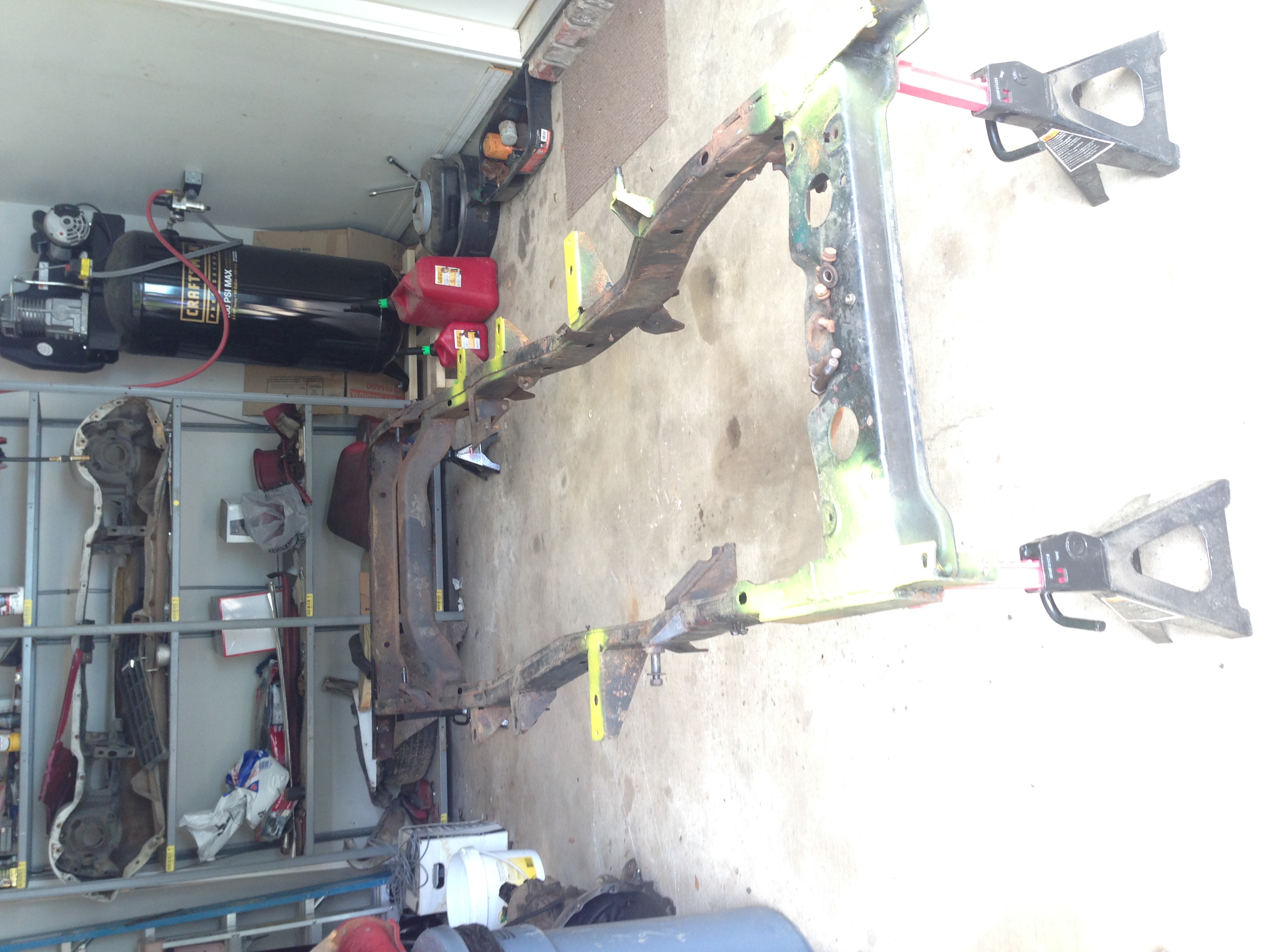

Just the rear end left.

IMG_1122[1].JPGI posted another picture of the complete engine before paint. Its painted the ole AMC blue color. I'll try to remember to take pics of it later. Also, there should be a picture of a blackhawk. IMG_1164[1].JPG
