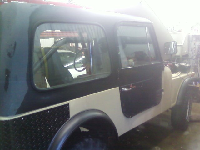

Hey guys I'm very new to jeeping so try and take it easy on me. I have a 78 cj7 304 auto with the quadratrac set up ( which I absolutely hate) I'd like some ideas as to a replacement setup I know I have to change the rear axle just want some ideas as to the rest I'm also wanting to go with a manual trans. Thanks
