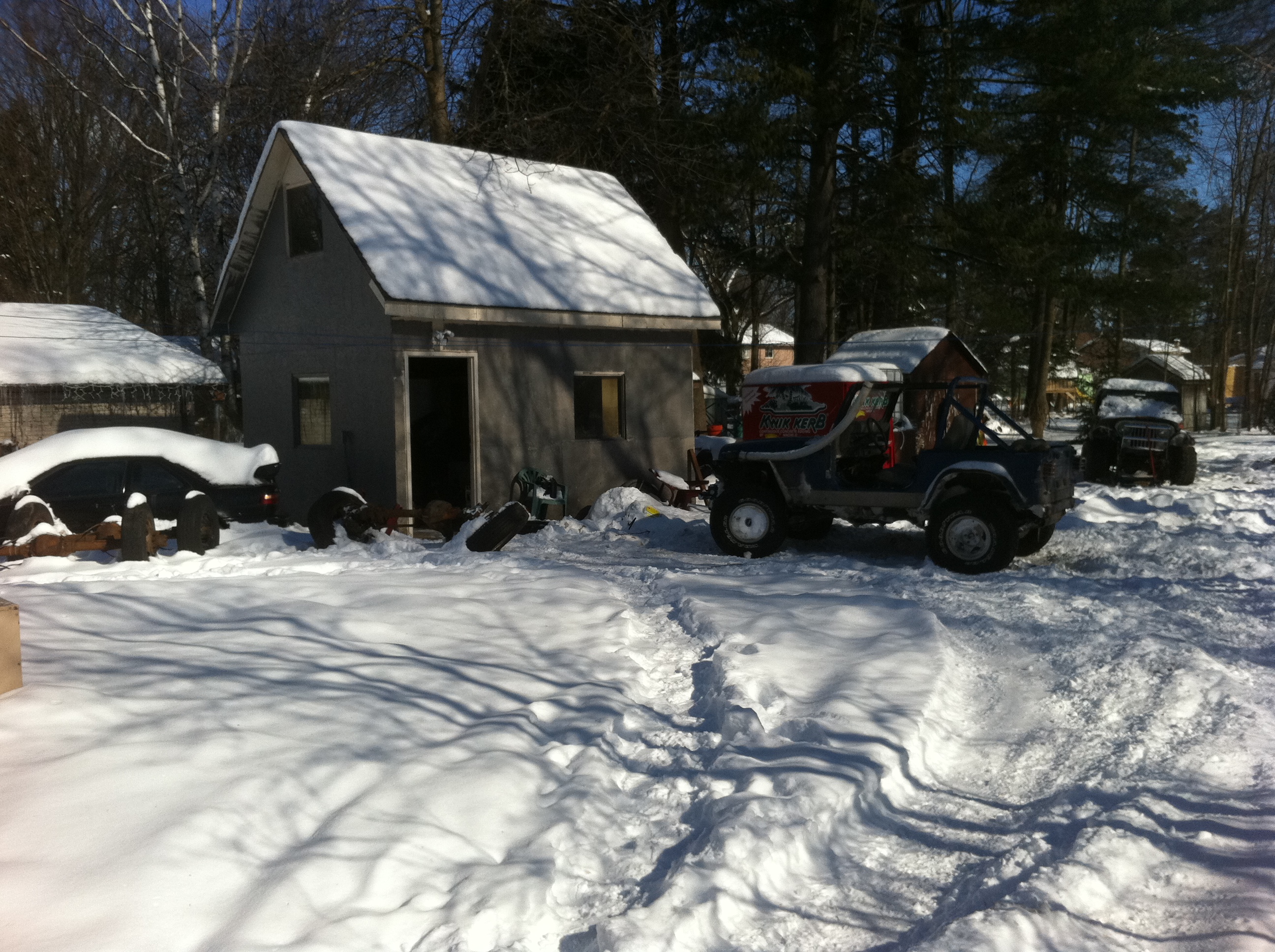

:DHey im lookin for sum help n ideas thats it. u dont like how it looks do urs diff. I made those brackets myself(still need to b trimed n fitted 100percent b4 i weld them on) n will not raise the jeep just move leafs outward. Also they will use the outside exsiting hager/braket the only reson i said soa wit the lift spring cause there on there n i dont have the originals nd i think the rear will b to high 4 sua in frunt the rear shackles r made 4 mock up purpose only and i just picked up the axles its -20 normally n im doing all work alone no heat in shed n lotsa snow outside so save the scawy coments 2 urself. the project hasnt even begun im just gathering parts n info im 22 own my own house and im suporting my commin law and 1 mounth old daghter while laid off and trying 2 make shure every dosent turn 2 rust this is my work space:cry:

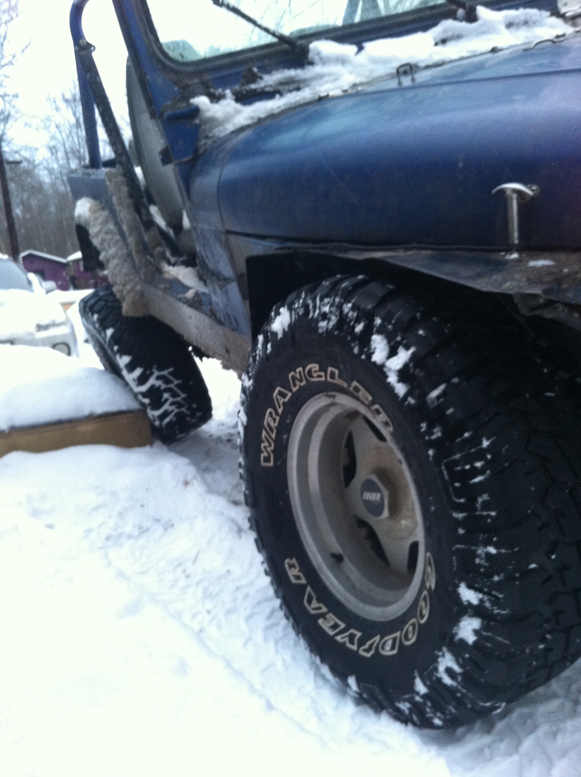

this is a pic of the front fully compressed i got 33''s, 4''lift springs, stock steering except droped pitman arm i trimed quite a bit i bought my jeep with the lift nd tires but the bump stops look stock n in original spots if u dont want to eat ur fenders ull have to do sumthin about it but ur steering is fine im strickly tral ride so crushed, bent or straight up demolished sheet metal dont bug me just bend it back or cut it out n weld in sum new stuff
