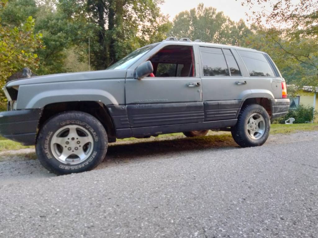

I have a 98 grand Cherokee 4.0 automatic.. it ran and drove fine until the fuel pump went out I put a brand new fuel pump in it the battery died charged it and now it will start run for a second shut off.. I lost the original keys long time ago so I've been using a screwdriver to start which never bothered anything because I've been driving it like that. I just can't figure out why it won't stay running now.. nothing on the dash is working either way just the abs light come on. IMG20220915191550.jpeg
