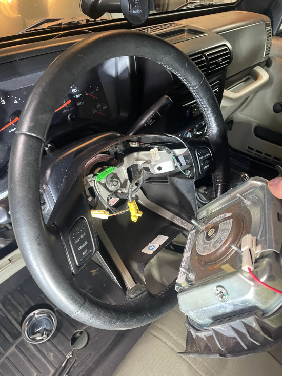

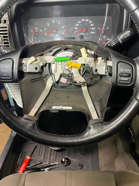

That fixed it all! No more air bag light and the cruise control now works for the first time in the 6 years since I got the Jeep. It was a simple job and it turns out that it had been changed before and was the wrong one! You can see in the picture the green connector. That wire comes out of the clock spring, goes to the top of the steering wheel and splits off to both cruise control switches. You can see the one on the right is plugged in but the one on the left is not even the right plug. It is the white connector on the left and should be black and plugged in just to the right of the Set button. Of course it's not going to work if not plugged in. Luckily the new one had all the right connections and good to go.
