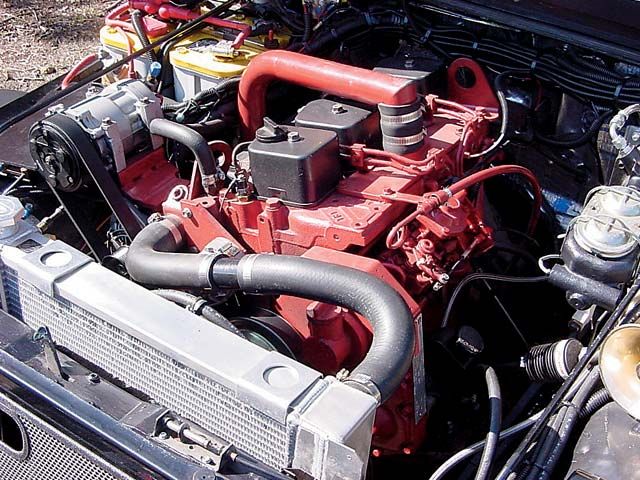

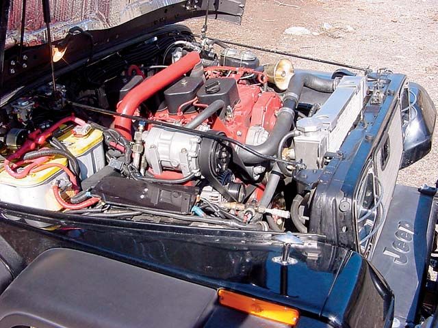

745Lbs?!!!! That's 215Lbs more than the 4.0! So you would have to beef up the front springs a bit I guess. But I've been weighing the pros and cons and I think it's worth it for that 25+mpg and 350 lbs/ft. I wonder what transmission I would have to use, or if the ax15 could handle it with maybe a beefed up clutch. I'm really thinking this might just be a worth while undertaking.
Here's some pictures, (had to steal them from another site). :piratenanner:

Boze I have a 4bt in my TJ but it is not running yet. I am running D60/ Sterling 10.25 axles, AX15/231, 38.5" tires, 6" lift. The AX15/231 will handle the power even in moderate wheeling. The torque it makes is up in the big block gasser range, so power application finesse is the key. Don't worry about the clutch as the Jeep clutch and flywheel do not mate to the engine. You will need a Cummins flywheel which uses a 12" clutch so that is plenty big, and an adapter to mate the AX15 to a GM bellhousing. If I were starting all over I would buy an engine, flywheel housing and flywheel from a GM manual trans application. A Ford manual trans aplication will work as well. The GM auto trans application is most common but the most costly to adapt to an AX15. A Cummins to GM flywheel new is close to a grand.

The pics you posted look very similar to my TJ. Where did you find them.
