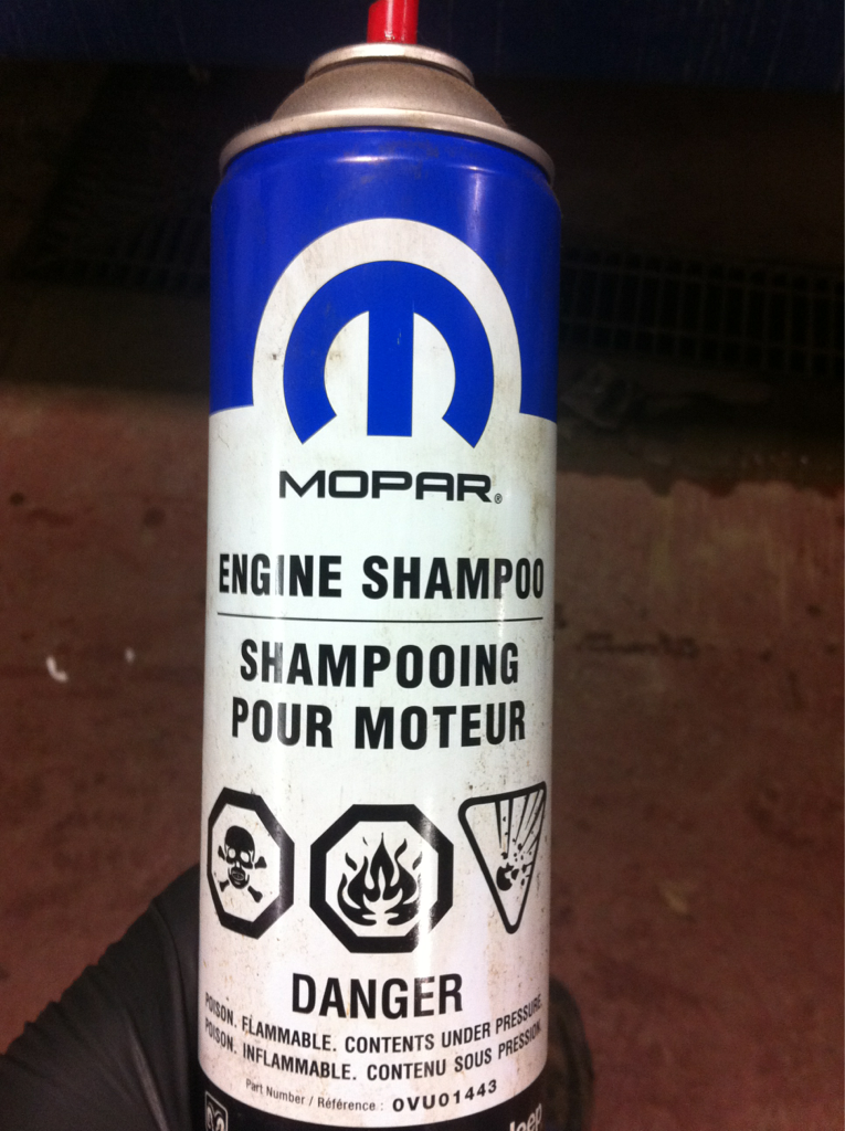

Mopar engine shampoo is the best stuff I have tried. Spray on a warm engine. Let sit for 15. Spray again and wash off.

As to the Mopar engine wash, he may be talking about this:
Mopar OEM Engine Degreaser - AutoTruckToys.com
I use a pressure washer. Just stay away from the PCM. Air filter. Here's the stuff I use. I spray it on when I get to the car wash then wash the rest of the veh then do the engine.
