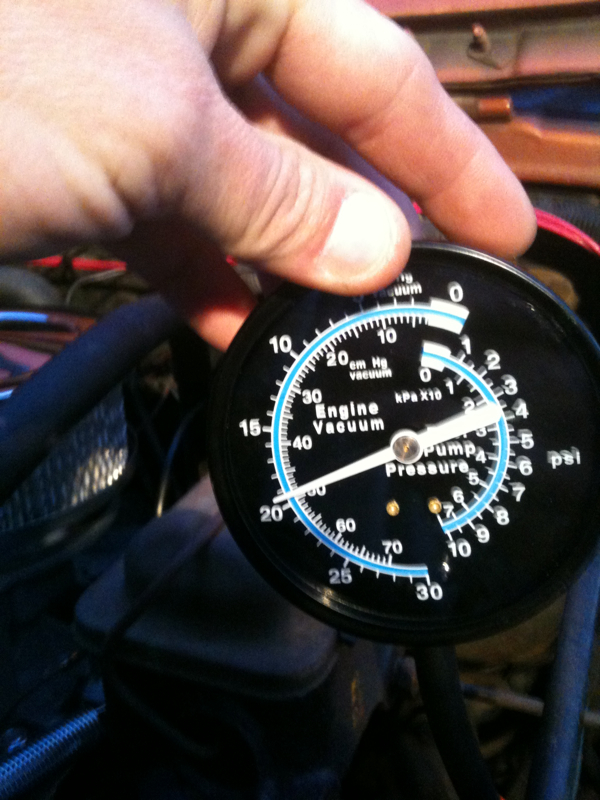

Current vac is 19.5. My mixture screws are out now about 4 1/4 full turns. Sound right?

Yea I have 48's. For some reason I fell as though 4 1/2 full turn out on mixture is way to rich. This is my next learning curve I quess. Don't worry, when I get this down, I have plenty more threads to start.

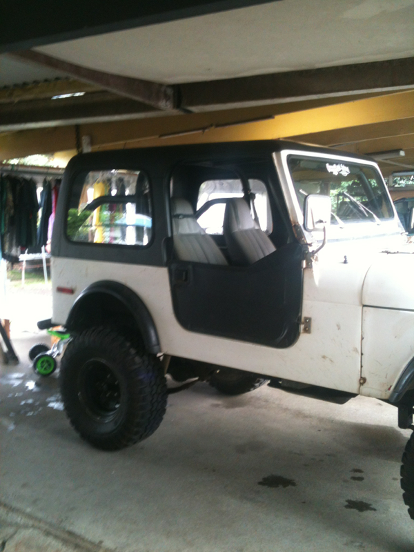

Dude just got back from picking up my hard top. Got it for $300 I think it was a fair price. About 150 miles round trip and my brothers got my doors, about another 100 miles round trip. I'm very happy with it. Man three years with only a bikini top in the rainiest town in the nation was getting old. Anyway, how's it going with the carb?

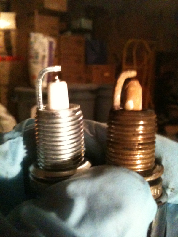

Looks nice. Bet that will keep you a little dryer. Carb is giving me a headache. And I think im from exhaust fumes. Get this. I am still tinkering with the Fuel mixture screws and she just shut off. She was idling fine and just stopped. Screws are at 2 1/4 turns out. Man I'm glad I am not a mechanic. I would have jumped off a cliff by now.
Won't start. I pulled plug one to see what it looked like. Left one is new. Right one was just in there. Yuk
