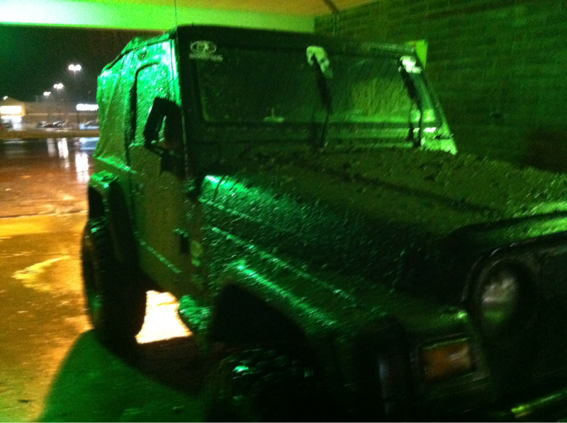

Got 02 sensor seemed to fix the check engine light but i still got a mild studder every now an again i put fuel system cleaner in it to see if that will help and hints? And i also have like bad bad wheel hop if im cruizin and hit a bumb it starts bouncing and jumpin really bad i have to completly stop for it to go away then i can drive normal again anything i should look at with that
