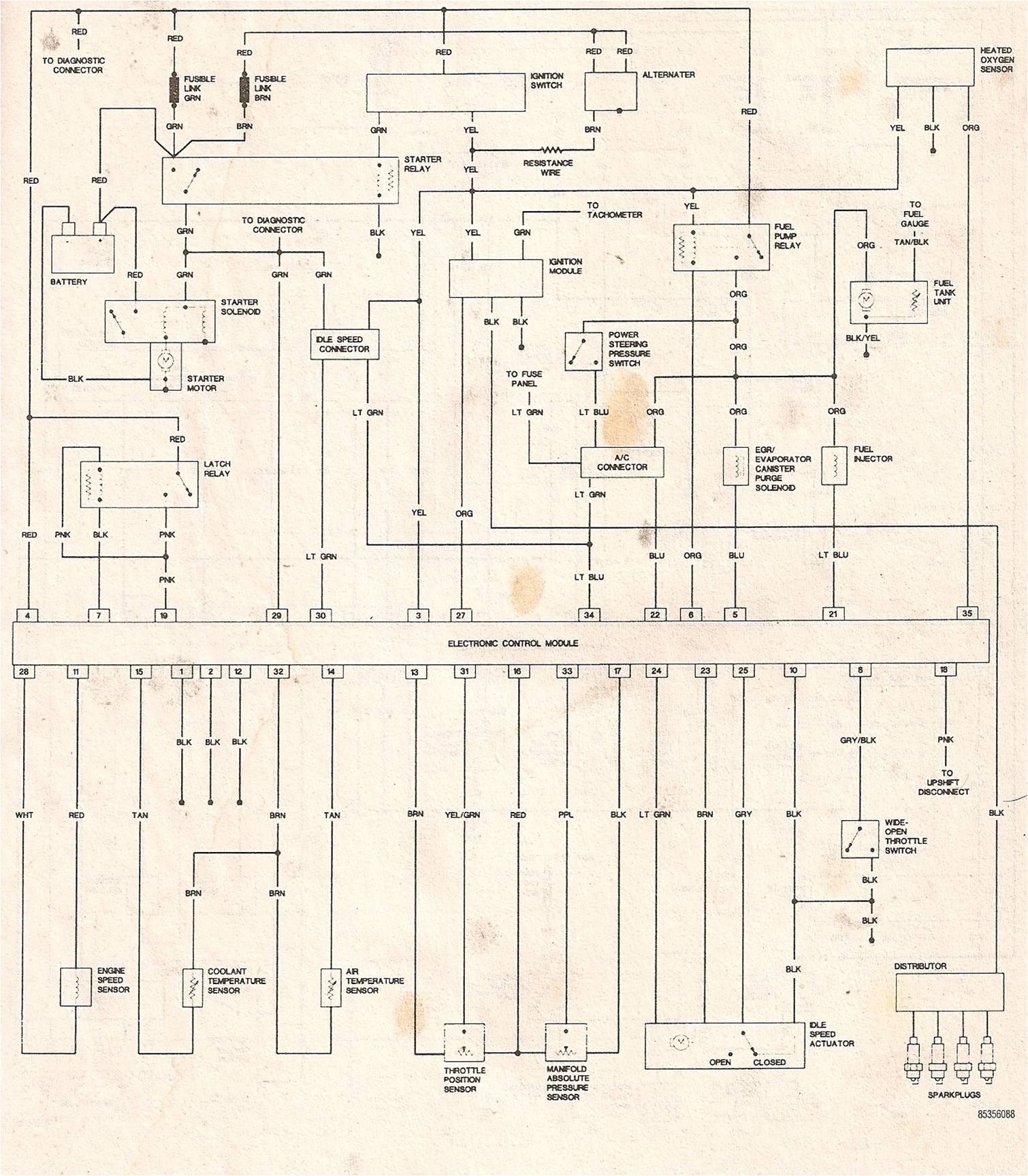

Aaron, I am having a similar problem and have been looking for a wiring schematic. Do you know if the thumbnail you posted is the same for a 1990 YJ 2.5L 4 cyl manual?
My jeep has no power to the top of the coil nor does the heater fan have power. I have traced a green wire with a white tracer from the starter through the starter module back to a microprocessor. I am trying to figure out if the ignition module or microprocessor is bad. My dad's co-worker said I should get a diagnostic sheet that shows the draw for each module and wire. That would help run down a power issue with a fuse wire or resistor.
Here, this one is for the engine controls of a '90 2.5L. I made the picture huge, so after you click on the thumbnail, click it again when it opens in a new window. Let me know if you need the schematic for the body and fuse box too.

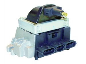

Mike I am having a similar problem on my 1990 2.5L 4 cyl manual. I looked under the windshield washer tank but failed to find it. I looked up the part on the internet and it looks like a somewhat flat metal square with two sets of wires and connections correct? Aarron gave me a wiring diagram to help trouble shoot the issue. I have been waiting on my buddy to come by to help with the trouble shooting. If I could find the ignition module and get it tested I would be that much ahead. Thanks for any help.
Dylan, here's a picture of a ignition module for a '87-'90 2.5L. As far as testing it goes, I don't know. All I did was make a phone call to AutoZone and they said they hadn't done it in awhile, but they still could. Sure enough they figured it out and it came up bad on their tester. It's just a phone call once you get the part off. Let us know how it comes out.

Aaron great picture. Found it on left side of engine mounted on fire wall. Though it tested okay. Still hunting. Maybe if I give more information someone can help. When the ignition switch is turned the gauges come up, radio comes on and you can hear the fuel pump come on. Further turning of the switch gets absolutely nothing. We changed some parts chasing the intermitant problem and now we have a new starter, new alternator, and a new starter module (that part really was bad) We tried to hot wire the engine from the battery to the starter and could get the engine to turn over but not to fire. We found that there is no power to the top of the coil. Finding the ignition module (ECU) works has me with still no Jeep. There is more. The heater fan has no power as well. I am sure this is a related issue. I have traced a wire from the starter to the starter module through the fire wall and back to a microprocessor. I might be in over my head now. If it is a simple as a fuse wire where do I start? Or should I take it to someone with a computer diagnostic machine? Thanks for the help so far.
Aaron and Mike, thanks for the help I found a bad fuse link wire. As soon as I get it changed I should be back on the road. Thanks for all the help.
