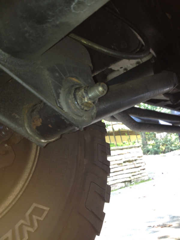

Found the culprit of my death wobble in my '04 tj sport! It was the bolt from the control arm to the axle. It was way loose and could have been disastrous had I not have checked! Thanks to TerryMason and his video post

That'll do it.
While you've got the wrench out, check how tight the trackbar is as well

Do a dry steering test to see what is loose. Most common is the track bar. But check tie rod ends and steering gear.
