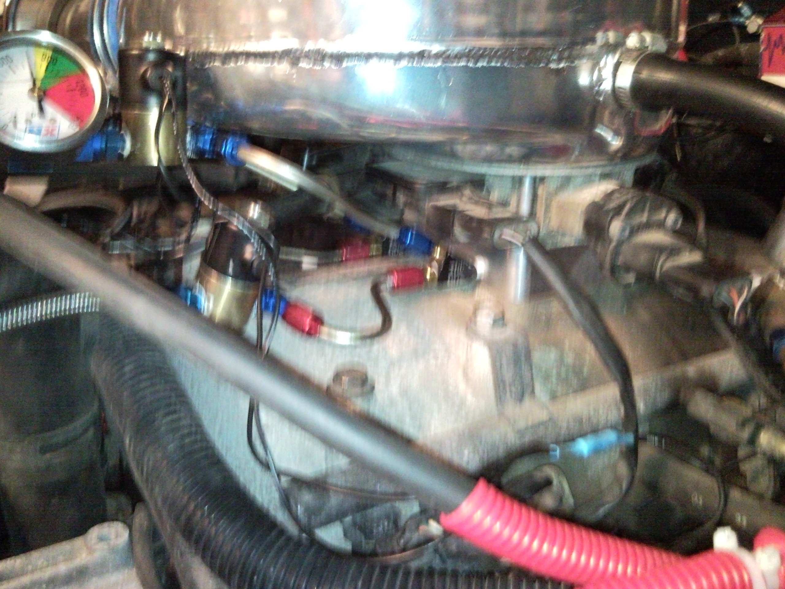

Throttle body spacers work great if they are installed right :purple:

This is what happened to my TJ 02 after the spacer install... i already had magnaflow exhaust and added a K&N air intake and a 1" spacer and when i really noticed the difference was when i put it in 4 wheel low. there was so much more torque.. really made a difference in low gear.. so i think thats the easiest way to tell the difference.
