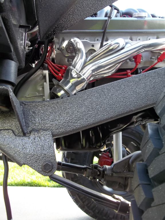

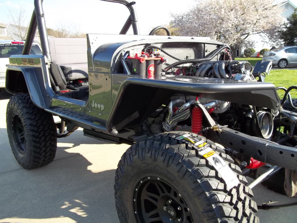

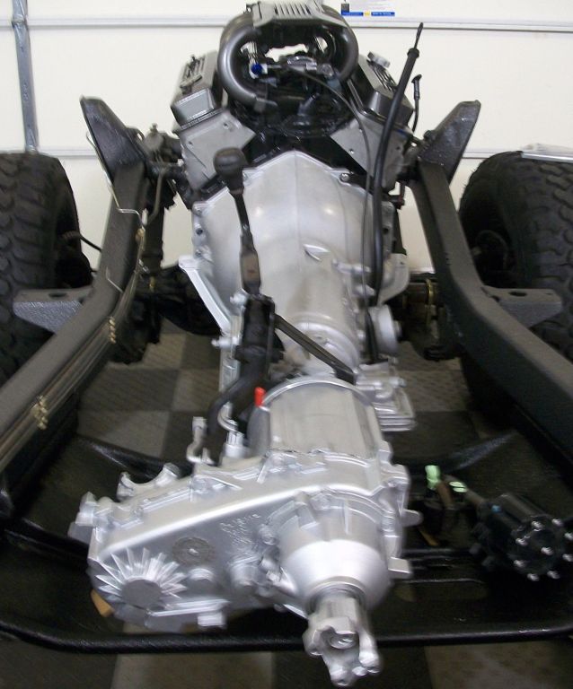

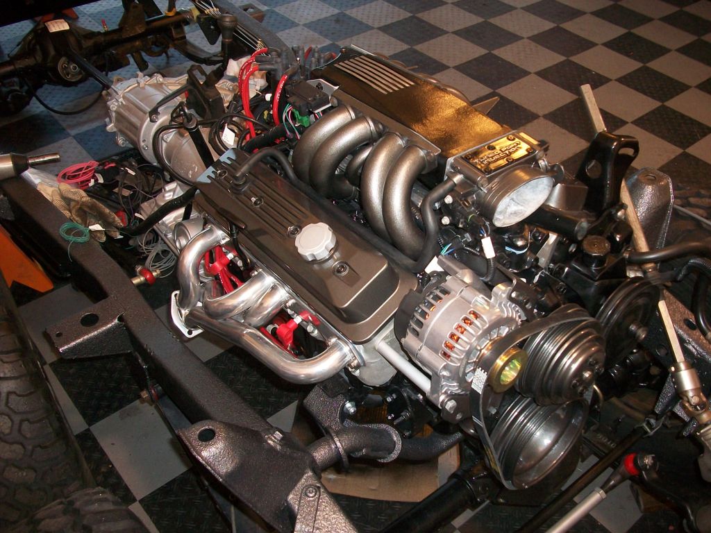

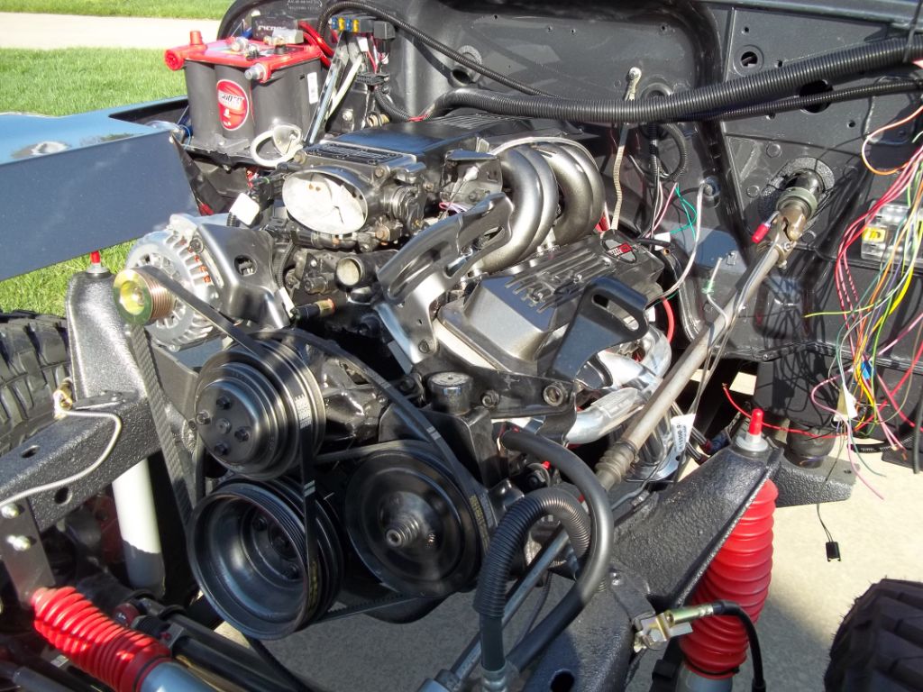

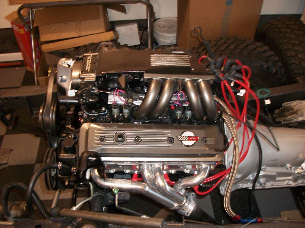

91 ZR1 Vette motor with 700R4 for 600 bux. rebuilt both for 1200 bux.
