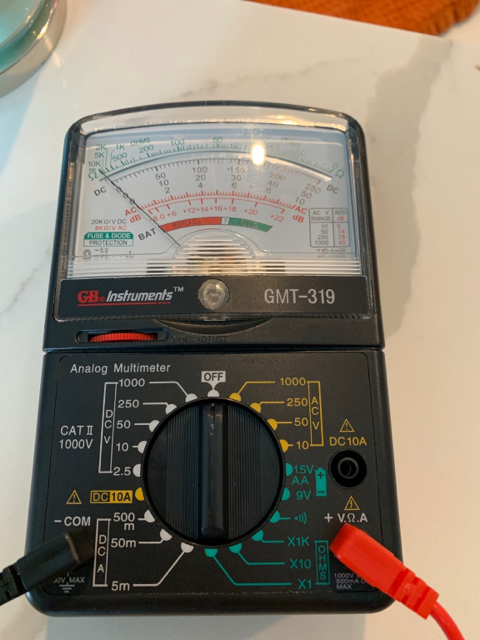

I am going to do the test but honestly never had to use my multimeter for stuff like this before. What settings do I set it to to test the voltage? I have a analog meterImage1596311464.458870.jpg
I figured out how to test it with my multimeter and it is reading same voltage as my battery. But as far as terminal 2 being grounded I didn’t know what you meant by that. I put + in terminal 1 and - in terminal 2 and got the same reading as my battery
Touch the black lead to the frame or a bare metal area. Then touch the red to the terminal you are testing. 0 zero volts is ground.

So I checked the ohms but not sure if I did it right.(I’m not good with electrical at all). I set it to 10 ohms max on my multimeter and connected each probe to each pin sticking out of the actual sensor and read 0 ohms just want to make sure before I call quadratec and ask for a replacement
So it turns out I was wrong about jk speed sensor resistance. It will read zero volts. It will vary the current between 7 and 14 MA as the wheel turns and the sensor has 12v across it.

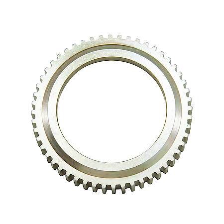

Have you cleaned or inspected the tone ring?
Debris or a crack in this will cause issues. Also be sure the sensor is fully inserted with the correct gap .
