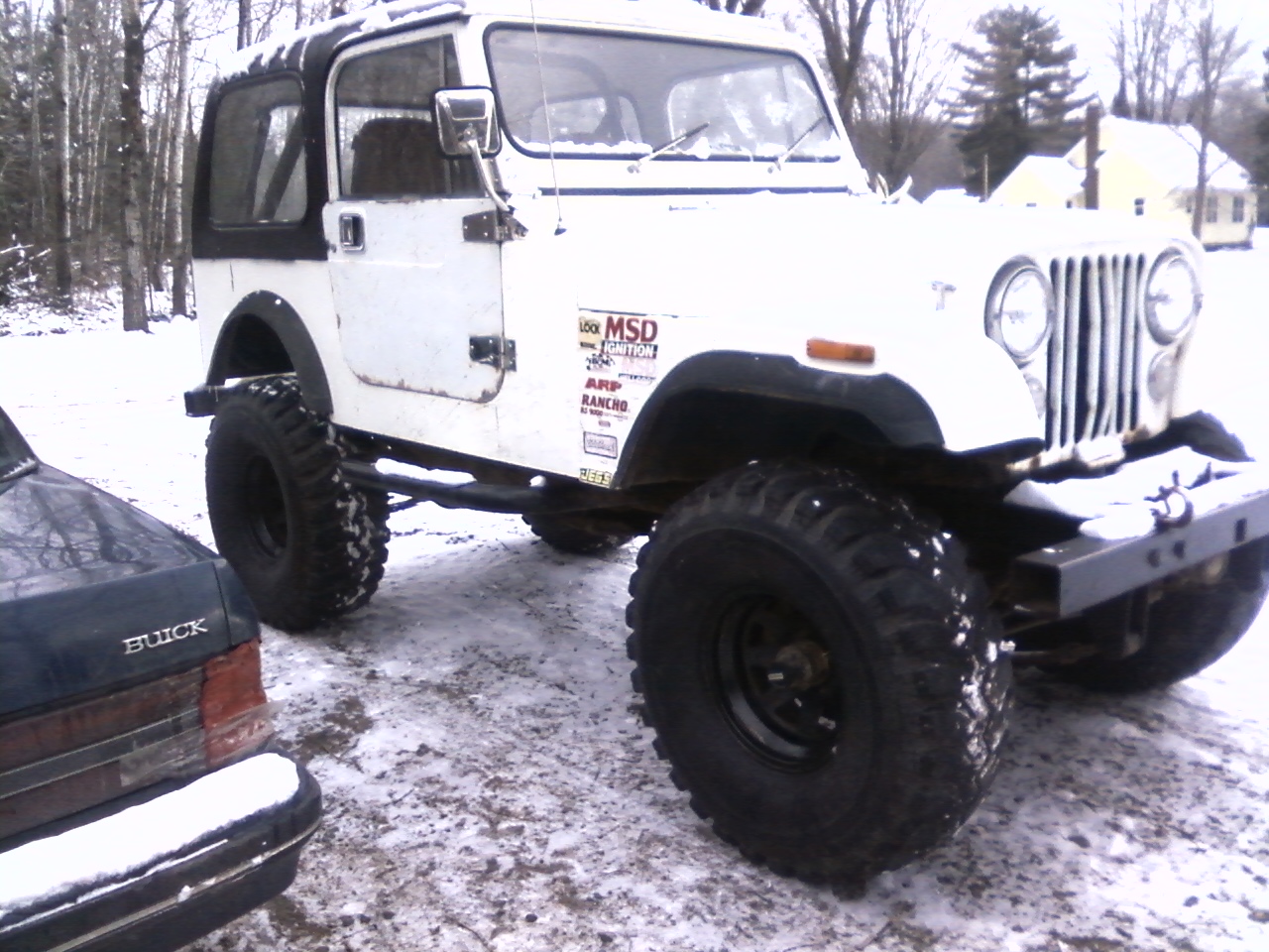

well seeing u said for the average guy with a normal job so im thinking someone that makes min wage i would say a 81 cj-7 (with a good frame) find a used 383 strooker th 350 trans dana 300 transfer case amc 20 rear with lock right locker dana 30 front with lock right loker soa lift 2.5 lift springs rancho 9000 shocks and a used set of 38 ground haugs 3x3 square stock steel bumpers some spare weekends and and some patiance
oh wait thats my jeep all ready lol and this is what ya get for your time and patiance

the 38's have been on therre now for allmost 8 years and havent takein out the 30 yet everyone says that and its still holding up same with the amc 20 in the rear its all on how ya drive it have the power there but know how ta use it!!!!!!
