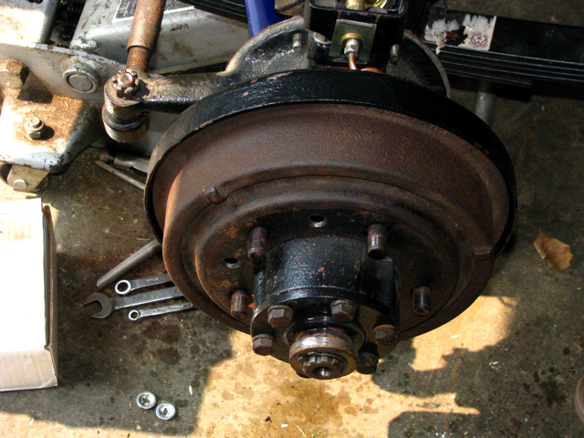

where are the two screws,and do i need to pull the locking hub? I have done brakes on cars before but not 4X4 so i'm have a little promblem here. Thanks for any help
Ohh yeah. Three screws sorry. And no you dont have to touch the hub. The drum goes around it. Here's some pics

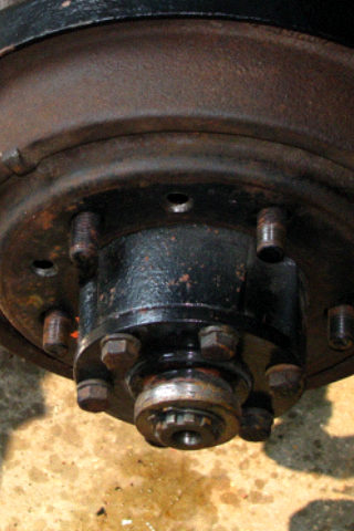

Another closer one.... It shows two of the three.

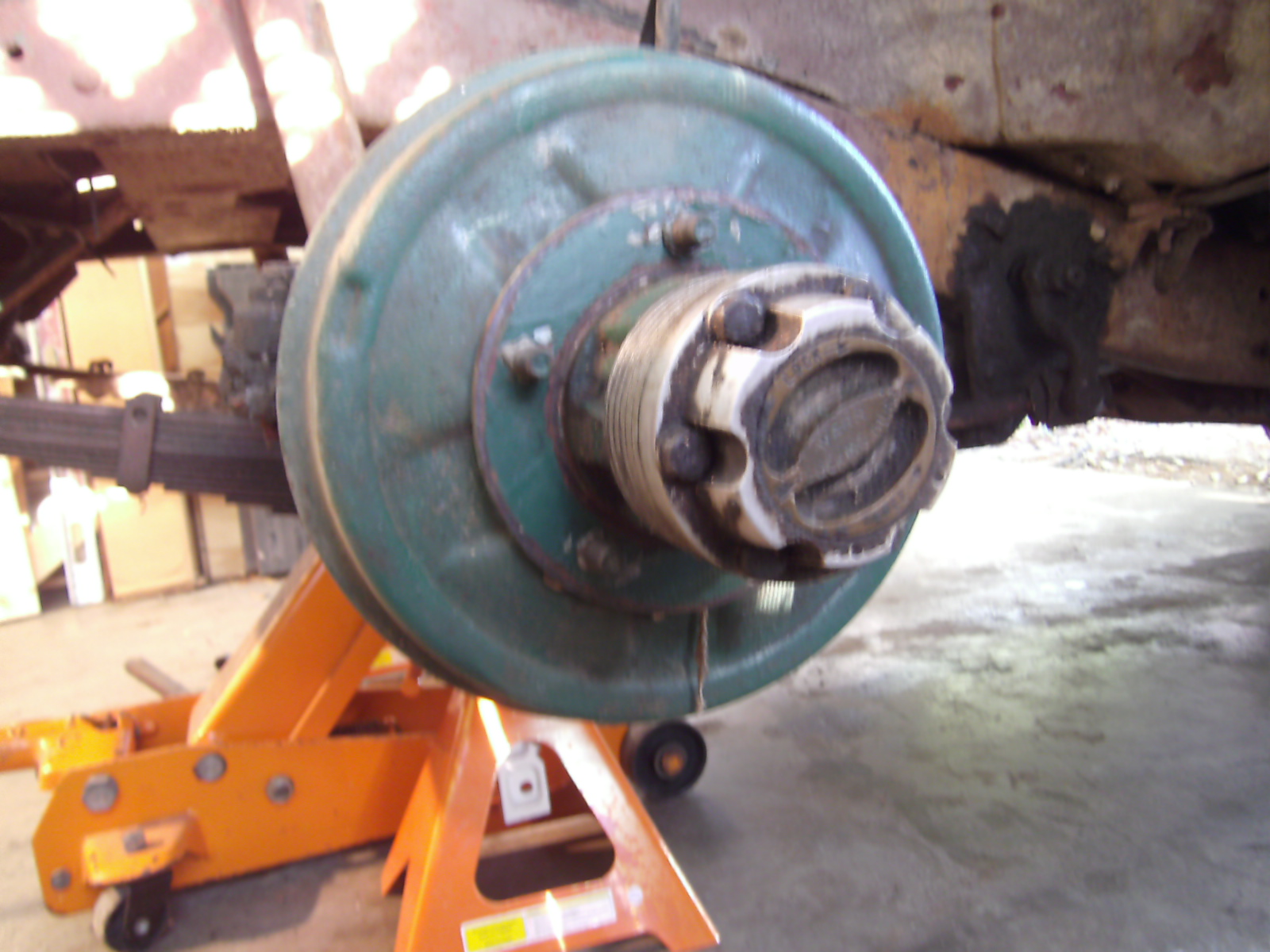

here is a pic of what mine looks like is this showing that my drum is behind my hub? if so what did the guy i got it from do????? if so what do i have to do? I hope the pic comes with this message new to loading pic here
Ok found another pic that show hub/drum like mine. And it states that I do have to pull the locking hub off to get the drum off. Like I said I'm learn, these 4X4 brakes are new to me. Thanks for your information it all helps.

you would need to remove the 6 bolts around the hub,
than remove hub , remove the spindle nut inside drum,and remove the drum

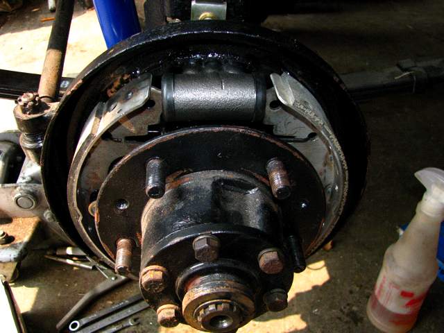

Matt post a good picture of the adjusting cam bolts on the backing plate so he can see them. Manually adjusted brakes are really old school and unless you're old or work on old stuff like me you'll never come across them. They don't even teach them in auto classes anymore. I would post a picture but I am not near either of my CJ2A's
dbjack- after removing those lockout hubs the hub/drum assembly will come off just like a rear wheel drive car front wheel hub. You remove the cotter pin and bearing nuts, remove the outer brg. then slide the assy. off the spindle. The inner brg and spindle seal will remain inside the hub.
Thanks for all the help, I got them off. Already bought all the parts for my brakes so I'm going to stay with the drums. They are 11" drums.
Do you have the cam bolt adjusters to adjust the shoes?
If so I'll post some pics to give you an idea on how to adjust them
