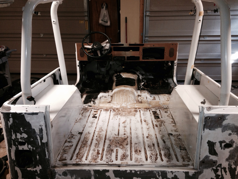

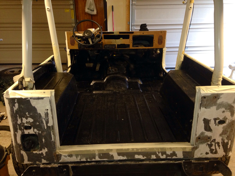

I know this is old, but I'd recommend Monstaliner. UV protected and they have like 30 different colors to choose from. Top notch installation instructions and very easy to use. If you're looking for the long term, I'd recommend them!
Pics of my install:
Pics of my install:

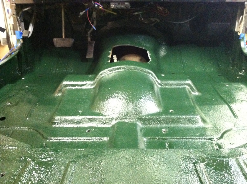

Just finished Herculining my 95 YJ a few weeks ago. Looks great. Cold winter in northern IN in an unheated garage made it difficult but well worth it. Just wished I would have waited till I was done painting exterior so I wouldn't have to mask it up later. Got a gallon kit at autozone foe 80 but they had a 20 dollar mail in rebate. The trick is stirring it about every ten minutes or so to keep it from clumping up in the can. And good ventilation!
