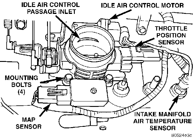

AIS (Air intake sensor)?, that should be on the T. body air intake tube going to the air filter. It's a tiny sensor (2 wire)..

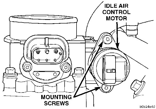

IAC (Idle air Control) is mounted on the side of the Throttle body. the pintle or plunger is possibly stuck.

Well, I cleaned the adapters on the TPS and the IAC Motor and also took off the intake hose cleaned inside the throttle body, opened up the valve and cleaned in there (it was pretty gross).
I put it back togetehr and its running okay now.
My dad dropped me off a new IAC motor and a new TPS just in case that doesnt work. Im heading to school right now ill find out on the way if there are any more problems.
Thanks Steel.
