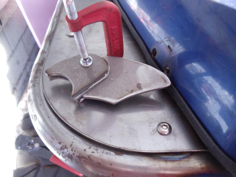

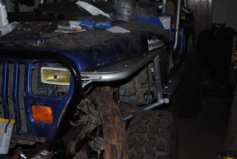

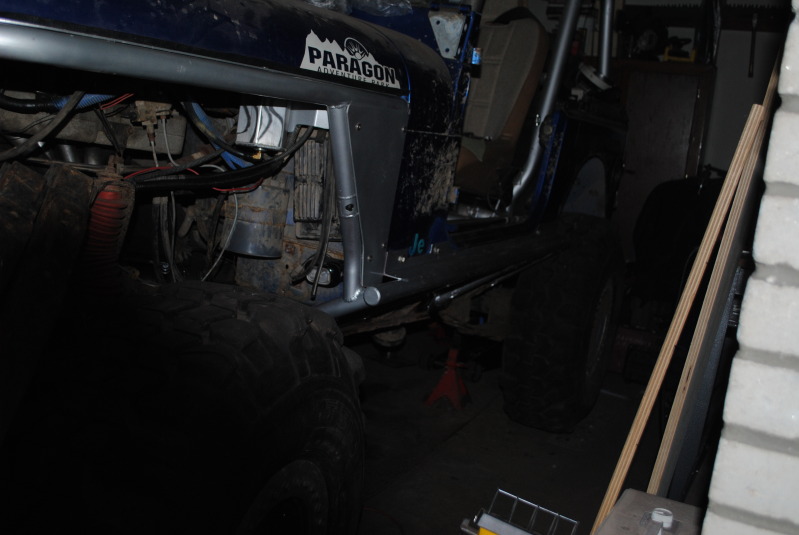

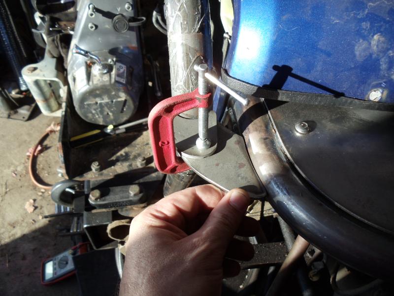

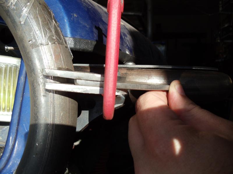

Here are some of the brackets I made today, these are going to tie the fenders into the rad. hoop. I want things to be removable to some extent so that I can keep the jeep somewhat serviceable. for say a motor swap in the near future.
Also got the bars that tie the fenders into the boat sides bent, cut, and notched, didn't fee like pulling the welder out today, So I'll welded all the small things up this week, finish trimming the floor, trimm all the body mounts, measure for the poly, prime and paint this junk.

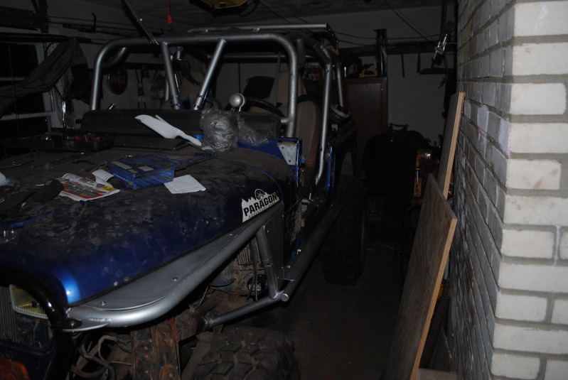

Long Over Due Update

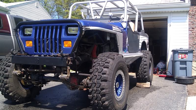

This stage of my jeep is pretty much Done.
I till have to trim back the bod mounts so the Poly sits flush, a little bit of wiring to do and re-pin the BCM, some small here and there's but here is a couple spy shots. 36" tires look very small.. Once I get i running and pulled out of the garage, Iam gonna see how a 42" tire fits with only a 3" lift. front should be no issue, rear will. but I have some new springs to put in the front and I am going to re-drill te rar to stretch the axle back about 2"

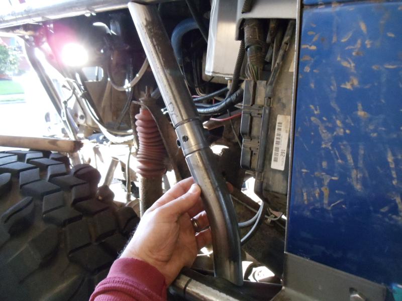

I also finished the exhaust, all made by me using T409 stainless and wrapped in heat tape, it now runs down the drivers side with center exit.
new adustable Oh Sh!t handle for the passenger. I will get more photos what I have time and it is light out.
enjoy.

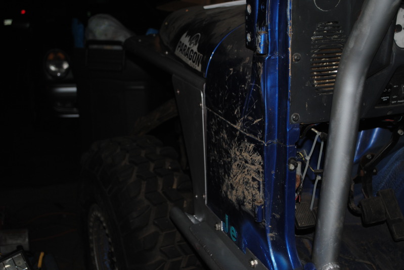

I need to update this, the boat sides are done.
This weekend I did a ghetto stretch on the fron axle, about 2" stretch by redrilling the center pin in some used 3" RE military wrap springs that I got for a song from someone. after I got everything in, I am getting contact between the pitman arm and the tierod. I already moved the steering box forward a couple years ago to clear the hi-steer, so I am trying to find a pitman arm that is a little flatter and a little shorter. I seam to be able to find flatter ones, but I also need a shorter one. I was runninga stock YJ pitman arm that I re-tapered to fit a 1 ton large taper chevy TRE, center to center it is about 5.5 inches. Partsmike has recently started selling a flat un-drilled pitman arm that will fit 32 spline saganaw boxes. the arm is undriled so I can have my length at about 7" down to 5.25 so when I get home, I am going to measure to make sure the flat arm does not contact the frame at all, then I will probably pull the trigger on the arm.
with only 3" springs and the 2" front stretch and hi-line fenders, the 36" tsl look small, I might finish the season with them and then see if I can trade away these for some 39" iroks. Kinda unsure since I still have the 1 tons to go in and have a goal of 42" tires on 4 inches of lift, so unless I can get an even swap on tires (and Q78's are pretty desirable now that they are not making them right now and/or are hard to get)

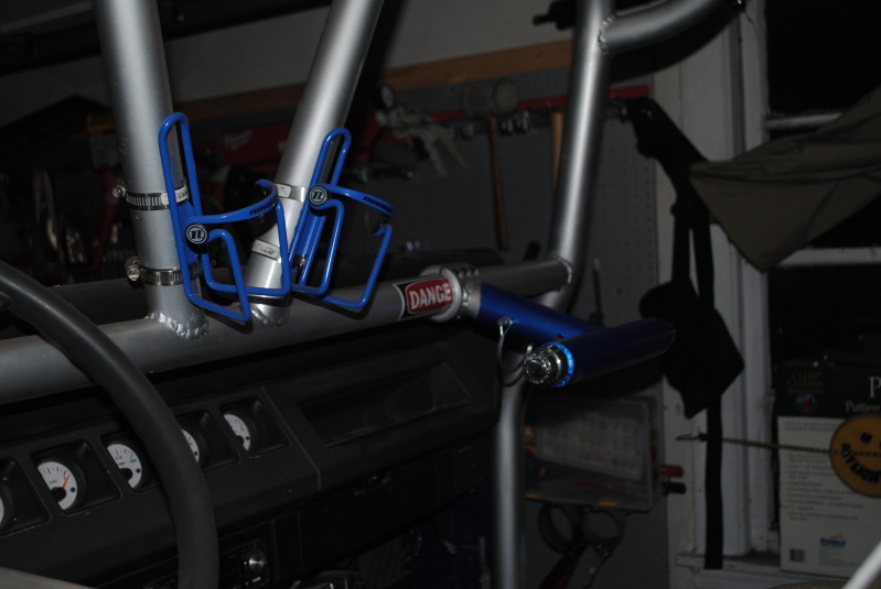

are those cup holders
Yup, bottle holders. I wanted to have something since I do not have a center console, and I wanted something that will hold my beverages incase of a rollover. at $3 per cage, couldn't beat the price. i will eventually drill and tap them into the cage, but fornow the hose clamps work.

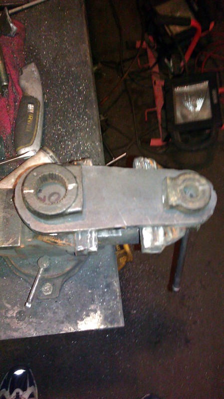

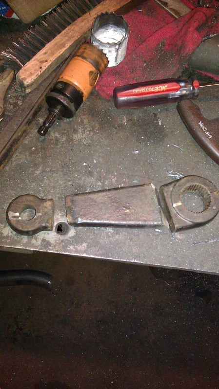

Well, quick update, I can't locate a pitman arm with the specs I want.. flat, fits a saganaw box, and about 5-5.25" from center to center and enough material to be bored out for 1 ton GM TRE. so... I'm making my own. I was gonna start it last night, but it was too damn cold to be out in the shop, so Thursday I plan on starting the pitman arm work. I'll take pics if I remember.

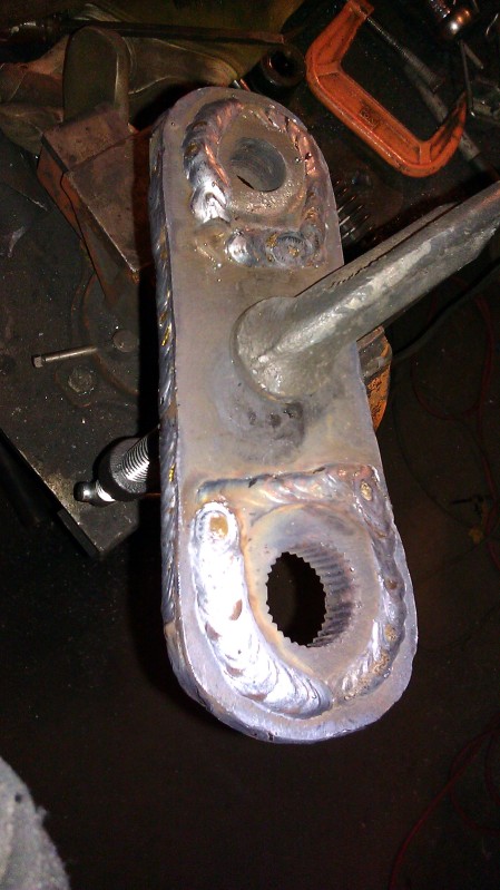

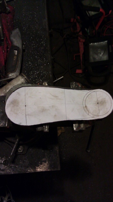

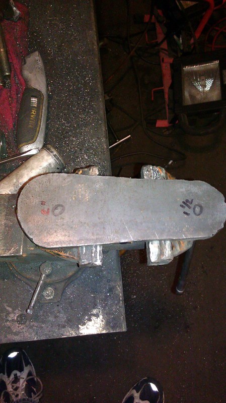

Long over due for an update. I ended up making my own pitman arm. basically I took the factory arm that was on the jeep and cut the "drop" part out of the arm so I was left with the two ends. (obviously I marked the two ends since they are both tapered for a uni-directional fit) I left a small portion of the arm on the spherical portion to act as a sort of Keyway.
Then I made a paper templet of the new dimentions of the pitman arm, transfered to some 1/4" steel and plasm cut out two pieces. I tack welded the two pieces together and drilled the holes I needed to fit the parts from teh original pitman arm. I used a 1.5" hole saw and a 2" hole sam, then I used a plasma to cut out the keyway parts (sorry, forgot to take a pic)

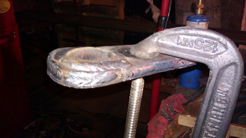

I broke the two flat pieces apart. the factory pitman arm portions had small tapers to the center plane of the arm, I fit one of my fabbed up pieces on the top and one on the bottom, slightly opening up the holes with a carbide ream until they fit pretty snugg and with about 1/16 of an inch of seperation between the two. then I started to weld them up. and here a couple pics of them welded up. I took time to stitch weld them as to not distort the taper for the steering box end, if those splines got distorted at all, it would not fit the gear box.
I put it on the jeep and turned lock to lock with out issue and have about 1/8" clearence between the tie rod and drag link which is fine with me.

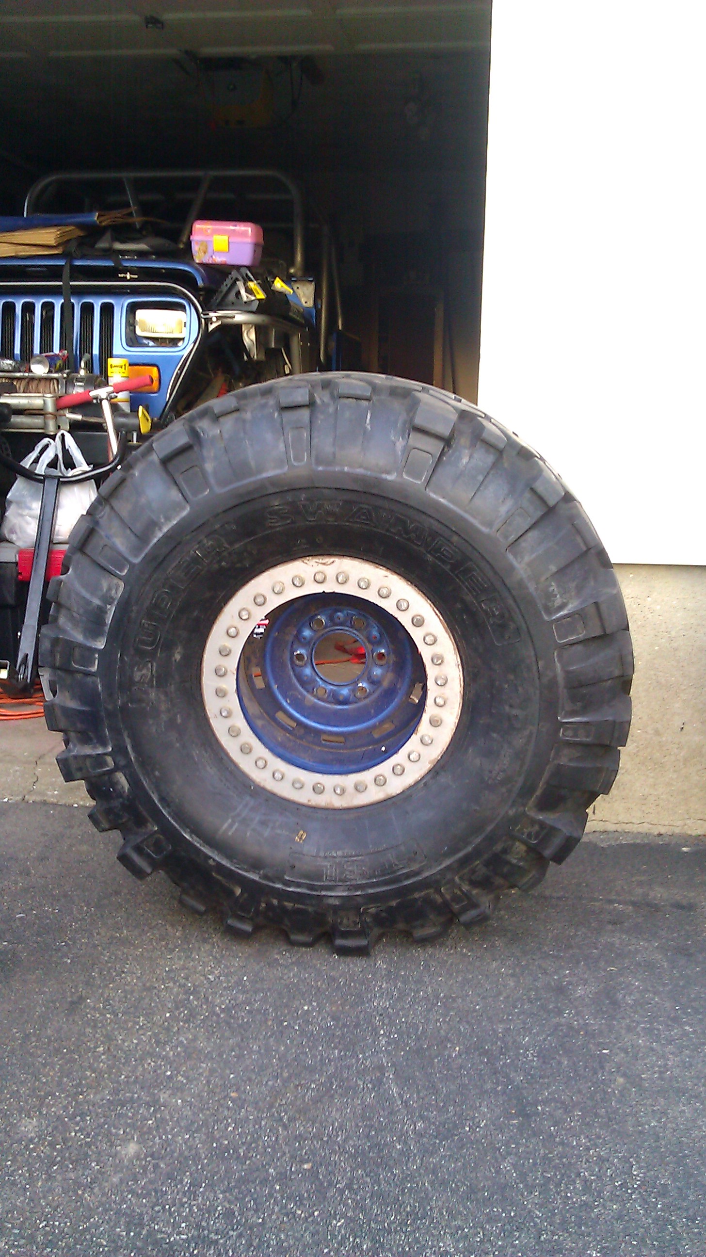

I have a couple pics, the jeep I think the last trip out, the 39.5" tsl's and my pick up before and after.
