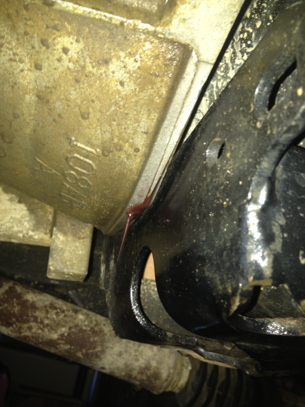

Still leaking. From when I turn the ignition until it is warm. I assume the heat is sealing the leak. I notice no difference in shifting and I am getting better gas mileage since adding Lucas (lol). Caught ATF mid drip in the pic.

Your comments are welcome as we know you meant it with love . We also know you have a degree in wrenching and would not try to treat you like someone who walks into a shop clueless but carries a big pocketbook full of cash either . That being unnecessarily said , it is fortunate if your jeep has an optional auxiliary trans cooler to help keep temperatures down when level drops . This is a concern since the cooler lines are also routed through the radiater . When trans fluid temperature raises to higher than normal , it cooks the engine coolant which is not helpful and the tank the trans fluid passes through which are commonly brass will soon fail as its solder joints will begin leaking. This won't do your radiator and engine any favors either. Not to expand on old war stories , but a friend was urged to do something about his trans problem on a '93olds delta 88 and sat on it too long. The damage was severe overheating from trans fluid mixing with coolant . Trans fluid by design holds in heat to a specified rating for what application to aid friction surface on internal clutch facing material. We ended up pulling the cylinder heads off to check for cracks and warpage , reassembled with new gaskets after flushing block with a friggin' pressure wash ! Yeah , it got ugly ! New radiator , not so new trans and misc. items incurred to a total of OVER $1000 over a period of months on our backs . I know you are stressing over this as anyone would righteously so , I totally forgive your fading patience but I regret there is only one cure , I won't repeat but its to spend money. From my experience , this can and has happened and I wish it on no one . I deeply regret the need for a financial procurement , but I trust you own a really nice vehicle or else you would not be considering an expensive proposition as trans replacement. I am wishing the best for you with the knowledge of past calamities , the delta 88 , mom and dads 2000 GC and maybe others too distant to remember. Again , I do not enjoy being the bearer of bad news , but the only happy ending in this tale of red trails is replacement. I pray there is a truly reputable shop that offers quality replacement. Hate to just leave you with my best wishes knowing the the truth not only hurts , IT SUCKS ! I only know how to fix something right or not at all which costs people money, I regret . If anyone has a better suggestion of cheaper , viable solution , I will always listen with respect .
Am I understanding from greg92jeepxj that you think I need to replace the trans? You don't think replacing the front seal to stop this leak should be my next step?
Let me not speak too fast , from the experience mom and dad went through , they bought second hand a 2000 jeep grand cherokee that was GORGEOUS . Then my brother changed trans fluid well after the purchase . Sometime after that , the leak surfaced . Yes , Lucas or something else was in the trans prior , but not after the fluid change . Then the symtoms , codes and engine temp rising. My dad said " ok , I'll follow the guys advice " and changed trans. The guy did right with a '95 pathfinder , so my dad trusted him. It worked out to this day . The shop owner said that the trans has to come don anyway , that's labor , and you want to trust seal replacement on a vehicle you know little history ? He showed my dad how many jeeps with that trans had that history . Enough said. I guess I should ask more jeep owners of your model of search that trans and that year if is a common problem close enough to get this kind of forum attention .
I can only say , I hate to see you spend the money for a seal job and have it backfire. Lets tread carefully before proceeding how other jeeps of your year and model fared. I want to be sure too . I don't want to make you spend money on half a glass . I have only the previously posted experiences to speak of but I respect its your money and time that I am potentially spending.

The leak is getting worse. Started keeping a drain pan under him when i parked. I finally folded. He's in the shop getting a new front seal.
It is our highest hopes that a replacement seal does justice to this leak , which now is of magnitude . The expense has gotten to the point where this repair HAD BETTER work by the owners personal feelings. We of course hope to see soonest a good report to the owners satisfaction . Heaven forbid that there is the need for attention in the future with regards to this model transmission for this vehicle or any other member(or non-member) ,
