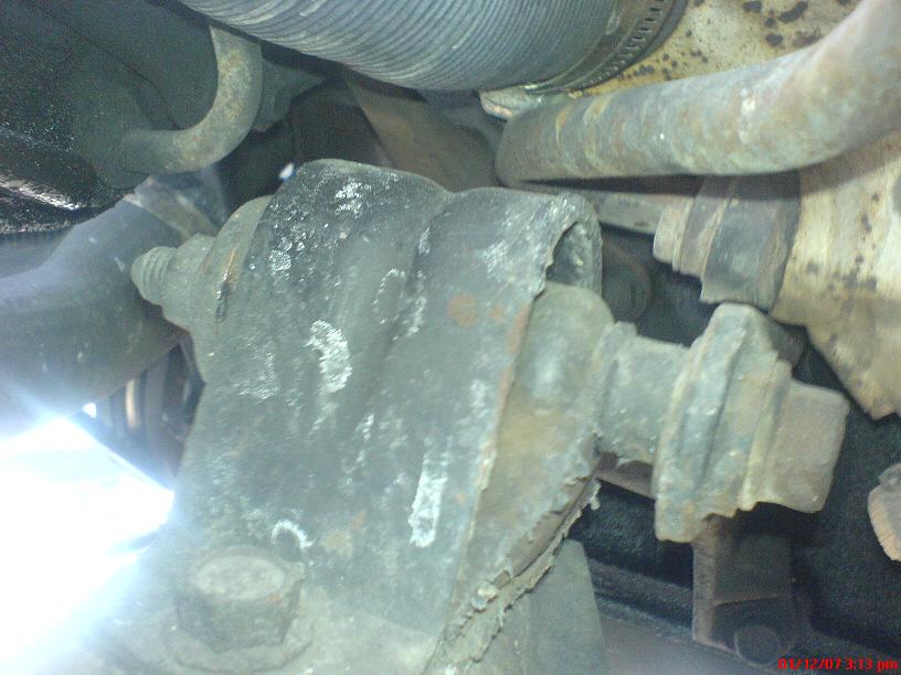

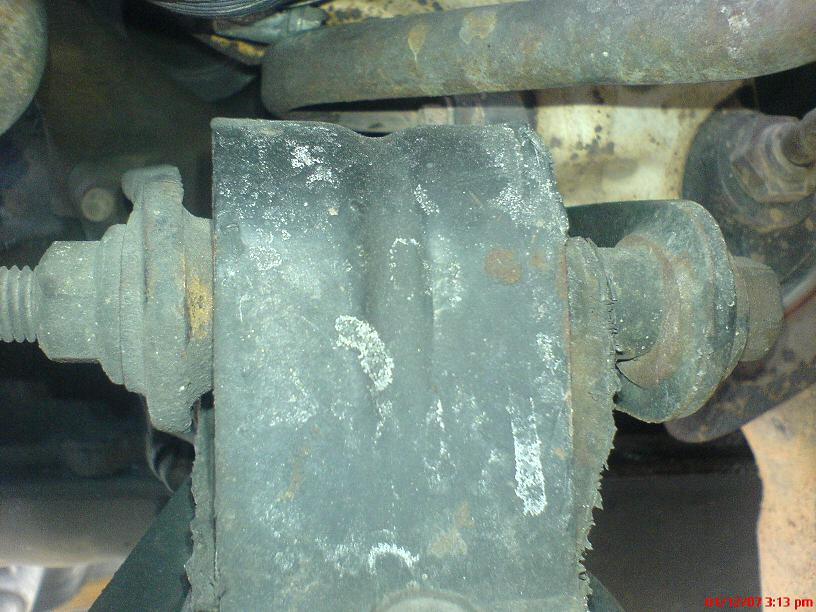

This is what the passanger side looks like......... And is the one making contact:-| :( :( :( :(

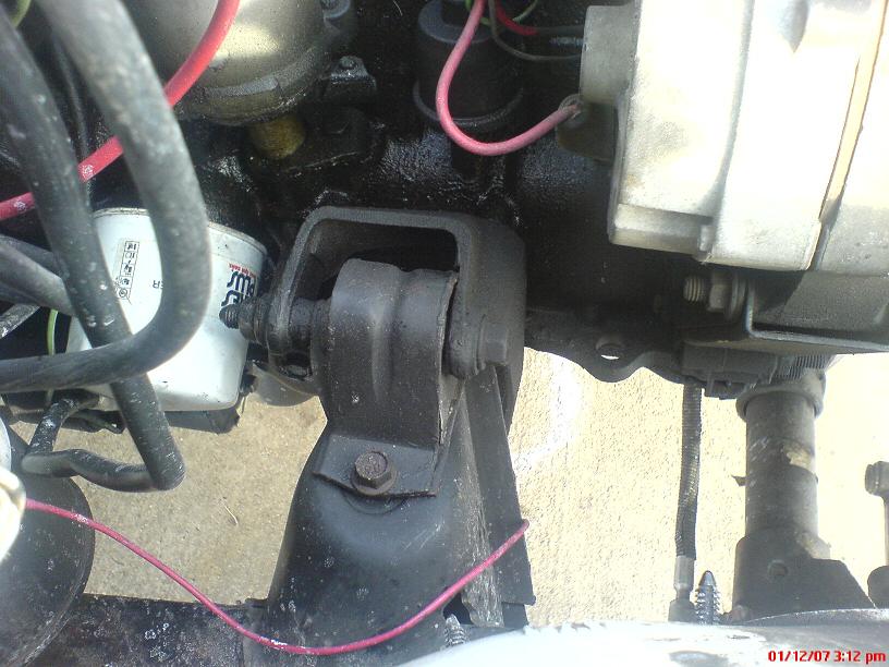

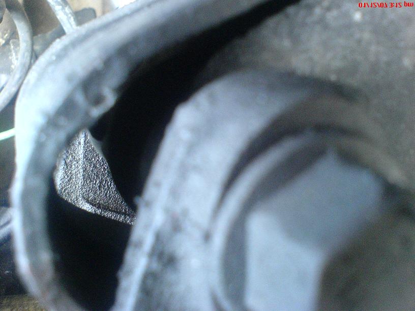

Here is the drivers side

looking at both mounts - it seems that one is poking out the front and the other from the rear - twisted - so the t-case loosening exercise should help correct that - and as for the t-case drop - unless your planning on a slip yoke eliminator /cv shaft upgrade - you need the drop to help with the extreme driveline angles from the lift / short driveshaft combination.... without it you get vibrations you dont want and lots of experience doing u-joint repairs you dont need... g'luck and let us know...
