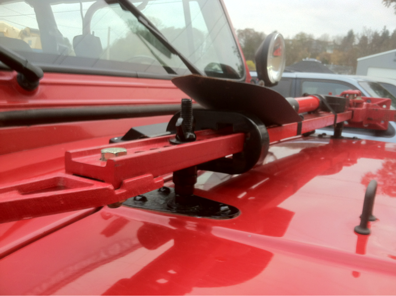

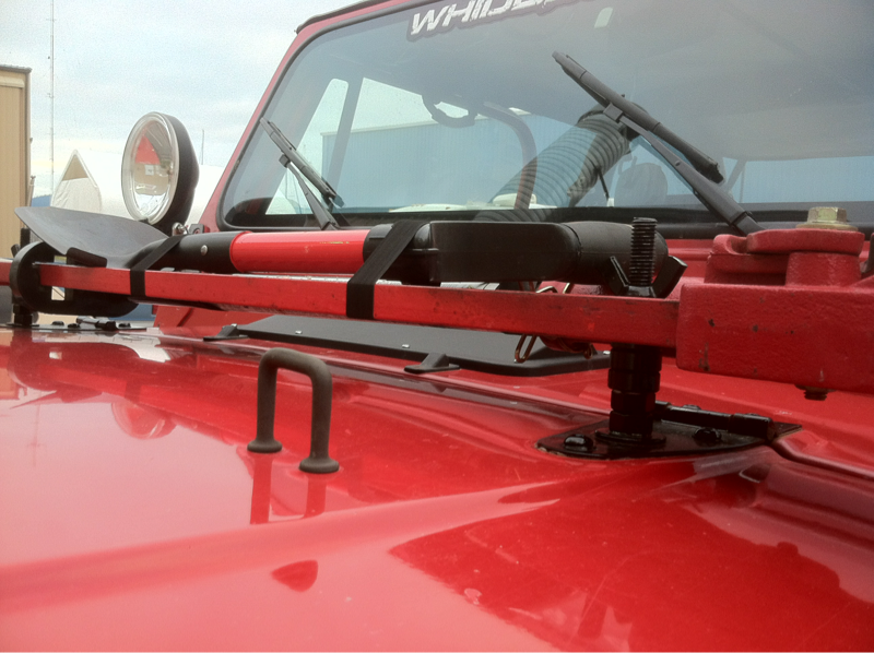

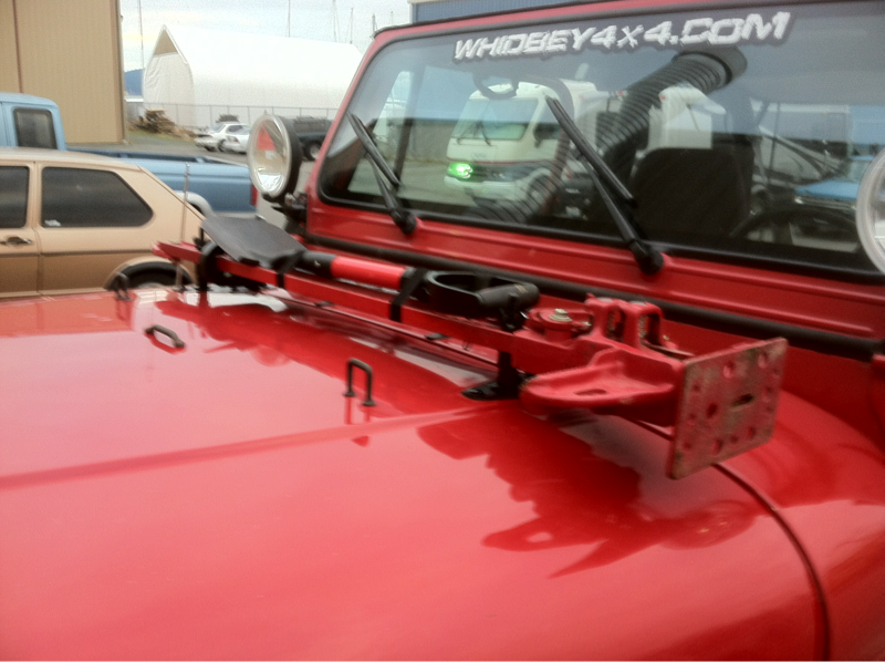

I have my mounted on the hood and have't had any problems with it rusting just need to lube it up every once in a while!

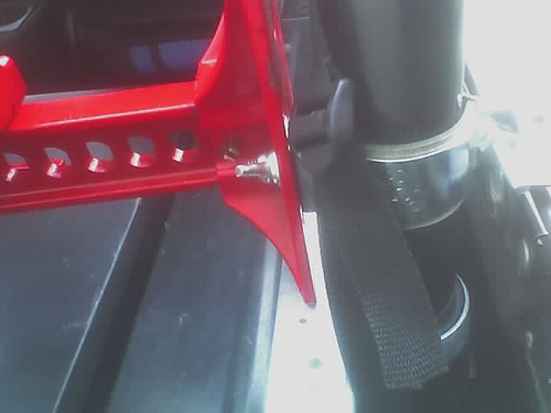

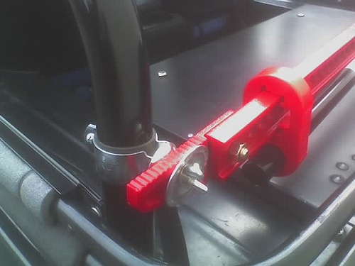

I mounted mine inside between the roll cage downtubes using cyclone fence hardware for about $8.00. The Cobra (Hail Corbra!) lock was about another $20. Not a rattle out of this since last year.
I did pretty much the same on mine... You can see pics in the link Terry posted.

Sorry, my email didn't report a new post to this thread. By now you've liely found what you're looking for. I don't recall exactly what the nomenclature of these parts were but basically there were two brackets that fit around the roll cage with room for a rubber gasket to hold fast. Also I used a flat "L" bracet to support the jack mechanism's heavy end much like a shelf.

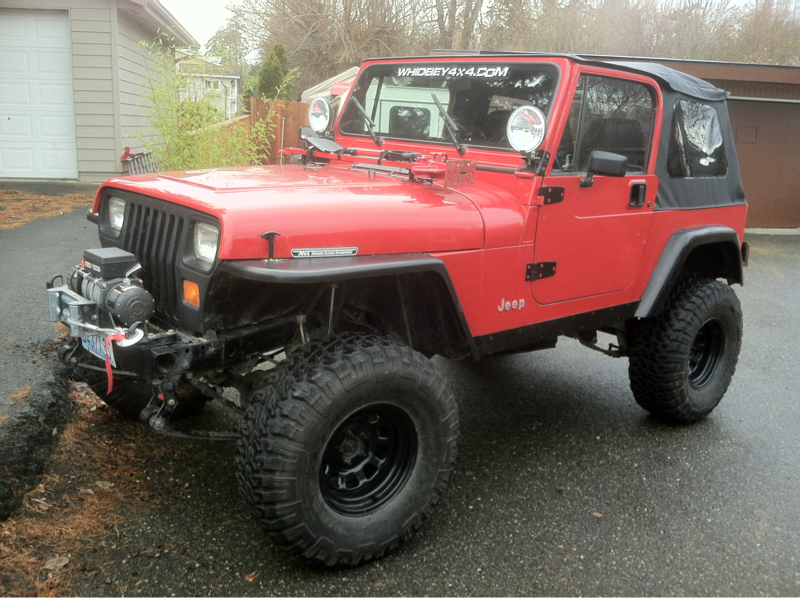

Lol its all good, I had bought a toys by troy front bumber, it came with a front hi lift mount so that's where I have it now,
