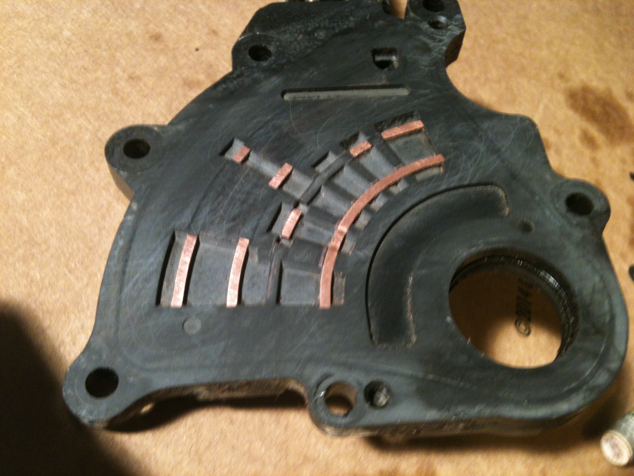

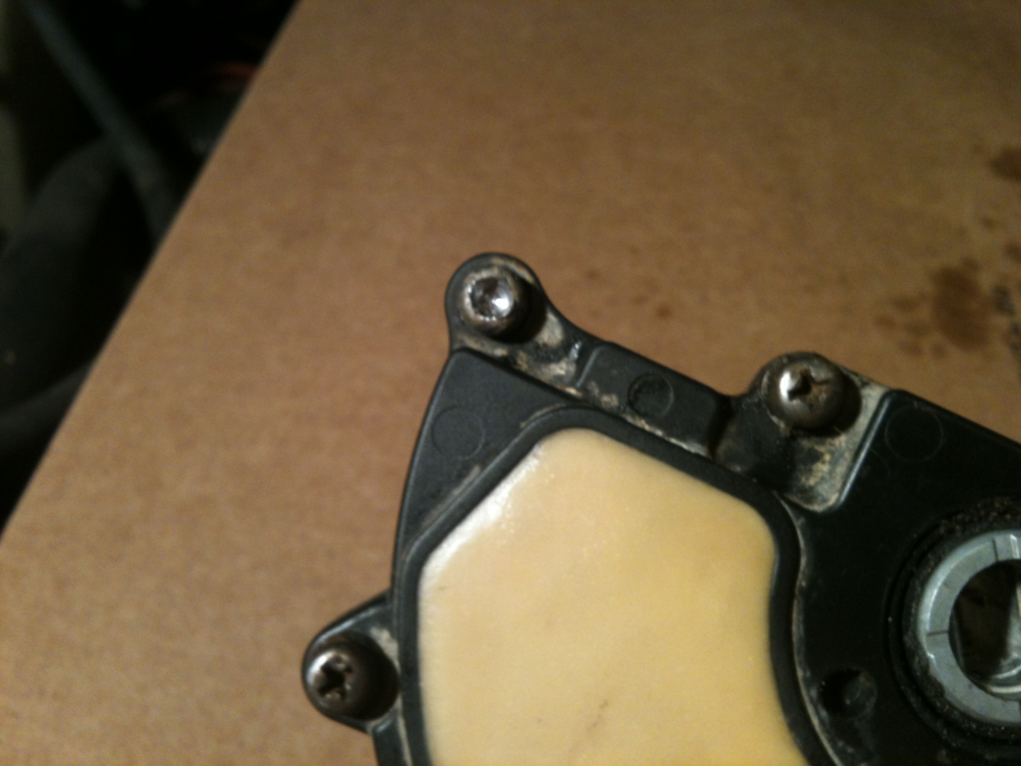

So I took apart the NSS, stripping out one of the screw heads in the process, BTW. Oh, joy! There was some buildup of crud at one end of the copper runs in the plastic side of the NSS housing. It was enough to obscure the copper from view. So if I am guessing right about the orientation of the gear shift to the NSS, that crudded up end may be the Park end of the armature arc. So that build-up might explain a failure to start in Park. But the region that I surmise would then be the Neutral region of the armature arc looked to be relatively clear of crud. But since I could not get the Jeep to start in Neutral, I am guessing that the NSS may not be the problem and I may be back to the starter as Greg suspects.

Also, is that recess in the innermost copper strip normal? The other strips have gaps in them, but there is a definite recess in that strip that you can see in the picture. So why is the copper recessed there instead of the strip broken? Just seems odd to me.

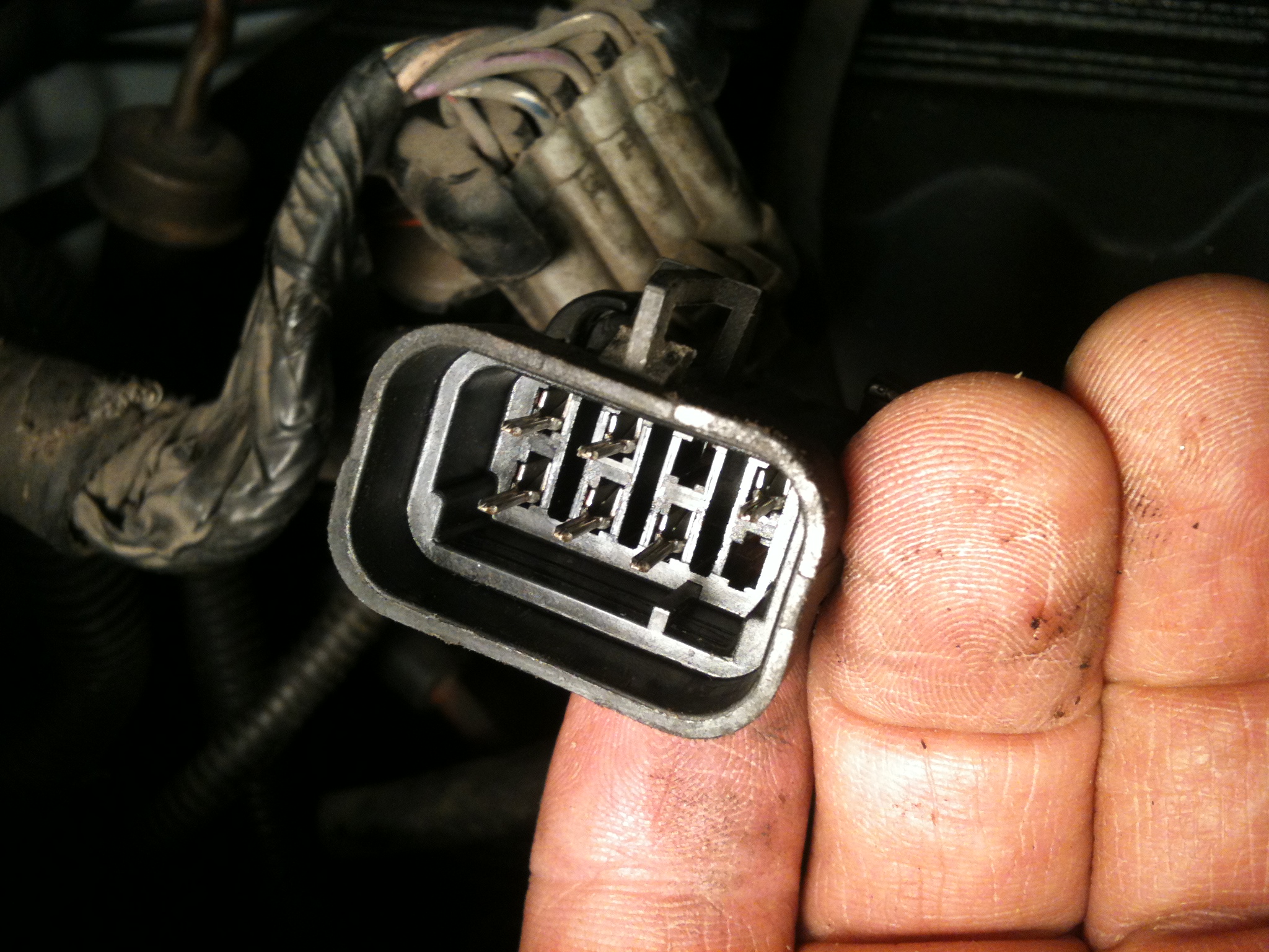

So on my Jeep the engine side of the NSS harness is a male connector rather than female, so I will need to attach a lead across pins rather than use a paperclip inserted into sockets. Does anyone know which pins I need to bridge to bypass the NSS? There are 6 pins across 8 sockets - a top row and bottom row of 4 sockets each. Counting top left to bottom right, pins are absent in the #3 and #8 sockets.

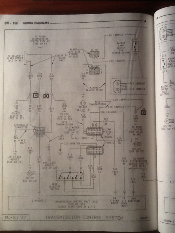

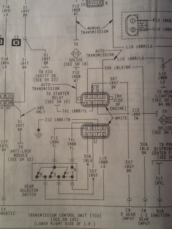

image-3662673174.jpg image-1527298396.jpg Hey James , took these ipad shots from my 1992 factory service manual . It should give you a good idea for a bypass for testing your starter . I agree that before you go out and get a starter that you know you can at least get the solenoid wire to go live when you turn the key to crank. That is certainly first to do. We'll deal with the NSS once the starter issue is done. I know your jeep is a '94 but I'm hoping the wiring code carries to that year . My guess is that it will . At least the diagram(s) will give insight to what wires perform what function. You can verify operation with the ohm function of your meter on the NSS itself by figuring which wires at what terminals have continuity so you can figure what female terminals to jump on the engine harness side. Please make proper jumpers using solderless terminals that fit comfortably without spreading the connectors and causing problems later when you'll want to get the NSS up and running again . You'll need just one wire and two proper fitting solderless terminal connectors crimped onto the short section of wire just to make a proper jumper for this test . Once it is proven that the solenoid wire goes live when key is cranked , that issue is solved and we can send you to the parts store for a replacement starter. Let's get that in the works and we'll see if the NSS can be salvaged. The stripped screw is the least , the inner terminal strips look ok and can be regreased but am worried about the adjustment nut you held up in the photo that the selector shaft goes through and turns. If you want to get all the spring contacts working again so the switch functions and can work in park position just to get the solenoid wire live for test purposes , that may be better for you as you can plug it back in from under the hood and save more scraped and busted knuckles and less vocal venting for the neighbors ( I am somewhat practiced at that , but I try to keep it to myself. I know the feeling , years of experience at that) . Let us know your feelings on what you'll precede with next , be safe and methodical. If your not certain of a connection and fear shorting and damaging , post us back before so. Hope this helps . Greg

So if I am reading the diagram correctly, a lead across B and C would allow any circuit testing which would involve the NSS to proceed as if the NSS were connected and working and the car in Park/Neutral.
Do I have that right?
I believe that is correct being terminal "C" is a ground and "B" is neutral and I believe "A" is park but not clear in the illustration . If you can give it a try on the NSS while it's off the jeep and see if the re is continuity , meaning the ability of voltage to flow through , Between A and B or C , with the switch physically in park or neutral then that will confirm those are the terminals we need and those are the wires to match on the female plug on the engine side of the harness.
Jumping will be a fast way but if your more comfortable with the switch plugged back in since it's more native and safe electrically , that may be best. We just want to be able to ultimately read voltage at the solenoid wire with your meter when cranking key.

I didn't test for continuity using those corresponding sockets on the NSS side of the plug, but that's a great idea. I trusted the diagram and jumped the B and C with my lead. Interestingly though, the plug on the engine side is the male side in my Jeep. But every picture/video I have seen has the female on the engine side. Kinda odd.
I assume it worked based on the fact that I was able to get readings at the solenoid and starter when turning the key. Those findings are in the other thread.
Thanks for your post . I guess we"ll be working out what to do about the current statue of the NSS and its state in regards to re-installation ( if that will be a problem?) or possibly a replacement ? But I guess we can safely say since there is a reading from the solenoid wire with the key in crank position with the NSS in its PARK position that the fault will be with the starter . Whether that's because of a bad solenoid or starter motor issues such as bad windings on the armature or bad brushes , this will most likely necessitate a whole starter replacement. In the past , it was sometime practical to replace a solenoid such as on a GM style starter since the GM starter motors were once held in high regard but I'm not certain that true of this starter we find on the 4.0 liter. I don't remember if a solenoid was readily available for it or not but it seem to remember I came to the conclusion it was just simpler to,replace the entire starter in all respects. Mine was pricey but had no control over that at the time. Hurricane Sandy saw to that . Wishing you better luck on your price .
