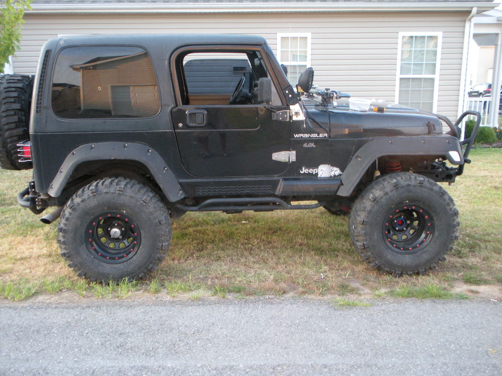

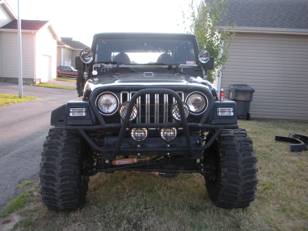

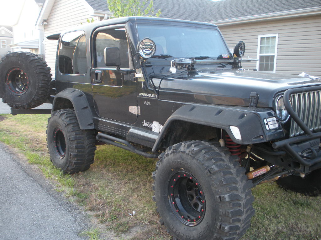

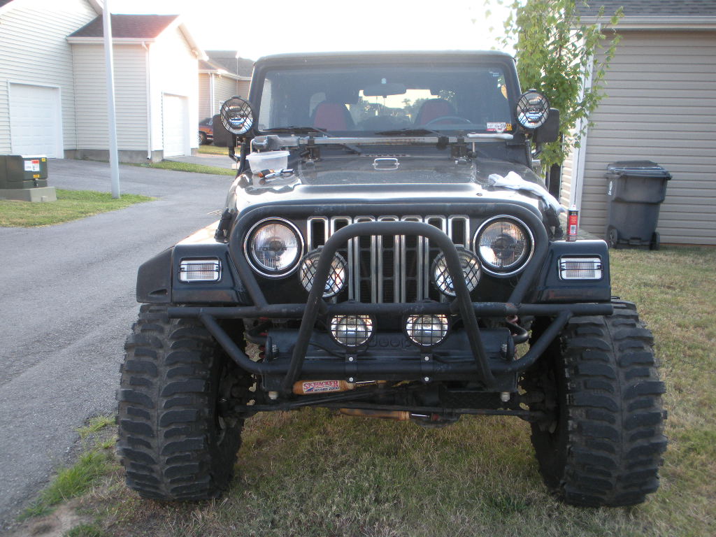

I think it is worth 10K. Its a lil more than blue book but It looks like theres at least $5K just in Hop-Ups on it.
I added up just the stuff I could see and It came out at $6000 in upgrades. I even low-balled some options. If it was wheeled really hard though, You may be making repairs as you go though. Still a bad ass Jeep. Hope your single, If not, your wife may need to be in the jeep with you at all times. These things are a magnet
