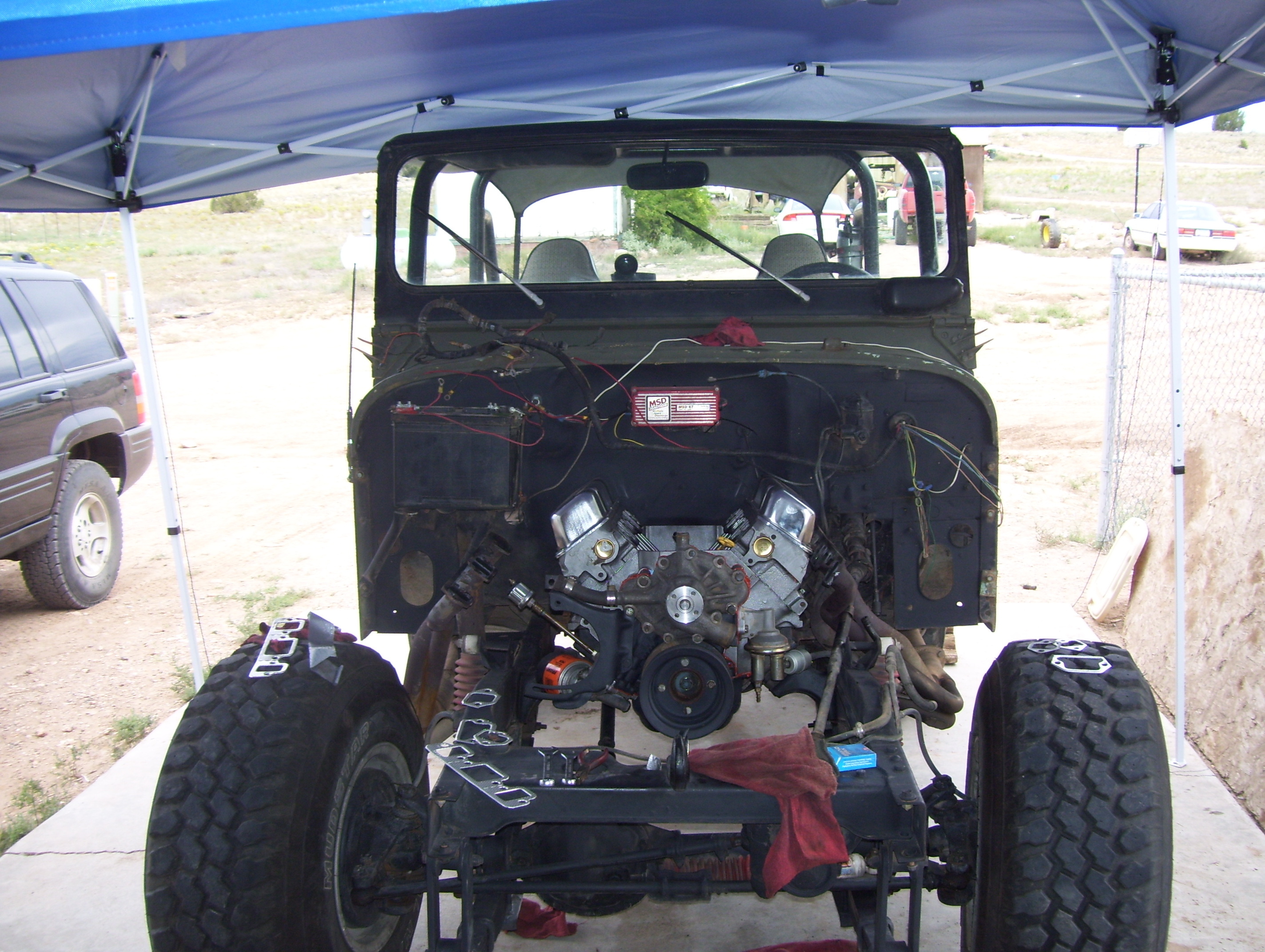

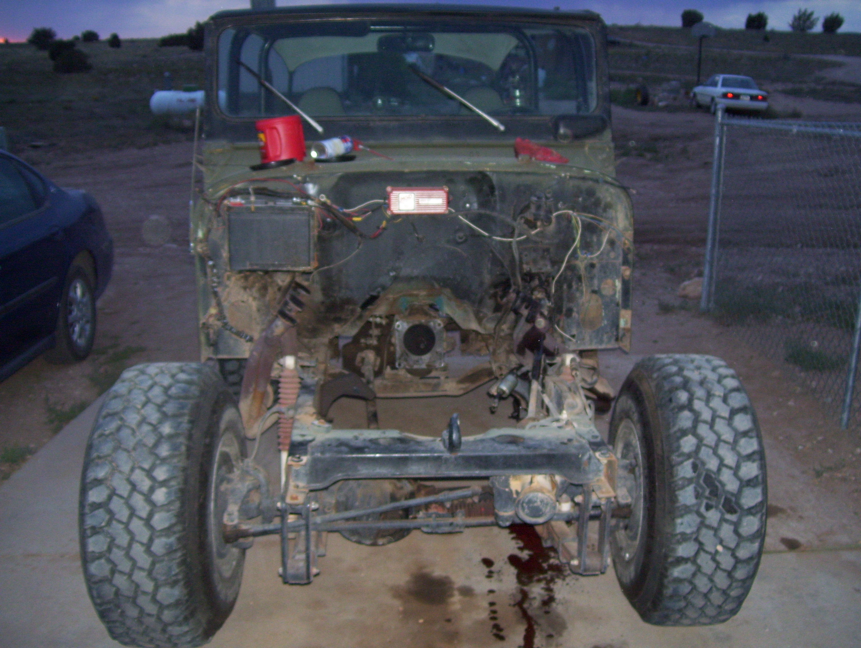

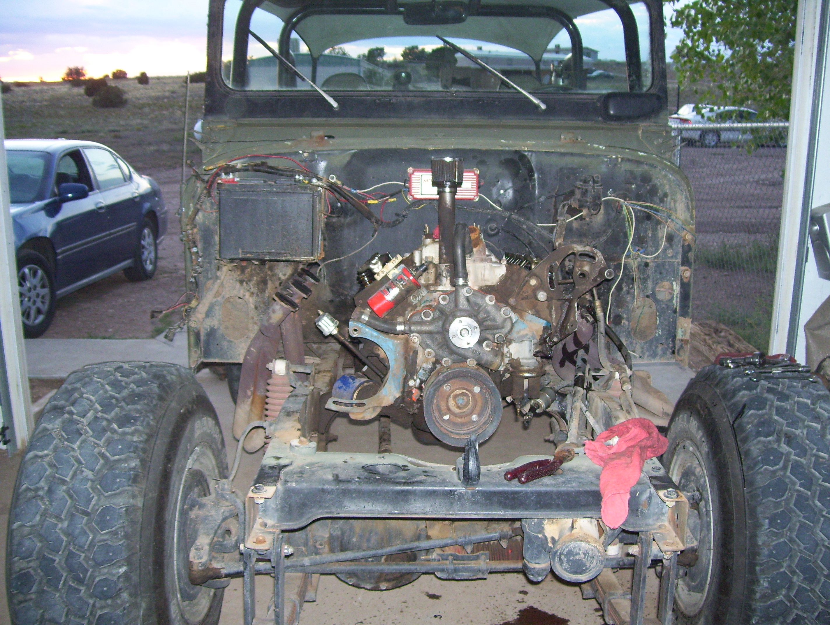

it's out now time to get busy..

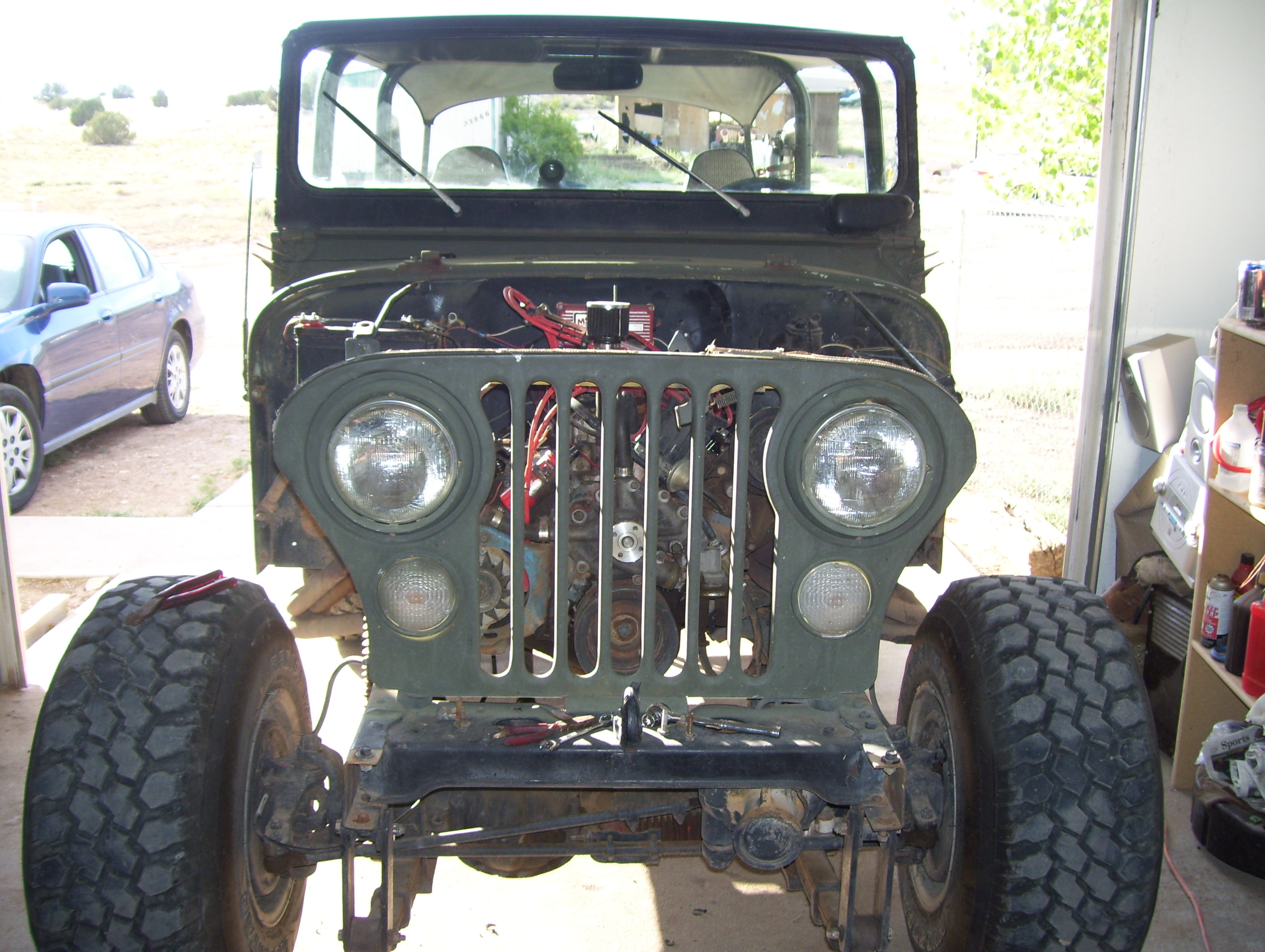

Nice! I'm rebuilding mine with 4.0L pistons to make it 10.5:1 compression for LPG, but that's a year or so from now. It ran well before I rolled my '73 J4000 and seemed okay after rolling it back. (It's going into my '82 Jeep J10 Honcho stepside with a 5 speed)
Tracy-
Nice to see pictures but I’m a little concerned about the long shackles on the front leaf springs; any troubles with the steering being sloppy?
Saddle Tramp,
Actually the steering is not bad. but i will be changing the shackles soon I did get my new motor in and running.
