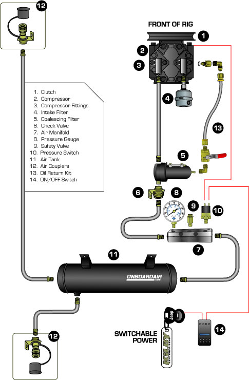

::Kilby Enterprises:: .So basicaly this would be a set up for a york compresser? And kilby do they have a web site?
I'm skeptical of the oil return setup as you're introducing a LOT of moisture into the crankcase of the york compressor.
