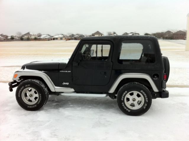

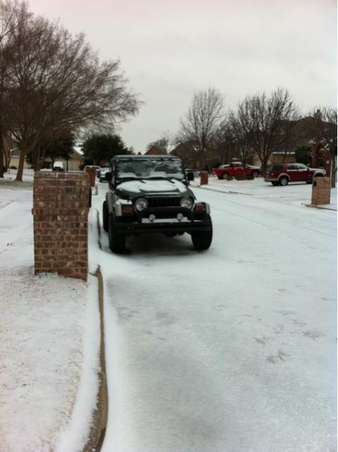

So happy with how the jeep did in the snow and ice, there were a ton of people slipping and sliding around, saw an FJ slide off the road into the curb haha. Threw it in 4 high and had some fun while everyone else was slippin and sliding ;) not too much snow, but a ton of ice everywhere.
