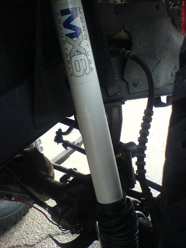

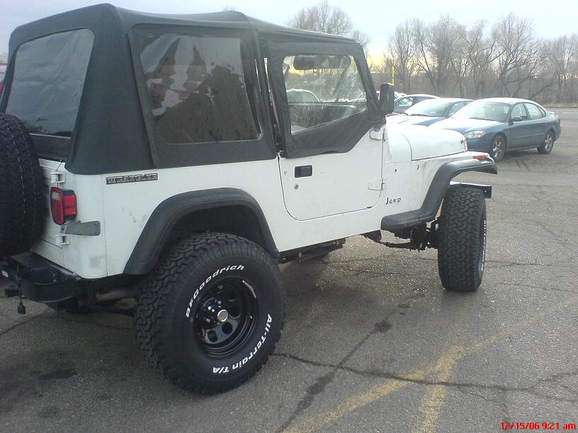

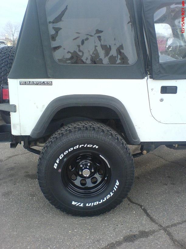

here are the recent pics of the kit I put on last week:purple: :purple:
