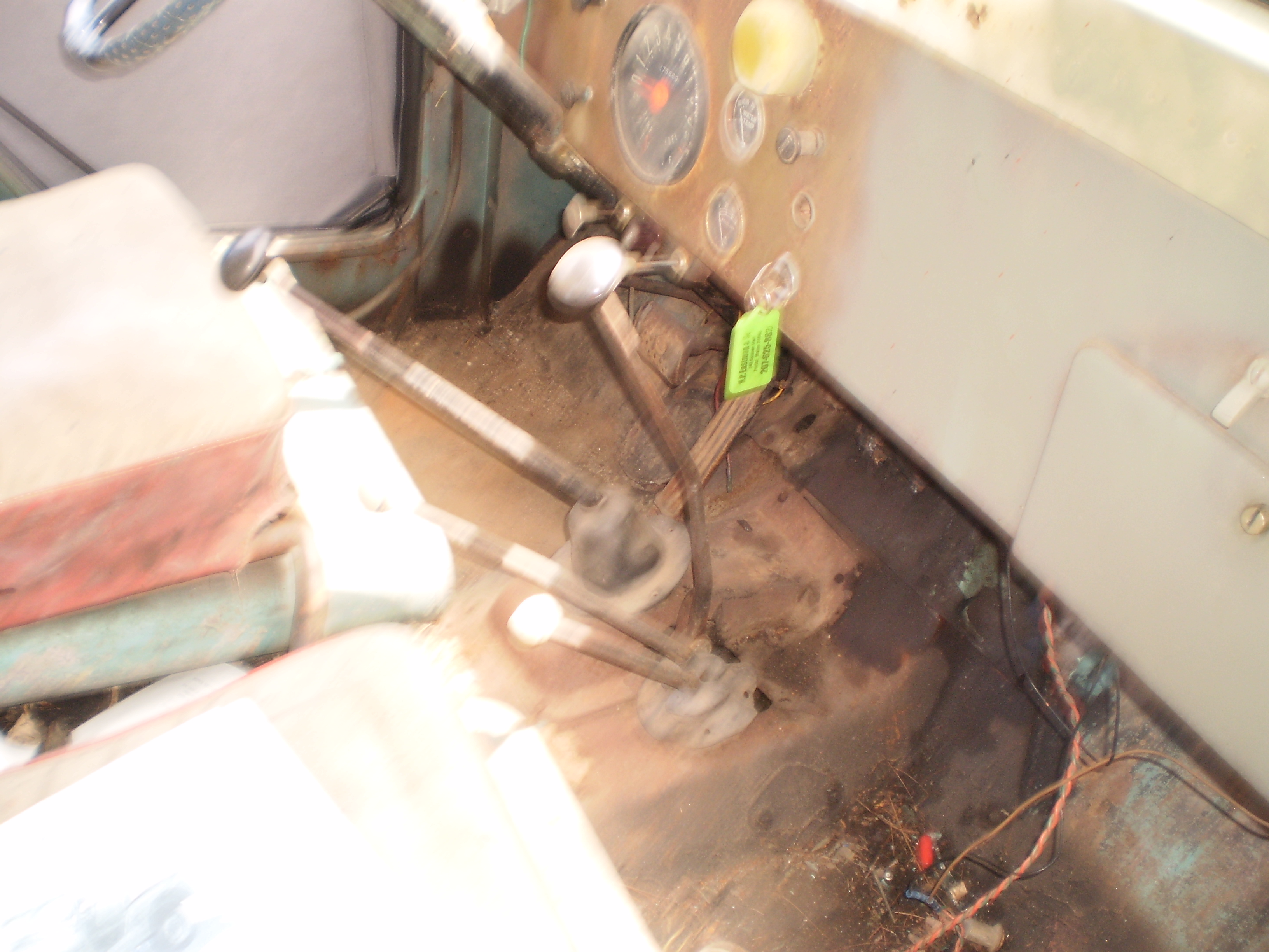

1960 CJ5 Willy's
Put the Old Girl out beside the road Porter Maine.

She don't look SO bad for her age , maybe she shouldn't be traded in for a new model . I see she's got PTO ! Find her a nice home that someone will fix her up and not run her into the ground. I got a soft spot for CJ's , wish I had the means to rescue her.

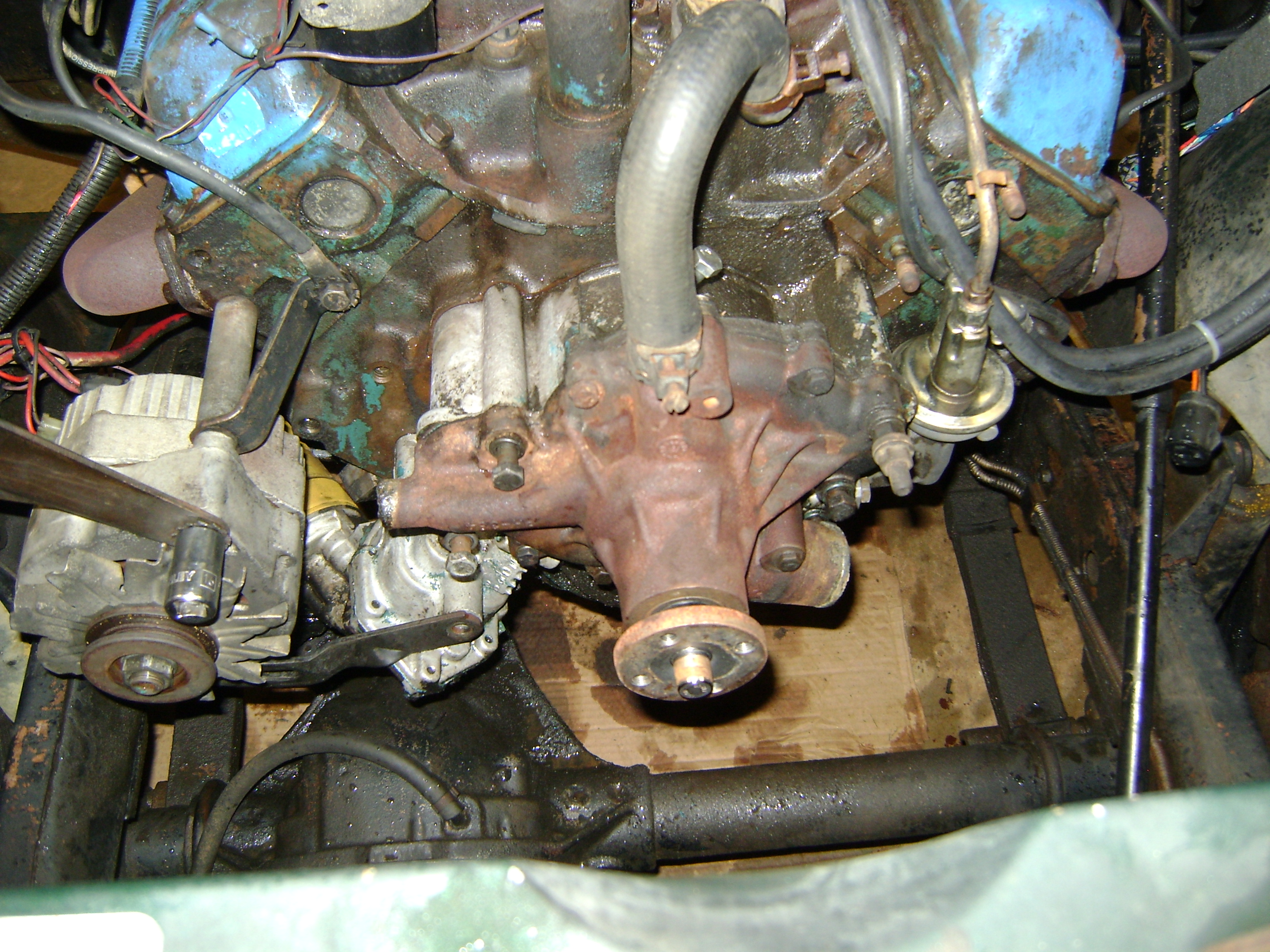

The loping problem got worse. The timing chain is shot. My new engine will be ready in three weeks. SO.

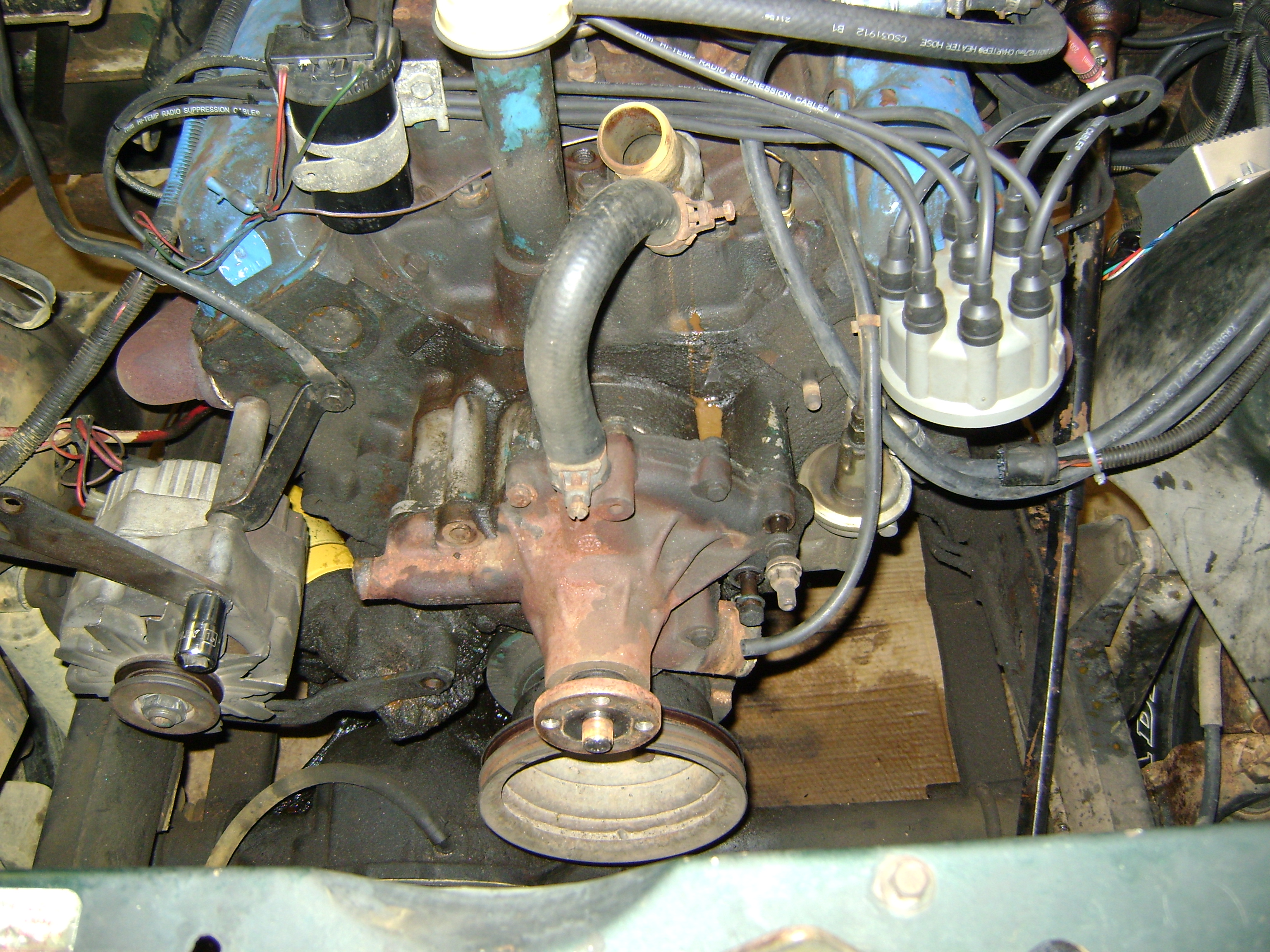

Pulled the radiator. Got the front of my motor stripped off. ready to pull the harmonic balancer. Got my new timing chain, and gears on the way.

It's amazing how much better it looks. A little red devil lie, and a good pressure washer.
I'm going to let it dry for a little, then pull the cover off.

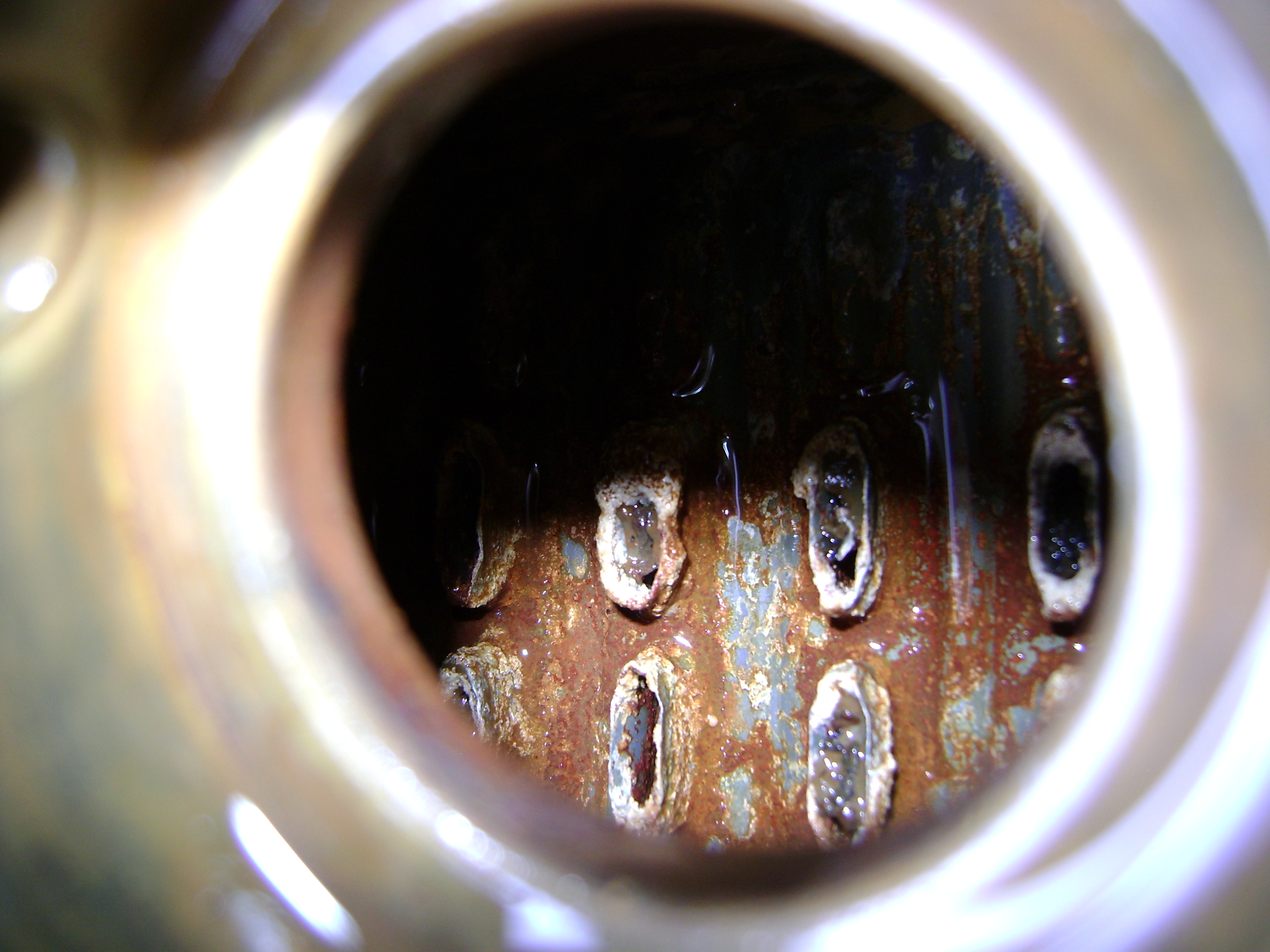

Kinda disappointed, my Jeep has belonged to two good mechanics, and the radiator is clogged from minerals in the water. I am sure they know better.
I guess I'll spend the rest of my day boiling out the radiator. Ah, chemistry at work. I hope it doesn't start leaking after this.

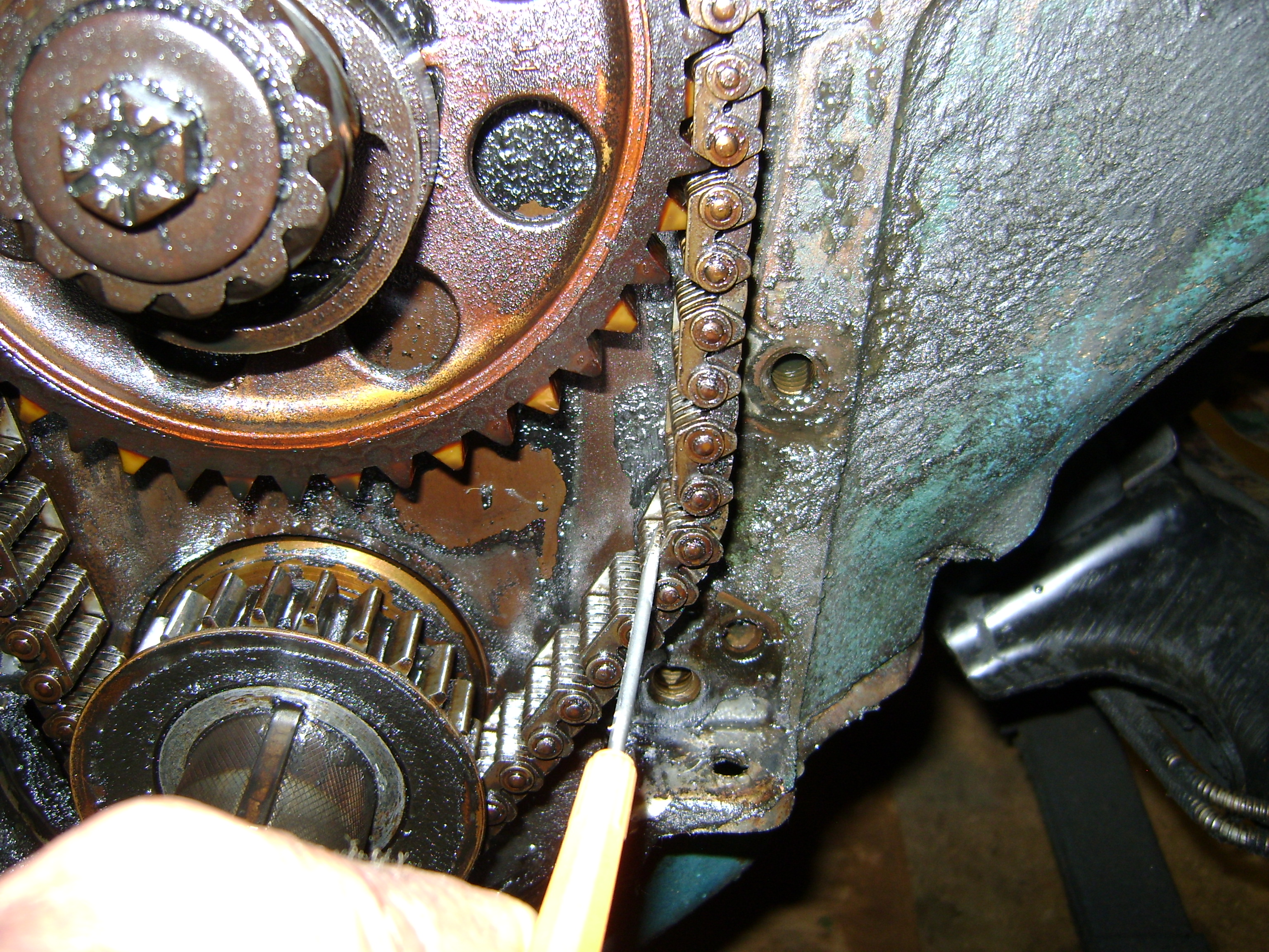

Well there's your problem. I'm surprised I didn't hear it slapping the cover.
Looks like I need to pull a link out. Just kidding, I should remove two.
Whoa dude ! Looks like you got a LITTLE bit of slack in that chain. REAL close to jumping timing. I believe that usually it's the nylon gear teeth that wear so much that causes it. Nylon is supposed to run quiet and seems to have become popular in a lot of engines back then. Replacements are cast steel upper gear but I've always wondered how many miles you get from them. As far as the radiator , it seems some mechanics take better care of customers cars better than their own. I tend to get like that sometimes and I'm not even a mechanic by trade . Got my degree in wrenching curbside as opposed to classroom. That pic of your 304 is bringing back memories of my old '78 cherokee 360 . Yeah I know , should have kept it. What was I thinking . I loved that truck to !

Boiled my radiator with some sodium hydroxide, looks much better.
Cleaned the corners of the radiator, and mounting brackets, "the radiator was hanging by the hoses".
Got it ready to silver solder back together.

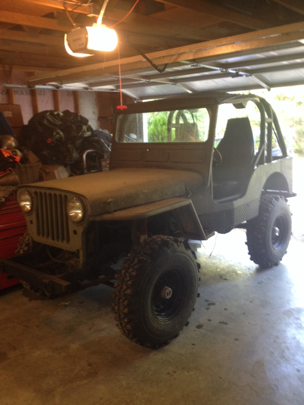

I pushed mine into the garage to un-hack everything the last owner did to it. Man do I have my work cut out for me. House wiring, crappy welds, wires running thru firewall with no grommets, oil leaks...... Might be years before I'm happy enough to let you guys see me roll it over on the trail.

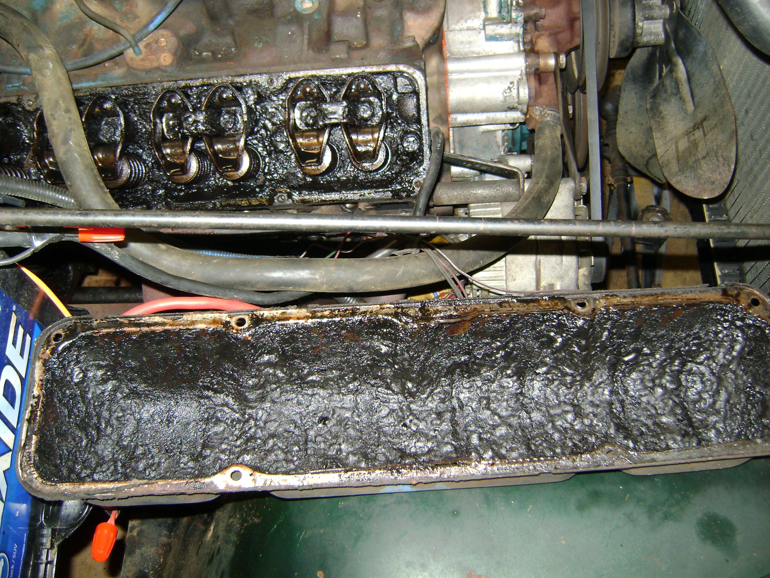

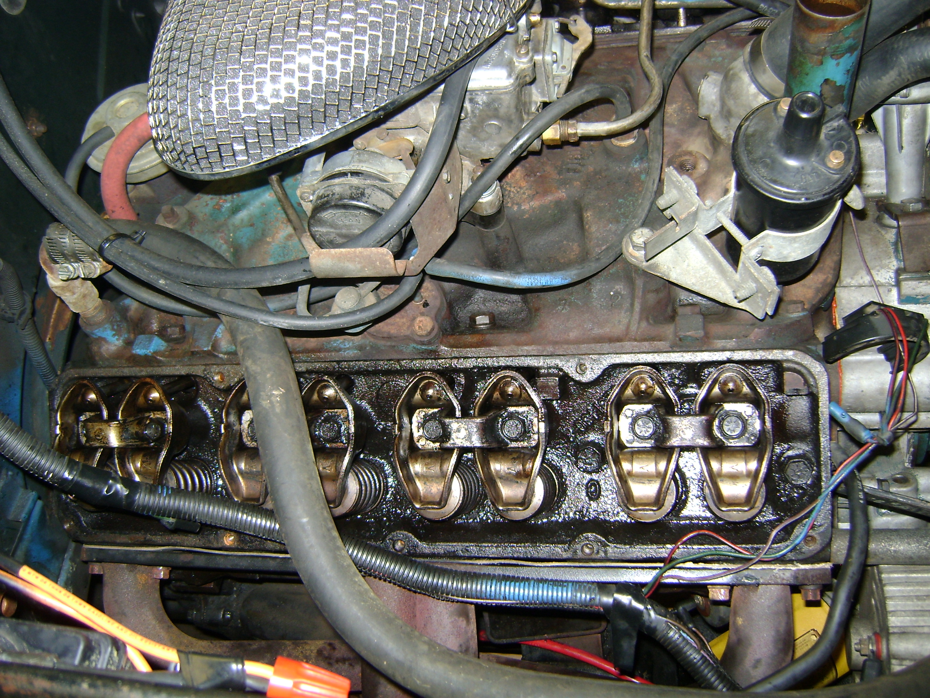

Well I decided I would inspect the rockers. Here is a picture of what I found.
Glad I have a good pressure washer. I pulled the oil pan, and laid too it.
I feel like I have been run over, but I sure looks better.
Got it back together, and it still runs, and no oil leaks.
