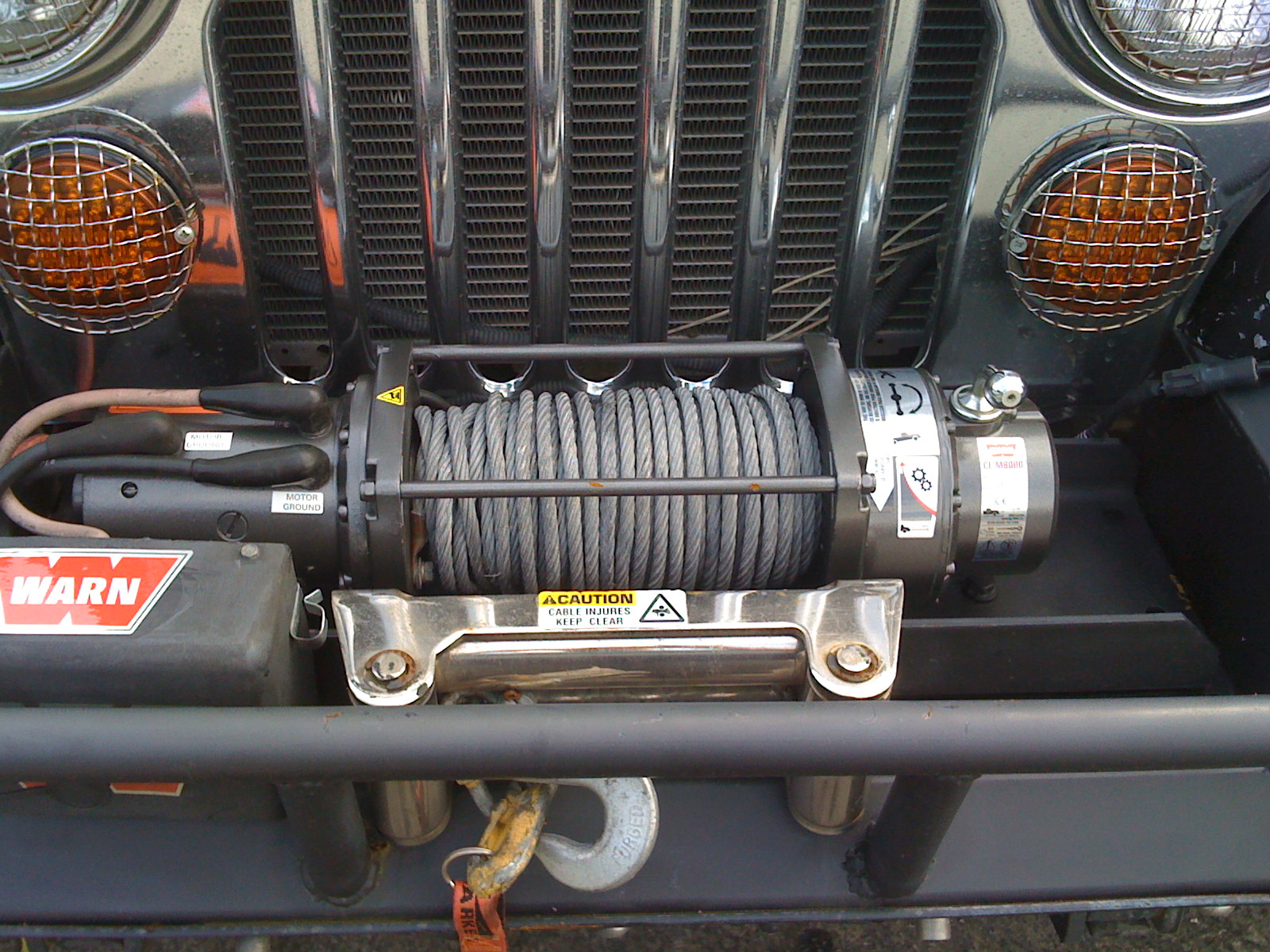

Warn fan here as well. Had it for years and has pulled cars out of ditches, trucks and Jeeps out of mudpits and pulled a lot of tree stumps out. Still works like a champ. I recently refurbished it and thanks to the Warn support staff, they provided me with the decals free of charge.
