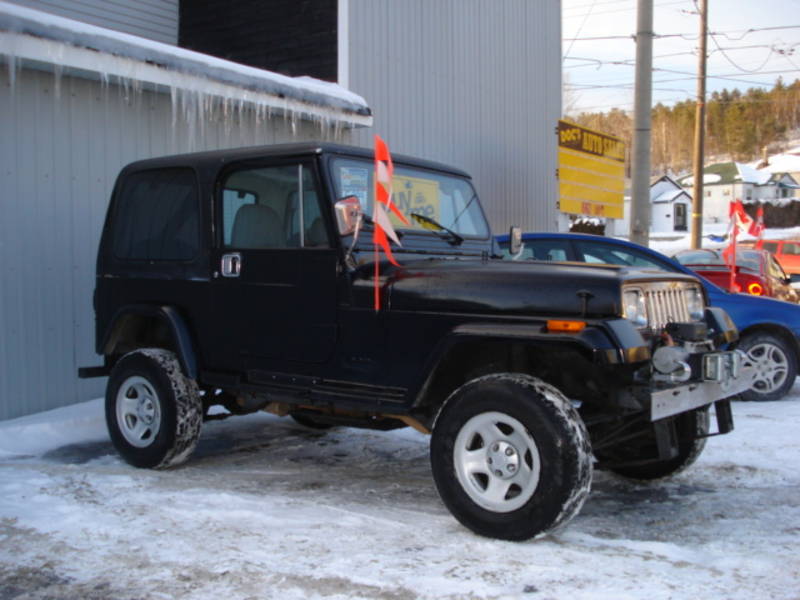

1988 YJ
Rebuilt with 128,000KM (79 500 miles)...new transmission, new body mounts, new winch, new exhaust, hard/soft top, and paint job. It's got a manual transmission, which I don't know how to drive, but I'm told it's pretty easy. He wants $5K, and it looks sharp. The square headlights don't bother me one bit; after seeing this Jeep, I almost prefer them! I would have to get a lift kit for sure, and bulkier tires. (I included a pic of this one for you guys to see)

IMO the Rubicon package is not worth the extra money. I know there are those who think it is and that is their opinion which is fine. I think the price on the YJ is rather high, and the shackle lift sucks. A few years ago I bought my 98 TJ sahara 4.0, 5 spd, no top or doors at all for $3500 and drove it home. So I would either low ball the YJ or keep looking for a better deal through a private party. The way I look at buying used vehicles is you have a 50% chance a private party is lying about the condition. You know for %100 that the dealer is always lying to you.

I just went and had a look at the YJ just now, the interior needs a bit of TLC, but the body is in great shape. I didn't really get a good look at the undercarriage, but underneath the wheel wells it looks fairly good. Noticed a big pipe coming out the back end, too, lol...Probably sounds nice.

Before I go any further, if you look at the YJ again before buying make sure you climb under it and inspect every little nook and cranny for rust. I've seen YJ with a showroom-quality body that were literally falling apart in the frame. Don't worry about a little bit of exterior rust on drivetrain components, this is normal, and they can be repainted with a clicker-can for next to nothing anyways.
That being said ... I would personally go for the YJ, but I'm a bit biased. I just love those square headlights :D I also love the way the dashboard is designed; it's blocky and rugged. But that's just me. Besides, you've got to have a manual. They're just so much more fun to drive.
One detractor from the YJ for me is that it is an '88 model. If I had a choice I'd rather one closer to '95. Many people say that '95 is the best YJ year to have, and I have to agree, having one myself.
Another detractor is that it already has lots of wrench-time on it. Don't get me wrong, I bought my YJ with mods. But... to quote Han Solo... I've made a lot of special modifications myself. Part of the fun of having a Jeep is adding/changing stuff yourself and making it your own.
On the flip side, the rebuilt motor is a big plus, so long as it runs good and was done right. New transmission is another big plus. New exhaust, body mounts, paint job? That's just epic icing on the cake.
The fact that it comes with both soft AND hard top would be a big plus for me. Those hard tops sure do come in handy in the winter. I'd try to talk him down to $3500. If he won't take that, try $4000. And if he won't take that, I would probably give him the $5000 he's asking for it. To me, that YJ seems like it's a decent deal.

I'm still a bit torn between the 03 Rubi and the YJ. If I was more mechanically oriented, I think the YJ would be a no-brainer, especially if I can talk the guy down to $3500 or so.
I know for a fact that the YJ has been sitting in a yard for about 6-8 months now (4 of which are winter)...Is that going to be a serious problem?
It shouldn't be. Make sure it cranks up and runs/drives well before buying, of course. But if it cranks up and runs good, it's probably fine. If you do buy it, change out the fluids (engine oil, engine coolant, transmission oil, refill the tank with fresh fuel) as soon as you can. It also might not be a bad idea to get some fuel and oil additives and use them. But otherwise, it should be fine.
